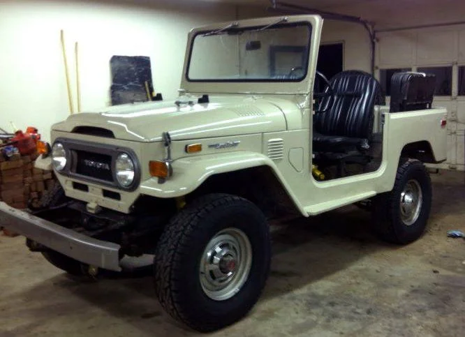

considering adding some extra lights just not sure what kind to buy or how to mount them would like to see some pictures for ideas
ps. sorry i dont know why the picture is upside down

Get a free program called "GIMP" to edit your pictures. I flipped, cropped, used auto-levels and changed the color balance a little to offset the effect of the fluorescent lights.
Thanks I appreciate all the input and thanks for flipping my picture upright. My FJ is a bit of a work in progress I just recently put the new tires on it and old man emu springs love driving it but just want some more light haha
