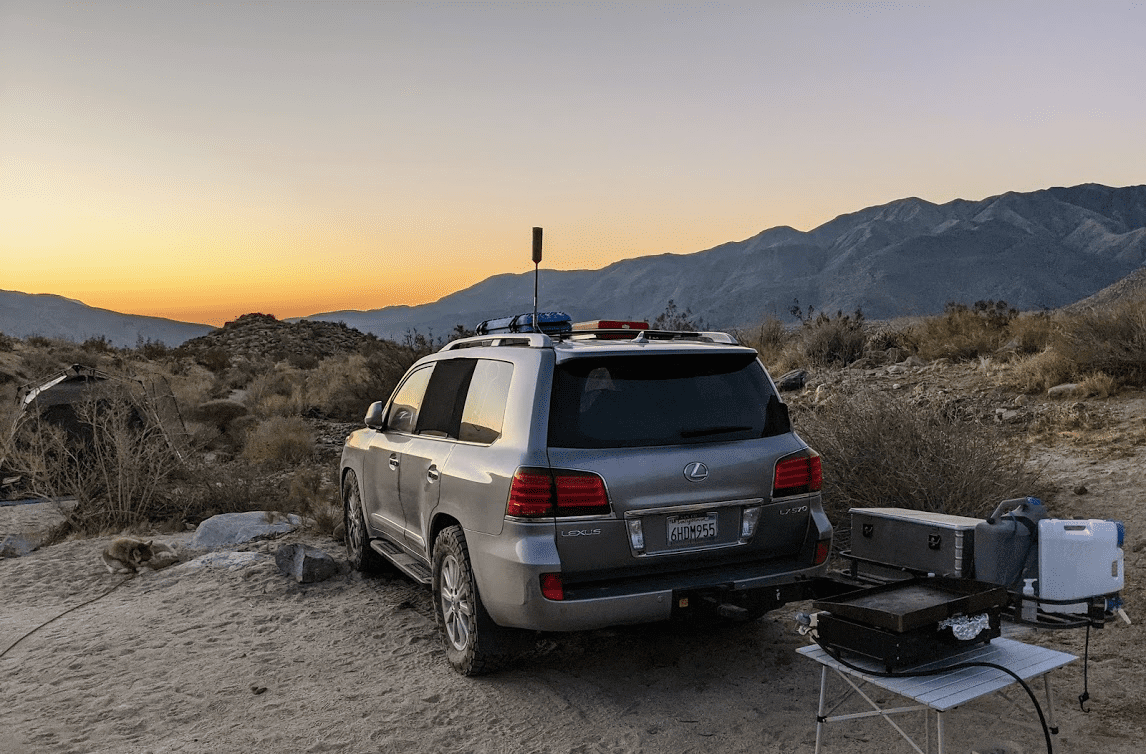

Leveling working out great to get that last fine adjustment. Slammed AHC in low for ease of access and aired up the right rear to about 40psi for about 2". The flexibility of the suspension is awesome, and it's always worth the extra bit of effort to level out the car for sleeping comfort. In contrast, friends were stacking RV legos and rocks, and of course giving me a good ribbing about the robot car that just dropped itself 4" and is level with a quickness. Lucky for them I had dinner responsibilities that night, and with a gang of hungry kids, I got to cooking while they continued setting up before sundown.

I know this is a while back, but in this photo were you able to drop the tailgate and raise the liftgate with the yakima and carrier swung out like that?
