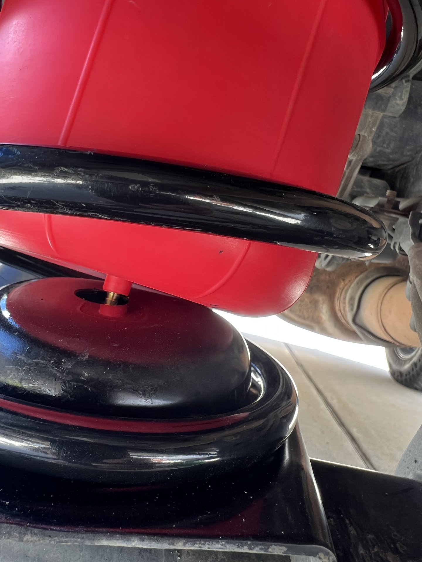

@TeCKis300 i drilled out the existing holes to 3/4” using a step bit, but just realized that the air valves don’t line up perfectly. Did you do anything to center the holes or everything will sort out once I lower the rig and air up the bags?

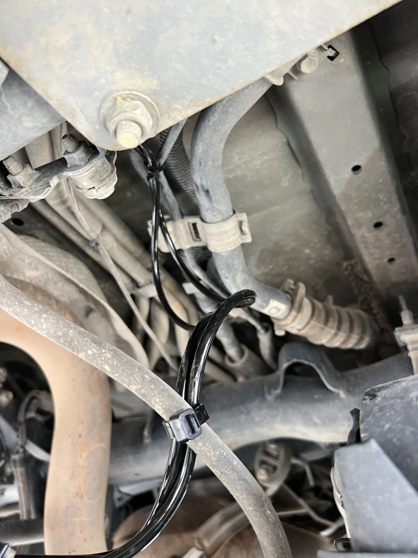

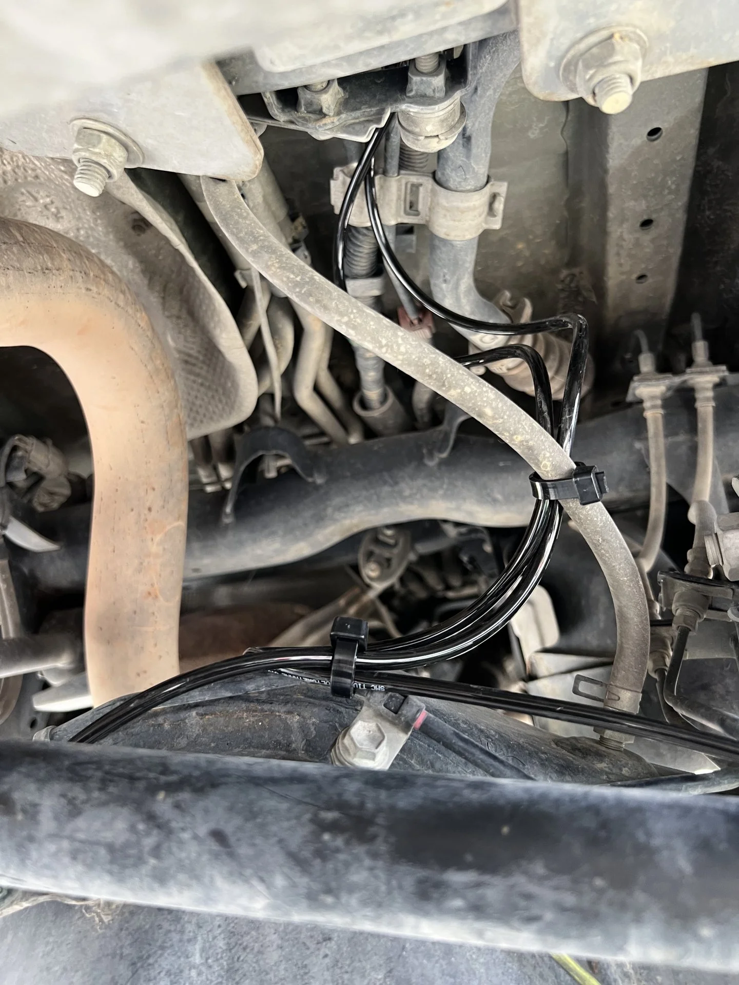

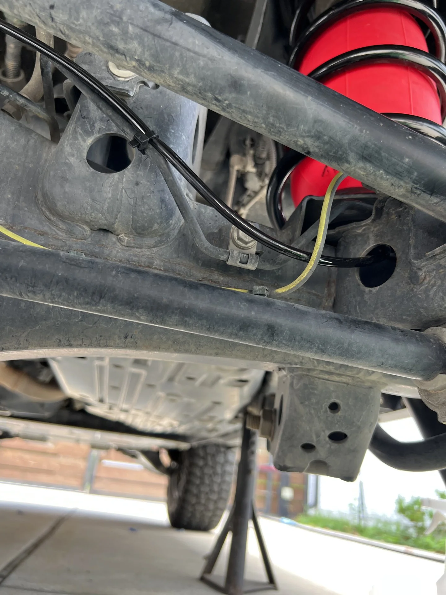

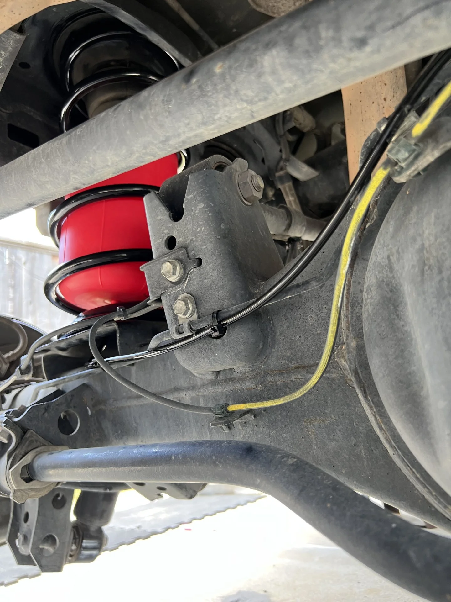

Also, do you have any pics of your air lines? I’m looking for a route to move from the axle to the frame, but it looks like I need to run up on the shock side to get a clean run. Or did you run up on the panhard side?
I used the brake line and was able to fish the air lines above my LRA. Now I just need to gen everything back together and figure out how much slack I need.

Late reply as I'm out camping. I actually routed it upwards which is just okay as I've had it pinch the lines a couple times. Curious how the downward routing will go.
I think I need taller bags now and never drop under 5psi to keep the bags centered.

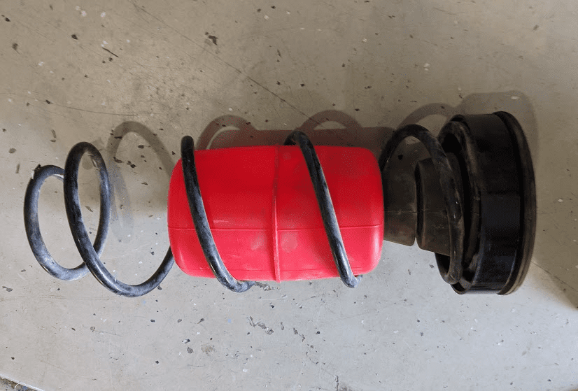

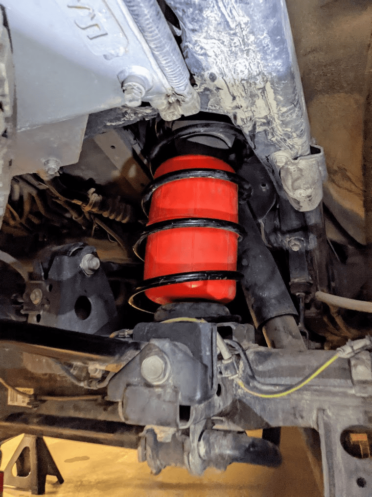

As I installed this more as an experiment, I wanted to minimize mods that were done to the vehicle. The airbags I'm using is Air Lift 60728, meant for the 100-series. I believe they are shorter in free length than what is normally spec'd for the 200-series. Diameter fits correctly in the coil. Shorter works to my advantage IMO.
I didn't cut the stock jounce limiter aggressively, and only took one segment off (of 4). Fully installed, this shorter bag still has 1/2" free length clearance as full droop per the installation guide.
Here's the stack up. Note I also have a 30mm spacer at the top to augment AHC for weight and sensor lift, so I'm not reliant on the airbags at all. They are supplementary which is the way I want them as airbags can have limitations for full articulation, both in compression and extension.

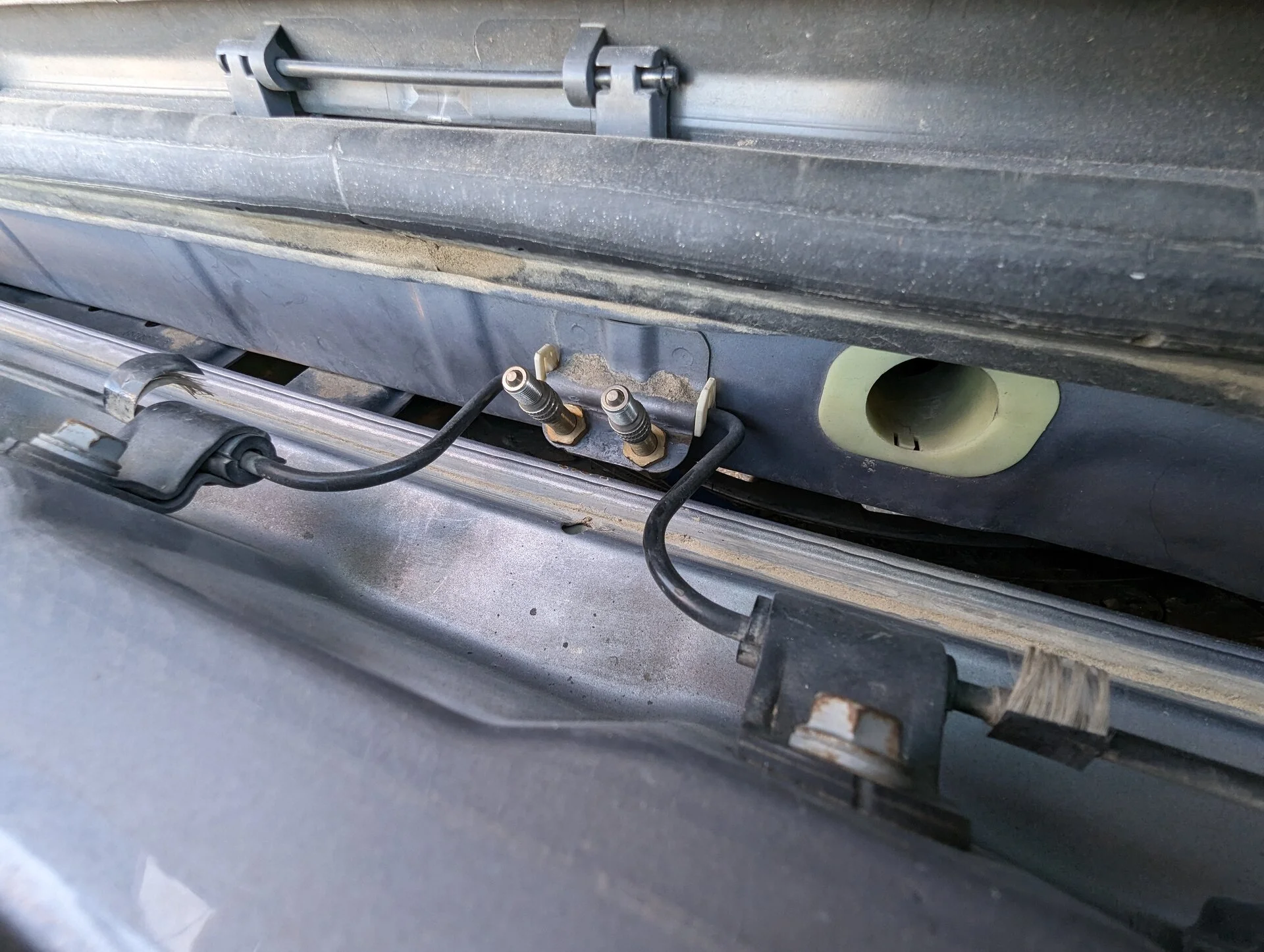

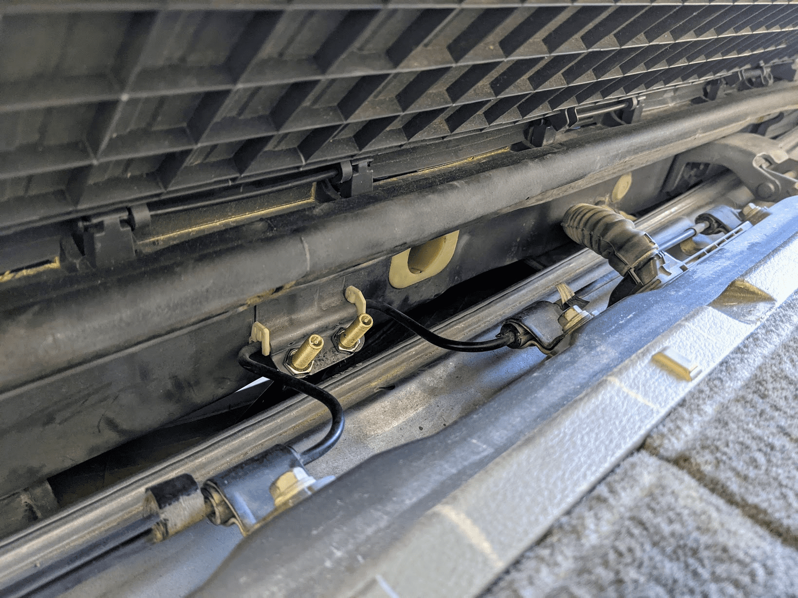

Here's where I ran the airlines. There's a convenient bracket for the tailgate torsion bar (LX only) that already has to available holes. I believe this bracket also exists for the LC? Bent the bracket down a bit to have a better angle to fill. And enlarge the hole just a tad with a stepped bit and the Schrader valves fit nicely.

did you route air lines down this time?
Still went upwards as that had been working for me. Other than the one time with the old bags that were too short, and I let all the air out, causing excess line to pull down and get pinched. Which is why I switched.
How's down working for you?
loving the bags and the ability to add air for towing!

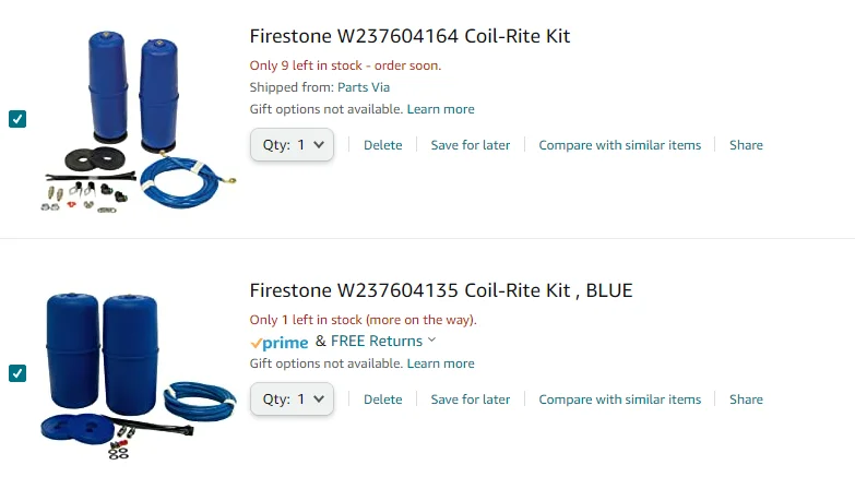

So, those who have bought the 200 specific bags, going on Firestone's website, they have a 08-12(W237604164 (also says Infinity QX80, all 200's and Sequoia) vs a 13-18 set (PN W237604135 (also says some 4Runner and FJC)
So now i'm curious on what to actually put on my LX 2014. It appears that it's shorter/ wider if the pics are true. Unfortunatly doesn't show any sizing on the website...
For anybody else wondering... The "13-18 set (PN W237604135 (also says some 4Runner and FJC)" set does NOT fit...
The "08-12(W237604164 (also says Infinity QX80, all 200's and Sequoia) " probably fits all era 200s, definitely fits my 2014.
