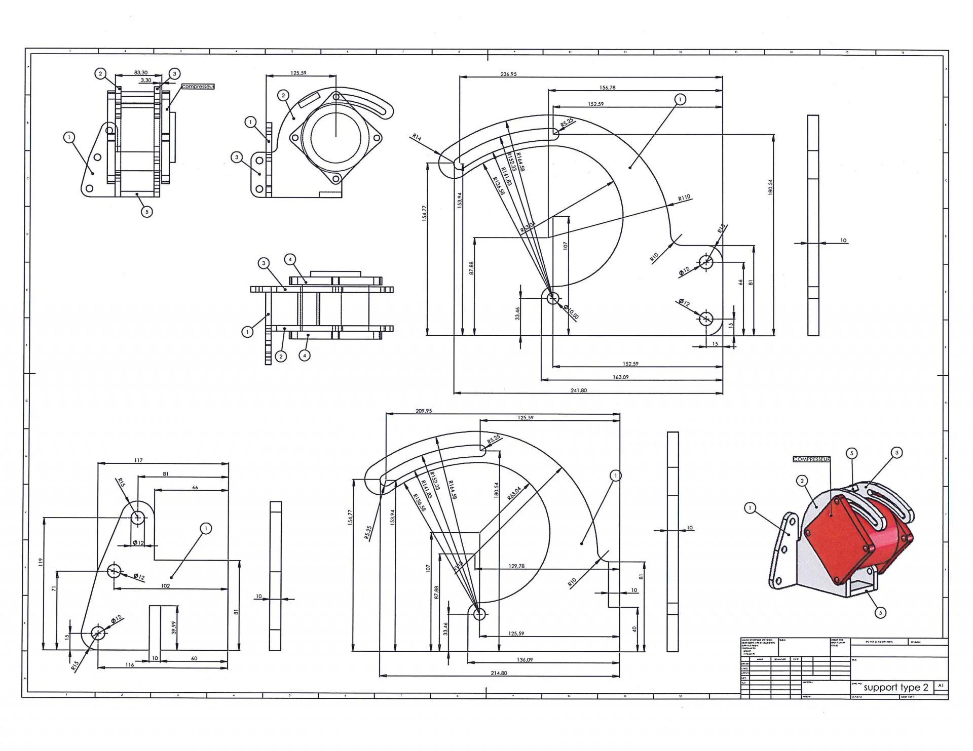

Hello KevsDiesel...looking at your post of FEB...I'm planning to install on my BJ40 (B engine)...a Air conditioner (bought the Vintage set) and Power steering (bought the saginaw conversion kit).....I already have the 3 pulley set (original) but Im still looking for a solution for the brackets (AC and PS)......almost all are made to fit the FJ not the diesel BJ. The picture of the bracket in this thread look very nice......Any news regarding the blueprints or dimensions ?? any help will appreciate.......thanks in advance ....greatings from Panama !!!
Hey Luis, sorry, no man. I have not continued on that project for a while and have not heard from anyone about the CAD files for the brackets unfortunately. Good luck!
After a couple of hours in the internet !!!!
After a several hours in the internet , I found the PDF file of the blueprints for the bracket... but I do not know how to post a file in here....I will try to send it to you by PM
Wow, that's awesome. I'll send you my email in a PM!
That's a nice alternative to the OEM bracket & idler pulley. Thanks for posting it up.

Hey KevsDieselLC, Did you ever find the CAD drawing for the 3B AC bracket? CanCrusher never responded to me did you have any luck?
Just back to Mud after an extended hiatus, sorry to have neglected enquiries. For some reason I haven’t received any notifications until this last effort by AWhelen.
I sold the last of the extra brackets I had made almost right away. Although I thought I had saved my CAD files on a CD it seems to have disappeared! A change in computers has resulted in the loss of my original drawings.
The drawings posted by Montie appear to be a much improved modification on the dimensioned drawing that I had located on the internet and used for my brackets. The addition of the belt tensioner is far more sophisticated than the brace that I used. Having said that the brace has never been problematic.
It would appear that this is meant to mount directly on the face of the bosses on the front of the block. That was the source of a slight alignment issue. The solution was to cut the “arms”, overlap them by 1” to move the compressor forward by the thickness of the 3/8 plate and bring it closer to the block.
Because I don’t have my original drawings at hand I can’t say if Montie’s drawings have taken into account the alignment issue.
Hope this isn’t too late to be a help. I will try to be more diligent watching posts. I had actually thrown an ad up for my Cruise late last Fall but as the weather turned and our winter travel plans came into action I even failed to check on the ad (truthfully, I am torn about selling the old girl....my wife says we are “joined at the hip”).
Thanks for the info. I'm building a mount for a second alternator, so I should be able to get all the dimensions i need from Montie's drawing.

My transplant of a 3B into an FJ chassis gave me the opportunity to add AC to my 60 series. I found dimensioned drawings for the bracket as shown on the internet. Worked up a CAD file and had brackets laser cut.
The drive pulley is from a 3B with AC (acquired from 4Wheel Auto in Edmonton), it fits between the existing pulleys in place of the spacer you will find there. There is an idler pulley much the same as the PS idler that fits on the right side of the block but I didn't have any luck locating one so I simply ran a brace to one of the top bolts on the compressor (sorry, not installed in the picture).
A standard automotive V-Belt (15450) worked for the drive. An alignment issue arose during the install, if you are considering this option I can expand in more detail.
