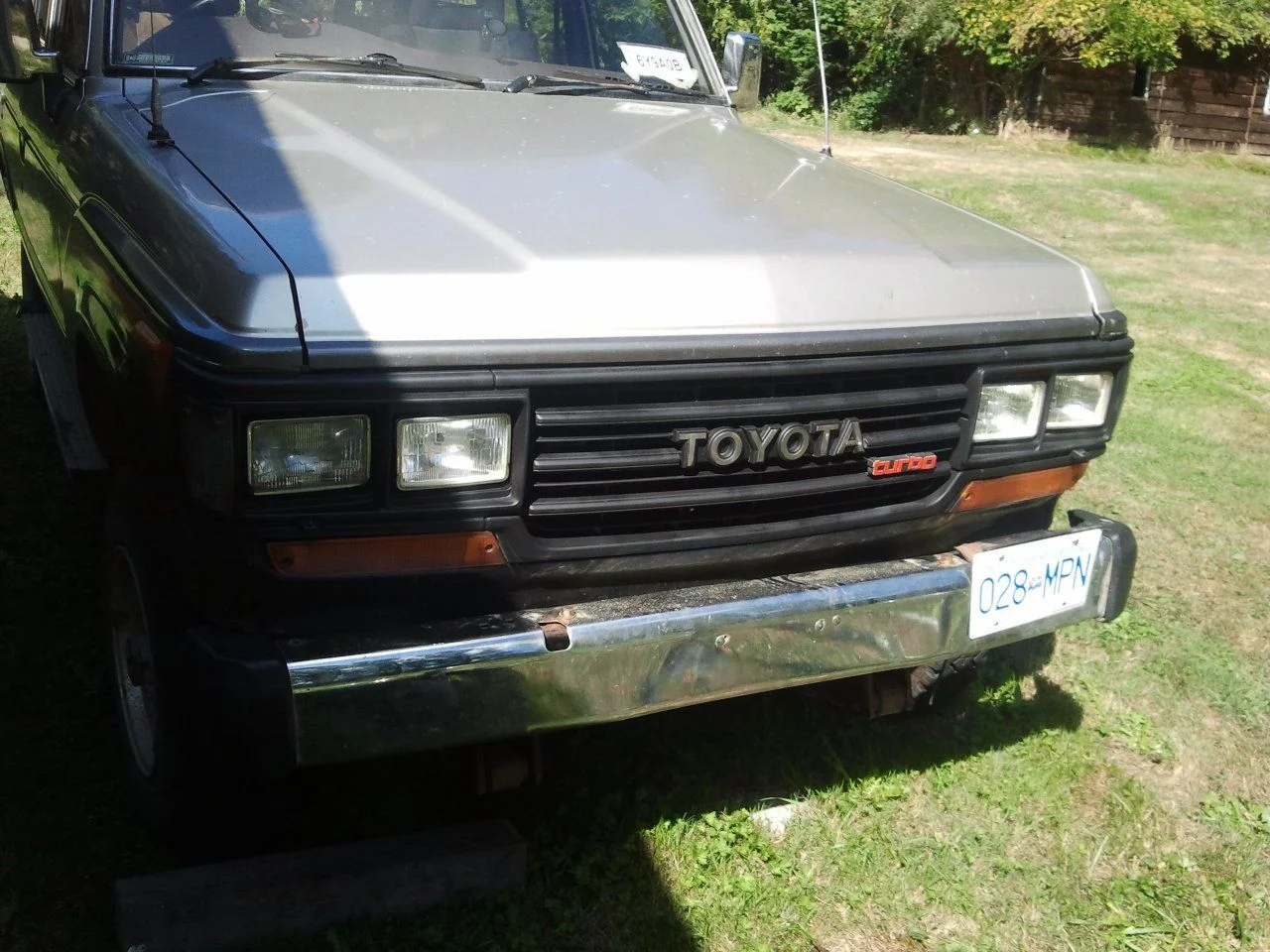

Sans front porch, and the grill was all peely and s***ty so I just hosed it down with some flat black.
And being newly plated, I took it for a test burn. Vastly improved...no rear end clonks, and no death wobbly steering.

Crap, that looks so much better with a normal bumper. Glad to hear the rear end is better now. Can you feel the LSD working at all? Out of curiosity, what is the diff code (from the under hood ID plate)?
I forget, k084, k085? Translates to 411 lsd anyways.
And yeah, I can sorta feel it. Tight corners are a little more lurchy than with a totally open diff. definitely felt it engage when it was still loose...felt like a sacked old lockrite. Kinda surprised at how much smoother it is. Way easier to shift the truck without a 1/4 turn of driveline slop.
I'll get around to building a couple proper bumpers for it at some point. Next is a set of tires and then I'll see if I can avoid spending money for a while...:bang: :lol:

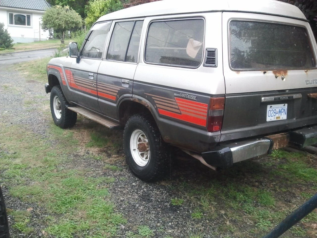

Bit of a 4 steps forward, .5 back day today...I'll take it as a net gain.
I picked up some 31" at's, and had them mounted on some white steelies...turns out, one rim is kinda bent, and the weights they put on would have made a mess of things up front if I hadn't noticed them interfering before dropping the truck. Meh.
Took the inner weights off up front, and they do clear, but I'll be looking for a set of stock cruiser rims. Still drives 100% better than it did on the scary old yoko onos (the resemblance is quite remarkable...old ,dry, cracked, skinny, awful noises).
No vibes even without the weights. So, all in all, Meh.
Interesting to see how much closer the speedo is now tho.
