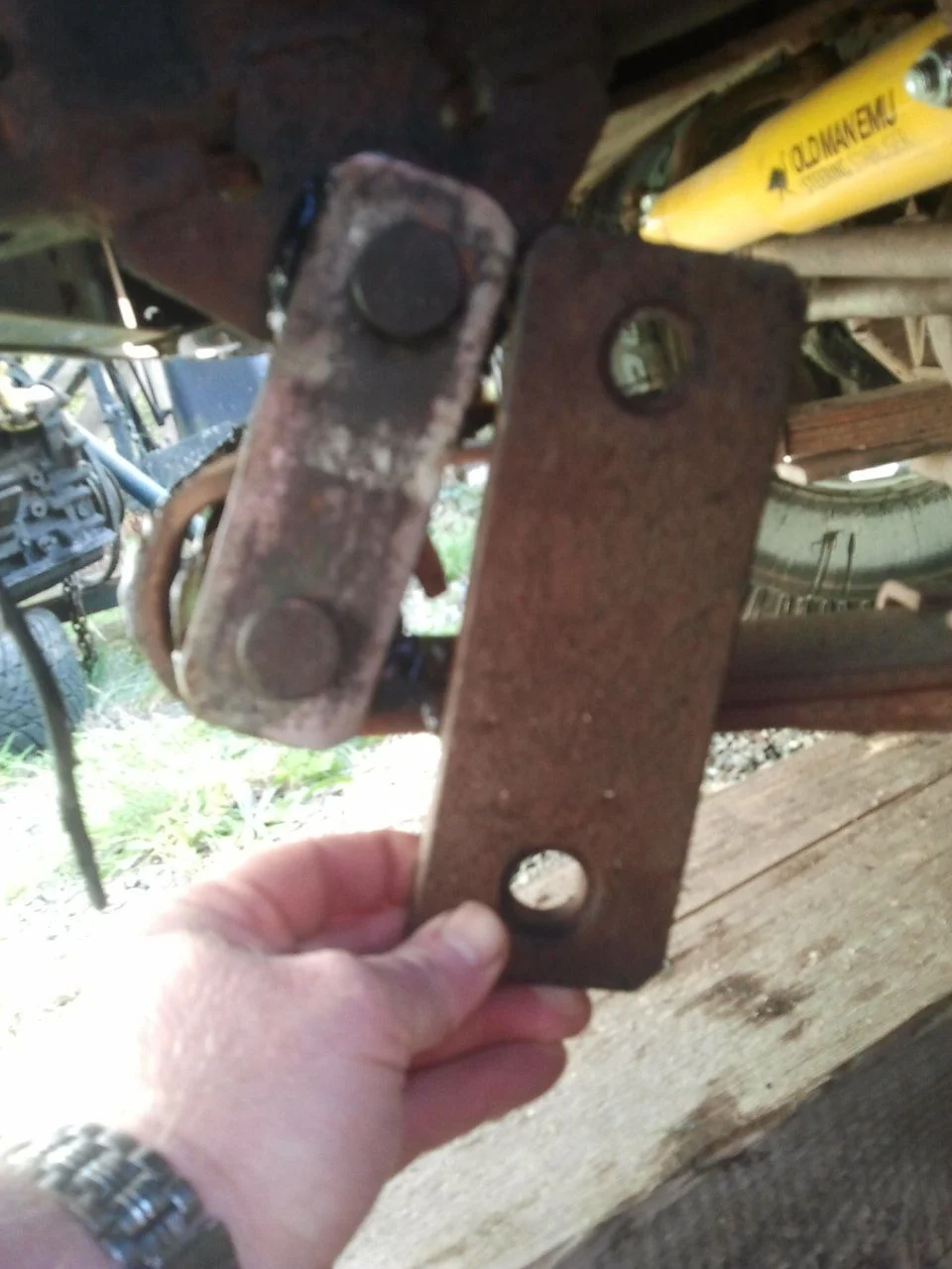

This morning I got to eradicate something that pisses me off. Long shackles are so fxxxing stupid it makes me want to bang my head against a wall. (also the effect they have on your suspension.)
These things offend me by their very existence, and basically are like posting a big fxxxing sign saying that you are too stupid to understand geometry.
So now, I have a front suspension that actually is able to function, my steering wheel rotated 1/4 turn, and I don't have bump steer.
Almost as worthy of the
is the fact that they took the time to machine the plates to countersink the shackle pins, but didn't do anything about the bloody great square corners...:bang:
The rears are almost as bad, but tail pipe is in the way, and I don't feel like re-doing the aft end of the exhaust just yet.
time for some wood dust and epoxy. :grinpimp:

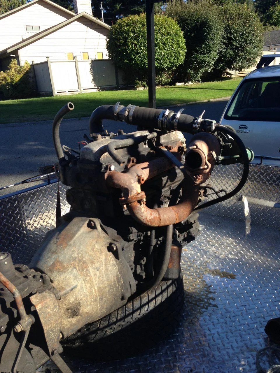

We stole Spuds motor when he was not looking today..;)
Going into the left hand drive BJ74..
Lots of cruiser leaning and swapping stories on the ranch...

Yeah. I saw you take that spy shot, you were in full on "yoga pants close up in grocery store lineup" uber-perv stealth mode when you took that.
For the record, there are few things more offensive to me than douchebags taking spyshots. :meh:
And yeah, good luck with that 3b. :flipoff2:
Gottcha, thought I saw you glancing at my camel toe..eyes up here big boy eyes up here...:hillbilly:
Looks like yur giving me a sea mens scowl, look of death I say..
Should have the motor in tomorrow if all goes well..:beer:
