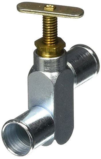

I'm going to replace the heater valve and also add a manual inline shut off valve to the heater hose and see how this works out.

Im going to install the inline shut off valve on the heater line since I already have a hose splice in place and, the 5.3 fitting on the water pump is ½" and the heater core fitting is ⅝".
Will see how it does...
I think I can survive without a heater during the summer months....

Frank, that NAPA valve does not look like the OE unit. May work, but the valve is still available from Toyota. I know you've got a conversion, but still using the stock valve ?
That heater core restrictor is a new one on me... But being in So. Cal ... AC way more necessary. :D
I looked at that very same valve, but again...
Having a valve that fits the dimensions on the heater hose splice that is already in place makes is much easier to replace....
