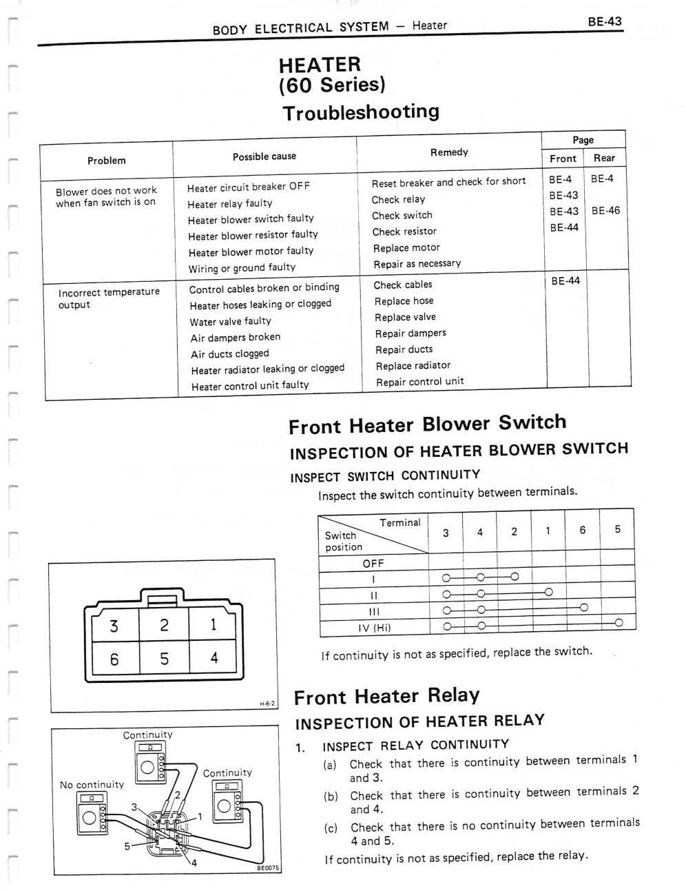

Things that cause voltage loss at the blower fan: the heater CB...they get old and don't really hold until 30amps. Current has to run thru them and they get weak. This is top right of the fuse panel. These can and will trip with the fan and AC on high if they get too worn. Pull and replace with a 30amp inline fuse and some flat spade terminals.
The blower resistor housed above the accelerator pedal and toward the middle of the dash. Unplug the harness and unscrew it. They get rusty because they live inside the vent. Tiny coiled wires to vary the resistance at different fan speeds. Aftermarket resistors are available.
Lastly the contacts on the slide switch at the instrument panel itself can get tarnished but pulling it to clean the tarnish is hardly worth the gain.
