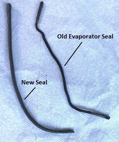

Todd the Evaporator is in a housing and already has a 'drain' that exits the firewall. I would first be sure that line is clear. It can be accessed from underneath the vehicle. IF it is plugged fully or partially then the condensation is backing up in the Evaporator housing.
IF that does not prove to be the issue then likely the seal in the bottom portion of the housing needs to be replaced.

Almost certain it's the seal. I just had a new evaporator put in. They used the old seal, which must have dried out with age so mine started leaking even though I knew the drain hole toward the front was clear. I sourced the new part and had the AC repair shop replace it. No more drips.

@flintknapper's suggestion is the first thing to check. Mine started dripping and since replacing the seal, no more leak.

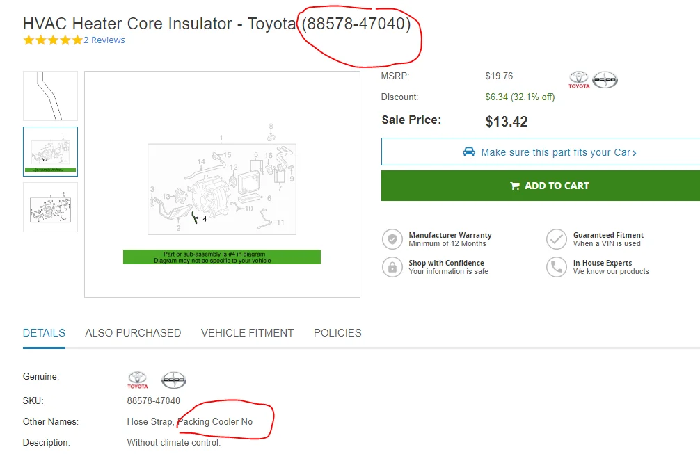

Google search shows this is for 2001-2008 LC. Does anyone know the part number for 1999 or will this work?

Just found this forum, I looked at the part number from the image above, but it says it won't fit my 2002 LR. Maybe I'm searching wrong, or something, but I've got a case of wet wife feet also. I don't think the drain is clogged, since I can see it draining after we stop.

Go to partsouq.com and put in your VIN. It'll pull up your exact model and you can find the part number there.

Yeah, I'm an idiot, that's a typo. Have a 2002 Land Cruiser 100. Thanks for the URL.
