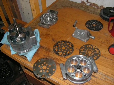

PICT0018.webp PICT0020.webp PICT0018.webp rebuild it save you some dollars I just rebuild my 93 and converted to the R134a

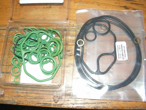

I rebuilt (resealed) my compressor several months ago and it has been working fine. It is a simple job. Hardest part was getting the compress off and cleaning it prior to dis-assembly. I got my parts from CenturyAutoAir. Here is a "How To" video:
Edit: the complete kit is KT-10PA-SYS, now showing to be $28
