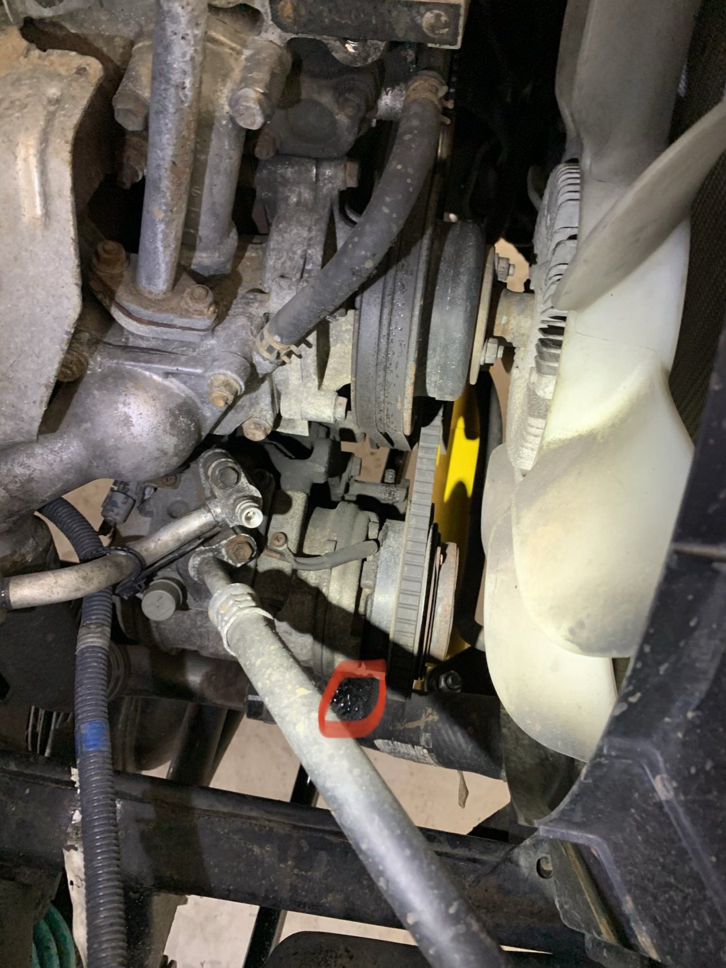

Some of you saw last week that my AC compressor died and also took out my Speedo fuse on the way down to vacation. Now it's time to begin another project. Can someone provide me with a list of parts you recommend that I buy, along with the compressor, so that I can just take care of any neighboring parts so I don't ever have to worry about messing with this thing for, hopefully, another 23 years? I saw a few threads that had some items while others had other items so I want to make sure I'm not missing anything when I order the parts. Btw in the pic you'll see where a leak is circled. Thanks in advance.

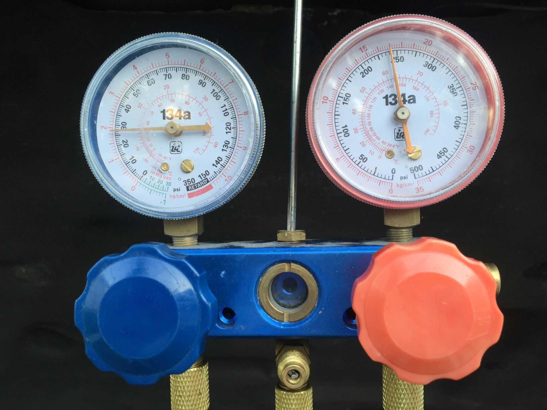

These are my actual Numbers from when I did mine.
DO NOT OPEN HIGH SIDE WHILE FILLING ELSE CAN BECOMES BOMB.
Pulling the box from underneath the dash for the expansion valve and evaporator core is also a good time to clean out all the leaves and crap that end up down there. There was a bunch of crap in mine.
You have to have a Gauge Set.
That's really close to my numbers afterwards as well.
