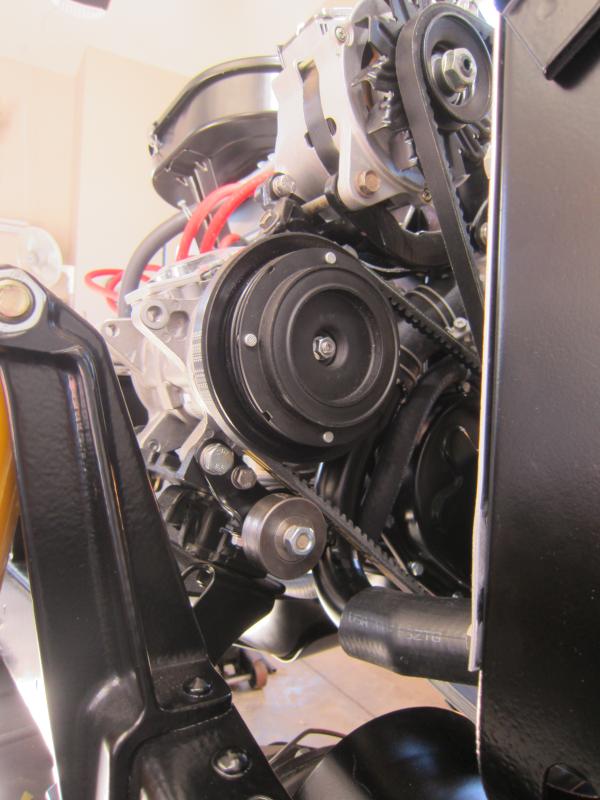

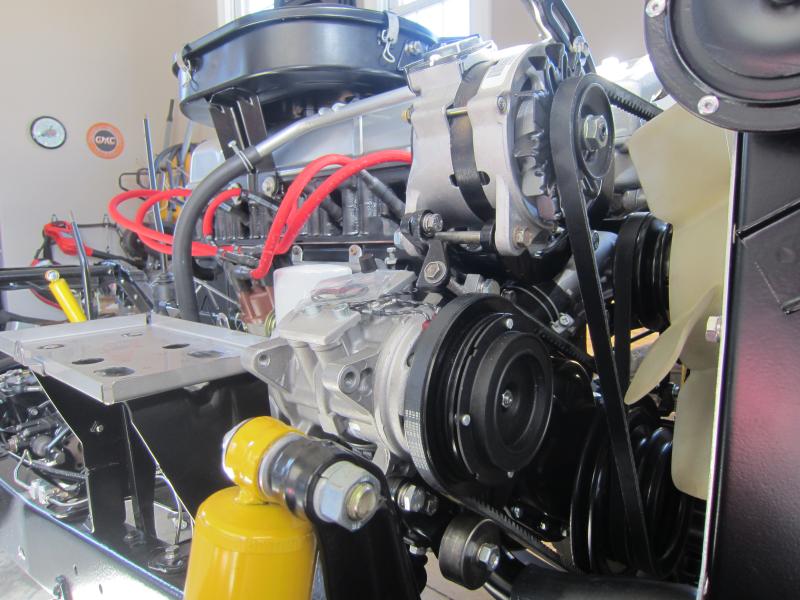

I used an FJ60 front right motor mount for the AC compressor along with a bracket to tension the belt that mounts to the bottom of the alternator bracket. Also had to use the lower radiator tube (steel part) from an FJ60 to clear under the belt for the AC comp. All installed on a 1980 FJ40.
The mount fits perfectly, just has the extra tabs to bolt on the AC compressor. I did have to move the battery tray back slightly. Not my truck in the pic, but you can see it here (just under the little fuel filter) I can post pics of mine later if it will help you.

I did install a 3 groove pulley from an FJ60. You can see the difference in the pulley size in the first pic in post #9. AC is only thing on the pulley closest to engine, that pulley is much larger than the other 2.
Speaking of pulleys, the alternator in Crump's pic has a corolla pulley for skinney belt. The Cruiser pulley is cast iron and wide enough to accommodate the 17mm belt. Easy to find used on any year of F/2F alternator.
