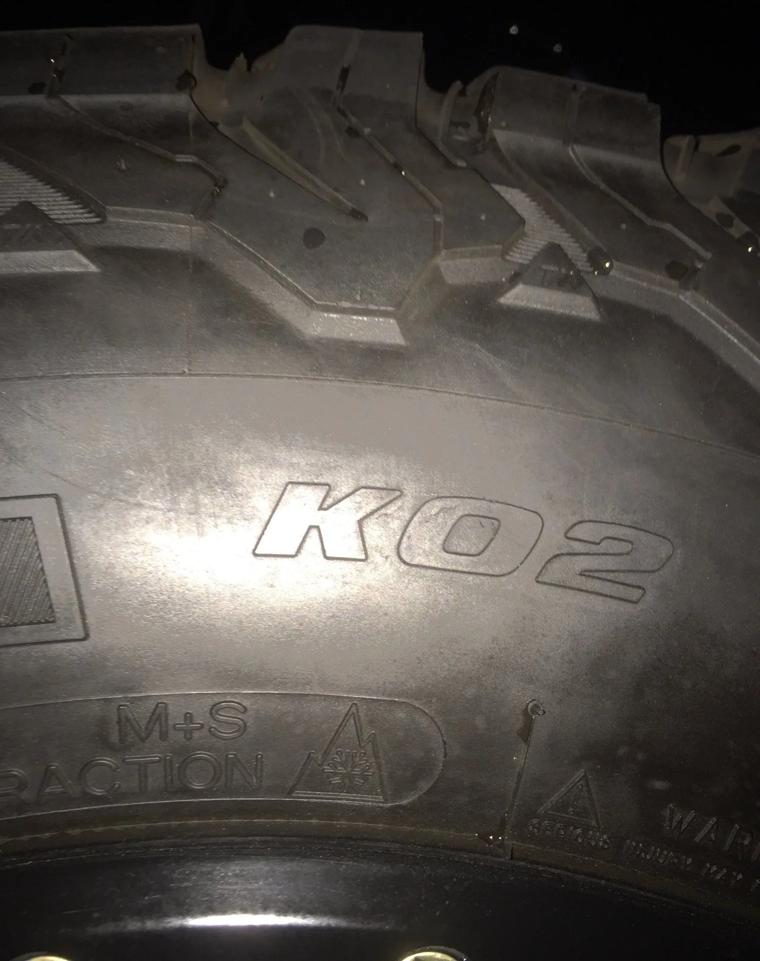

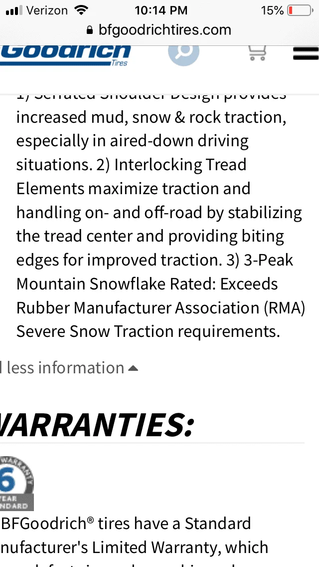

I'm also in the market for new tires and highly considering the KO2's, however just learned the brand new model has a different tread compound designed to improve wear and no longer has the snowflake symbol. I'm looking for a good year-round tire that can also handle snow. Not sure how legit the snowflake symbol rating really is, certainly won't be as good as a dedicated winter/snow tire, but the search continues.
Where did you hear about new tread compound?
The only one's in stock on TireRack note "Size: LT285/75R16; DT Different Tread, No 3PMSF". The two other model KO2's available in same size are either on back order or out of stock.
The description notes "All-Terrain T/A KO2 tires labeled "DT" utilize a different tread compound designed to improve wear in high-torque applications and improved chip and tear resistance in gravel. Tires featuring this compound carry a 50,000-Mile Treadwear Warranty and are NOT branded with the three-peak mountain snowflake symbol. They can be identified by the "DT" branding on the sidewall immediately following the service description, and are labeled on the Specs page and in search results."
Called TireRack and rep confirmed this. Also called BFG, but the guy was clueless.
States right on their website 3peak Mountain Snowflake rated-
All Terrain T/A KO2 All-Season Tire | BFGoodrich Tires
Mine are M&S and have the the 3Peak Snowflake symbol.
