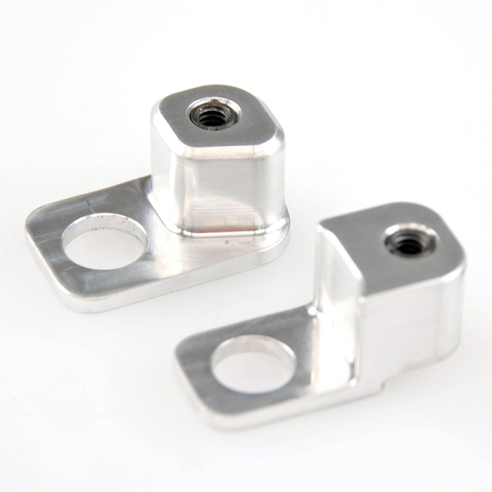

I know I'm not @FJ60Seth , but I just saw this:
& it intrigued me
