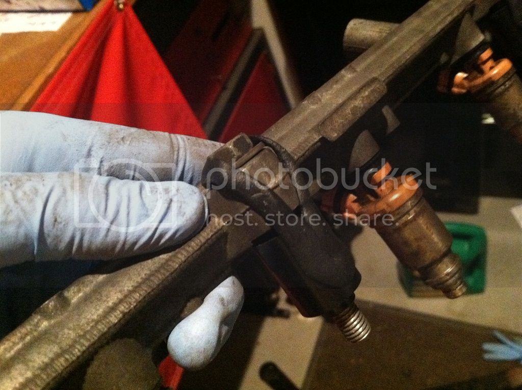

Here's how I got the fuel rail in with the spacers and bolts... it's something called 3M Sealant Caulk, and it's about the consistancy of bubble gum. I stretched it around, pressed it down and it held well enough for me to get everything lined up...
Once everything was in position, I used needle nose pliers to remove the "dum dum" and tightened 'em down. Good to go!

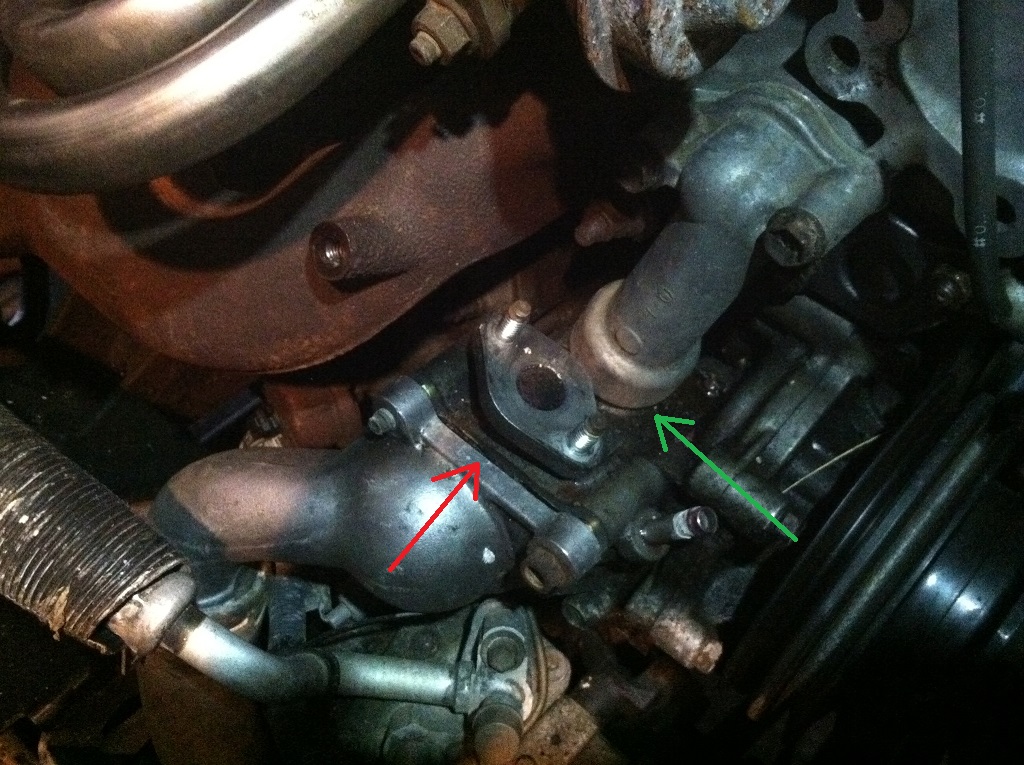

Looked under the hood and saw leaking from the hard pipe shown here with the green arrow
When I removed and reinstalled this... I noticed that the inside of the pipe was seriously degraded/pitted/etc. I did NOT remove the metal sleeve that goes between the pipe and the waterpump housing. It was so broken down that I was afraid removing the sleeve would break it. So I rolled the dice. And it's leaking.
So I just ordered a new pipe and sleeve from Beno.

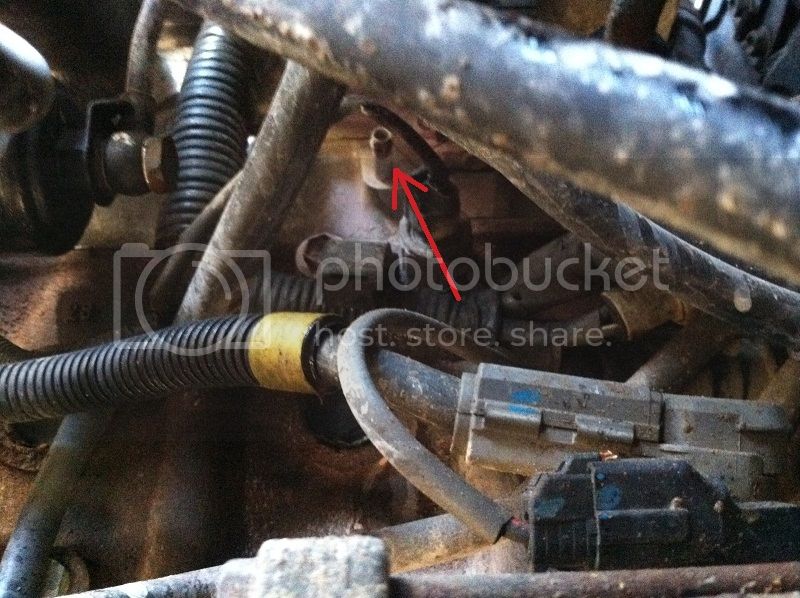

I'm doing better here... found a coolant line fitting that got missed. Hose goes from the head to the TB.
Found the hose mislabeled in my pile of leftovers
Now I'm just waiting on the hard pipe from the waterpump to the head from beno and that's a 10 min job.
