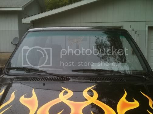

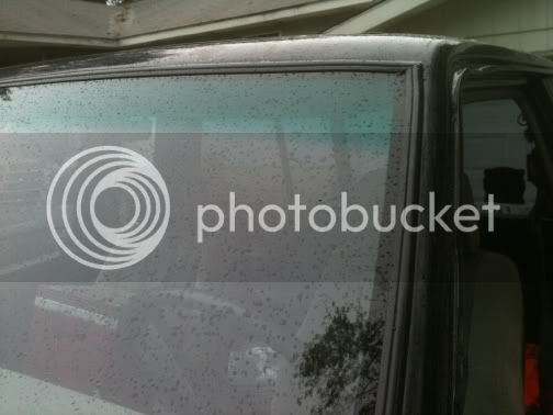

Just this week I got nailed with 1 1/2"-2" hail on my way home from work that took out the windshield.
The glass company that installed my winshield used a perimeter molding from an older Pontiac Grand Prix that fits well and looks good. The installer told me the windshield I had installed didn't bond to the urethane and he was able to push it out by hand. This was due to the lack of a black UV protection coating around the perimeter but also told me that the do make a special UV urethane that can be used on clear glass.
I will call the glass company for any further windshield needs and I need them in our Saturn and Suburban.

got any close up pics?
also any info / product names for the materials u were speaking of?

i installed mine by myself, using butyl tape, no suction cups, and i also pulled it from a parts truck i had here at the time. it does not leak. but i should have used the urethane caulk not the butyl tape.
Betaseal 16050N urethane adhesive made by Dow chemical.
http://www.dowautomotive.com/products/betaseal/16050n.htm
What rubber gasket did you use with the adhesive? Anything special?
Can you not get an OEM gasket w/o trim for that year? I bought one for my 1st gen 83 and it was available with or w/o the trim. I think the gasket is the same as the w/o the trim has a recessed area where it appears the trim should go.
The installer commented on how much better quality it was, compared to the aftermarket ones that they use.
