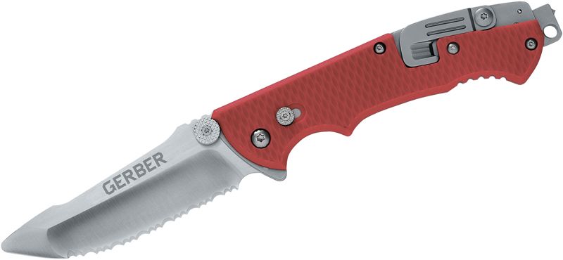

Carry a knife to free yourself if it does not release.
Doesn't everyone carry at least one already?
I have two of these in my truck at all times:
Gerber Hinderer - highly recommended, EMT tested and approved (by me ;))
HTH
