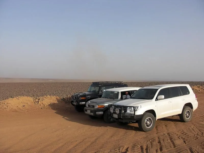

We drove out to a pretty cool location to test out our new mods. Had a 180L Long Ranger tank, TJM bullbar, and AT comp drawers installed, and wanted to test it on some nice washboard and talcium powerded tracks. The mods held up excellently for a 600km round trip, of which 200km was off-road.

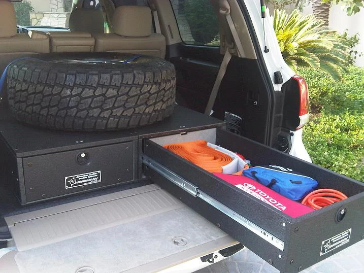

Very Nice! How are the AT drawers secured?
drawers
We took out the rear carpet, and placed three wooden 1" thick planks across, secured by marine grade silicon. Thats the base we used, then we bolted on the drawers to the wooden planks. I was reluctant to drill through the floor, as the sub fuel tank is under, and wasnt sure how much room we had to play with when drilling. The set up is rock solid, at least so far.

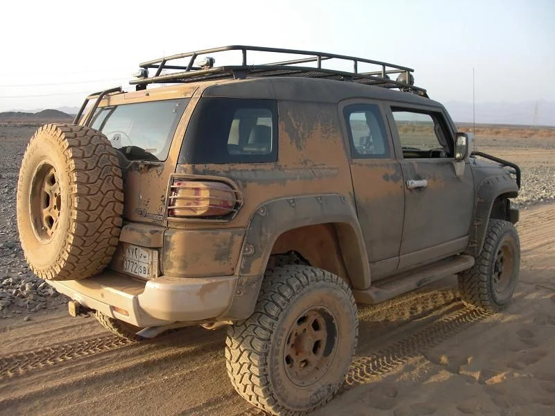

As for the FJ...its got a Fabtech 6" lift and runs 35" Micky Thompson ATs and 4.88 gears. Its awesome on the washboard stuff:clap:
