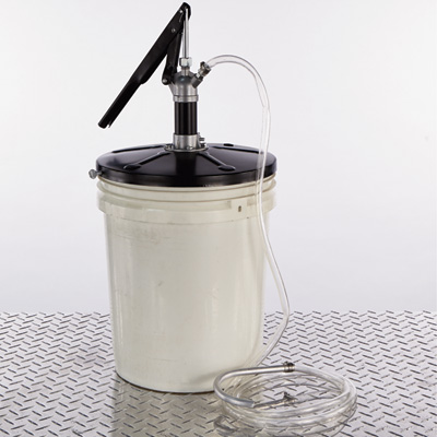

Well, if you made it this far, here is a picture. Enjoy.
