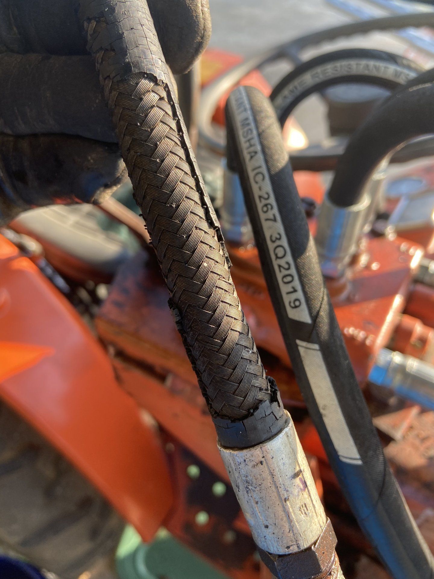

Lifted the bucket. Pinhole leak in high pressure hydraulic line :bang::bang::bang::bang::bang: Most are brittle. Ripped em all out to get new ones made at local hose shop. Mission creep.
On the tractor forums I keep reading that pinhole leaks in a tractor hydraulic system can shoot a fine stream with enough pressure to not only pierce skin but to do significant damage to bio forms like us. Glad your getting the leaks fixed.
Replaced. 13 hoses. Old ones were pretty bad. Local shop did a fantastic job. Good for another 15 years.
Took great care to number the old hoses and connections on Orange Peel. Hose company was nice enough to zip tie the existing hoses with the new counterparts. Made putting it back better.

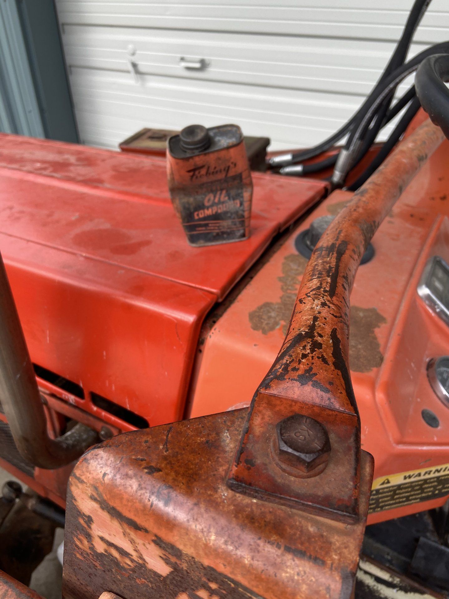

Baselined Orange Peel with new fluids and filters and fired it up. Kicked up instantly. Tightened a couple of loose fittings on the hydraulics and is good to go. One project done. 999,999 left. Progress. 😩. While mowing, I found an old oil can. Same color as Orange Peel.
