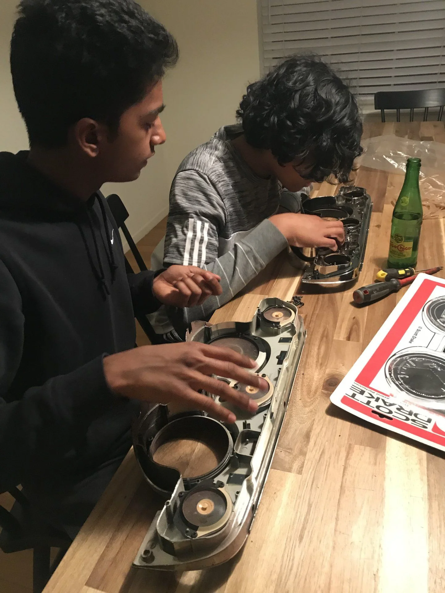

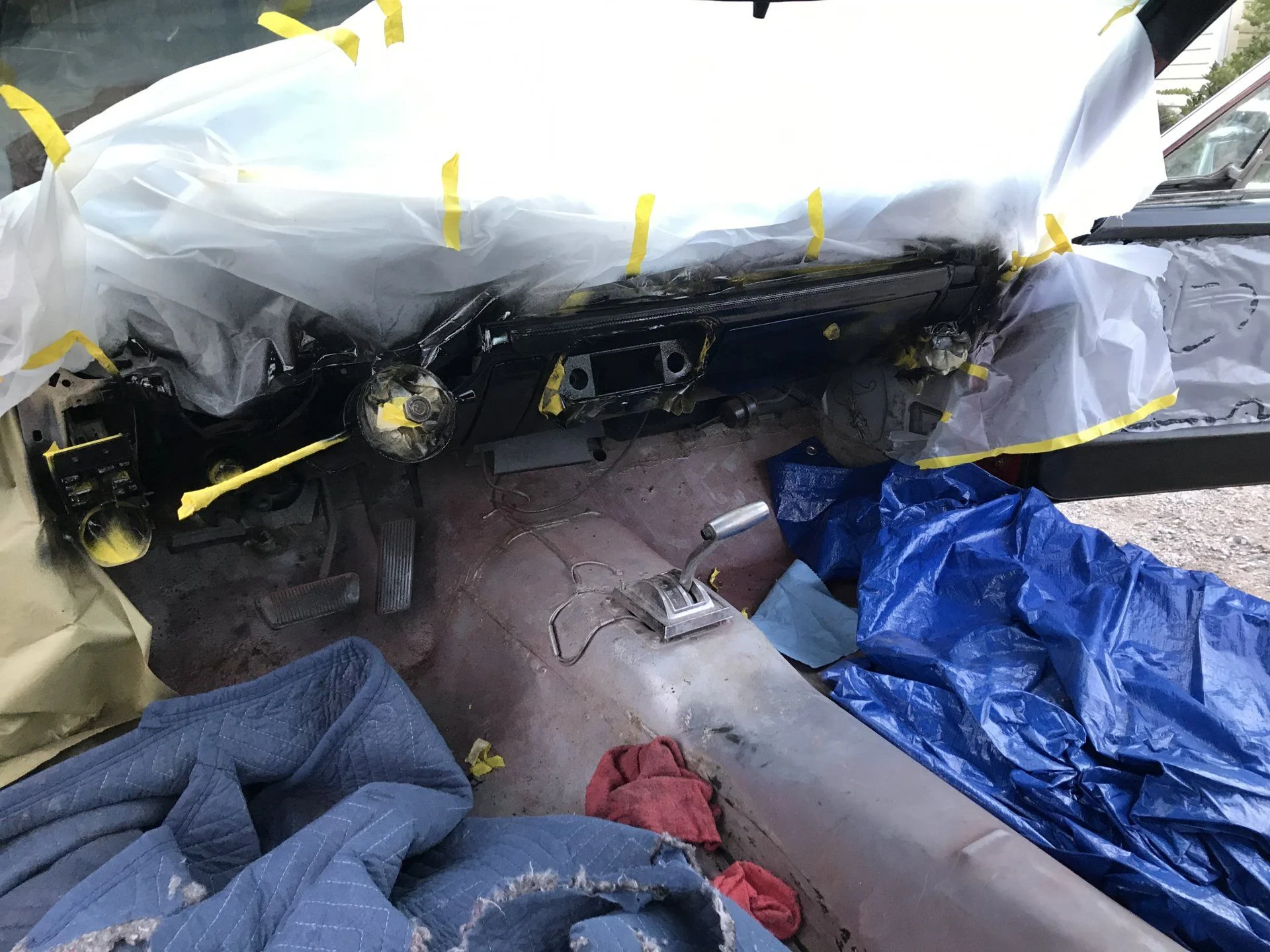

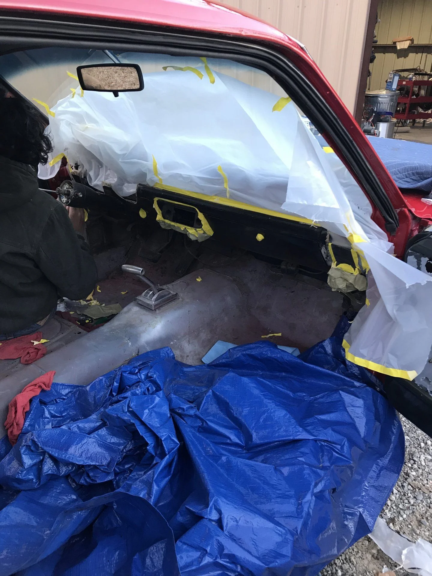

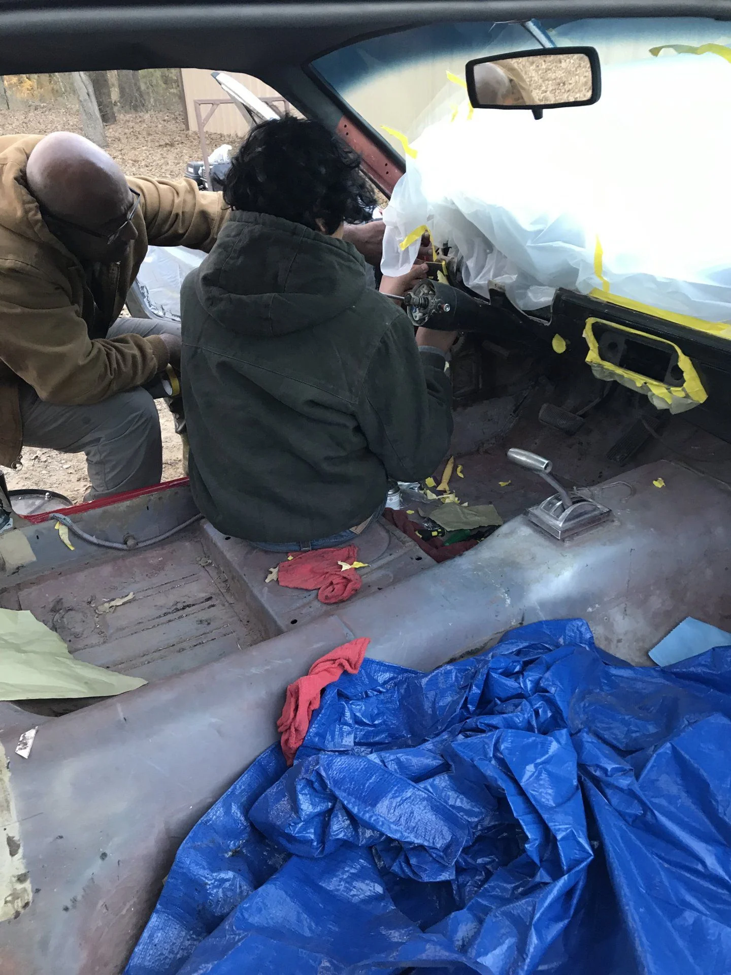

Dash before.

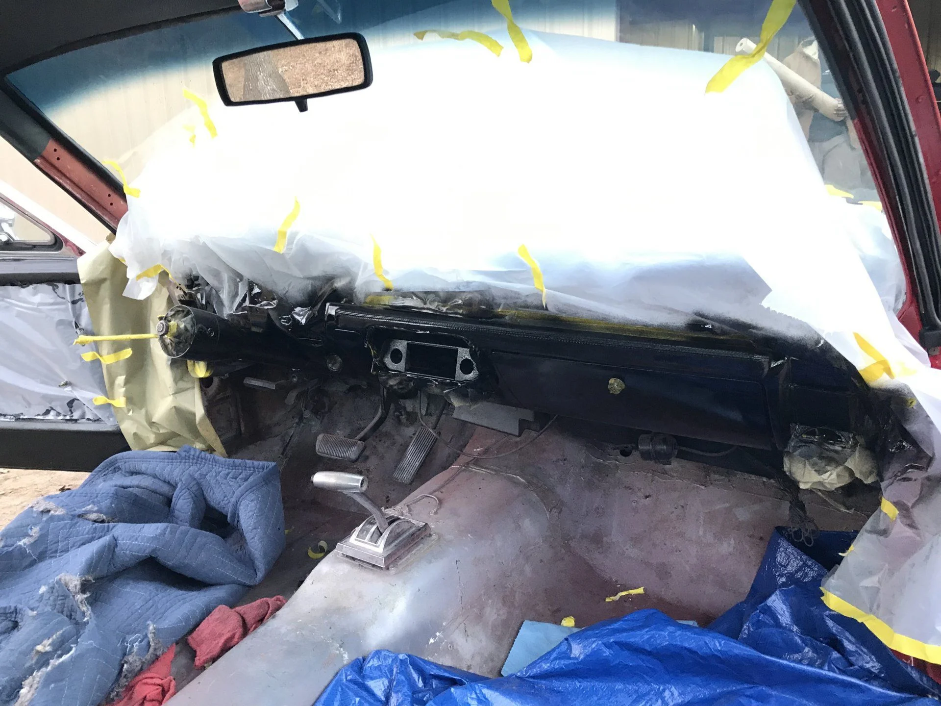

Dash after

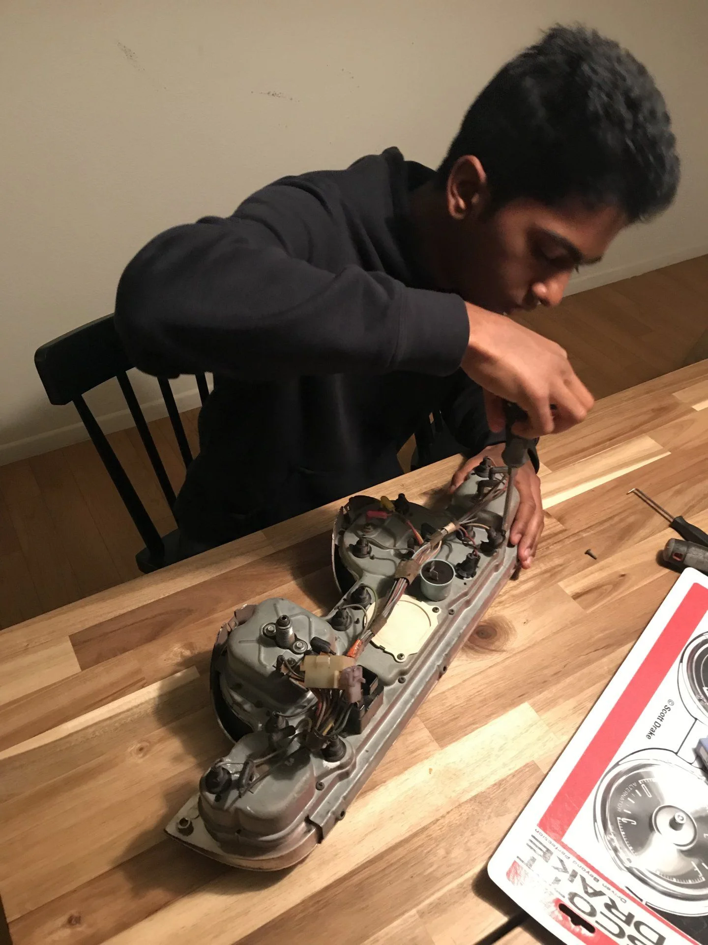

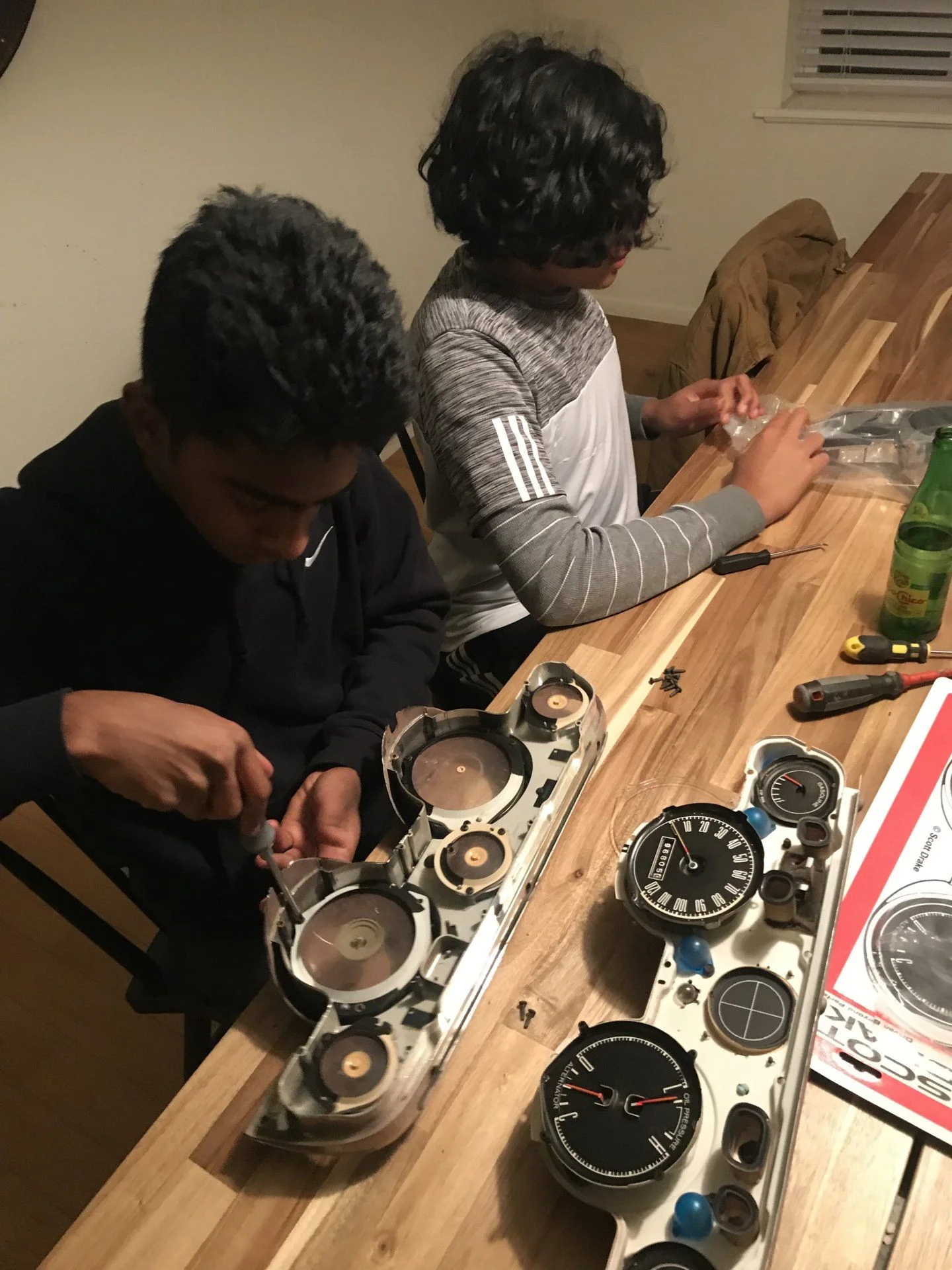

Interior dash refresh.

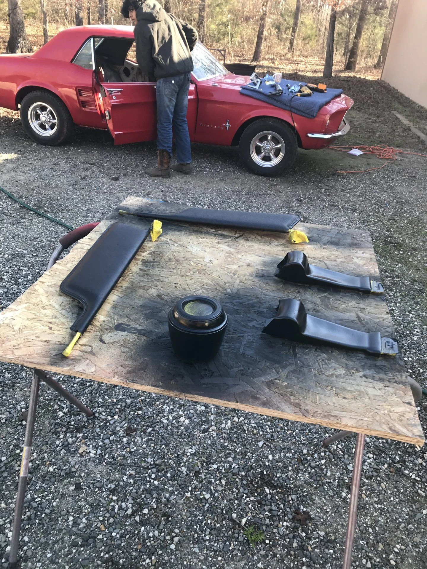

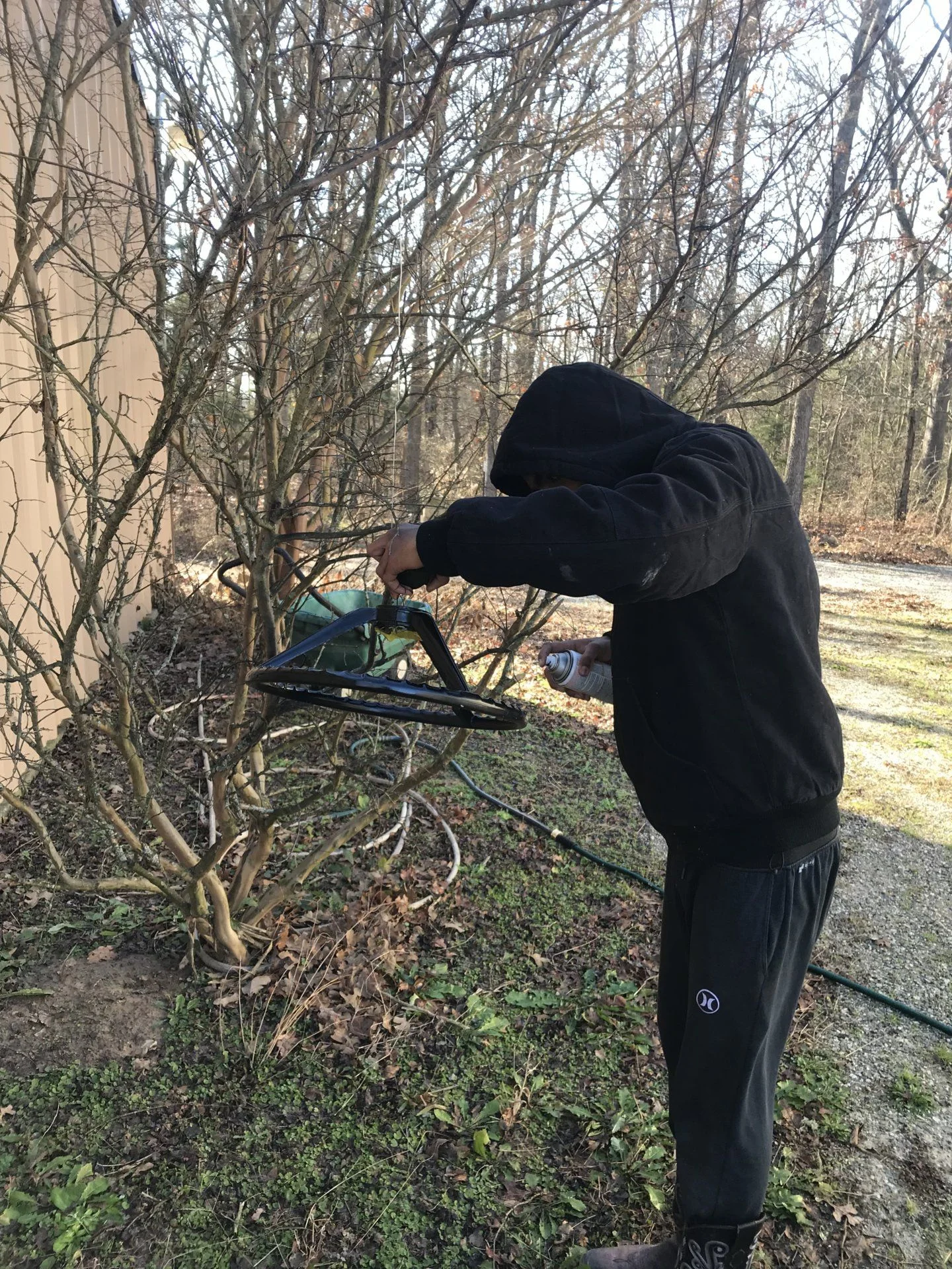

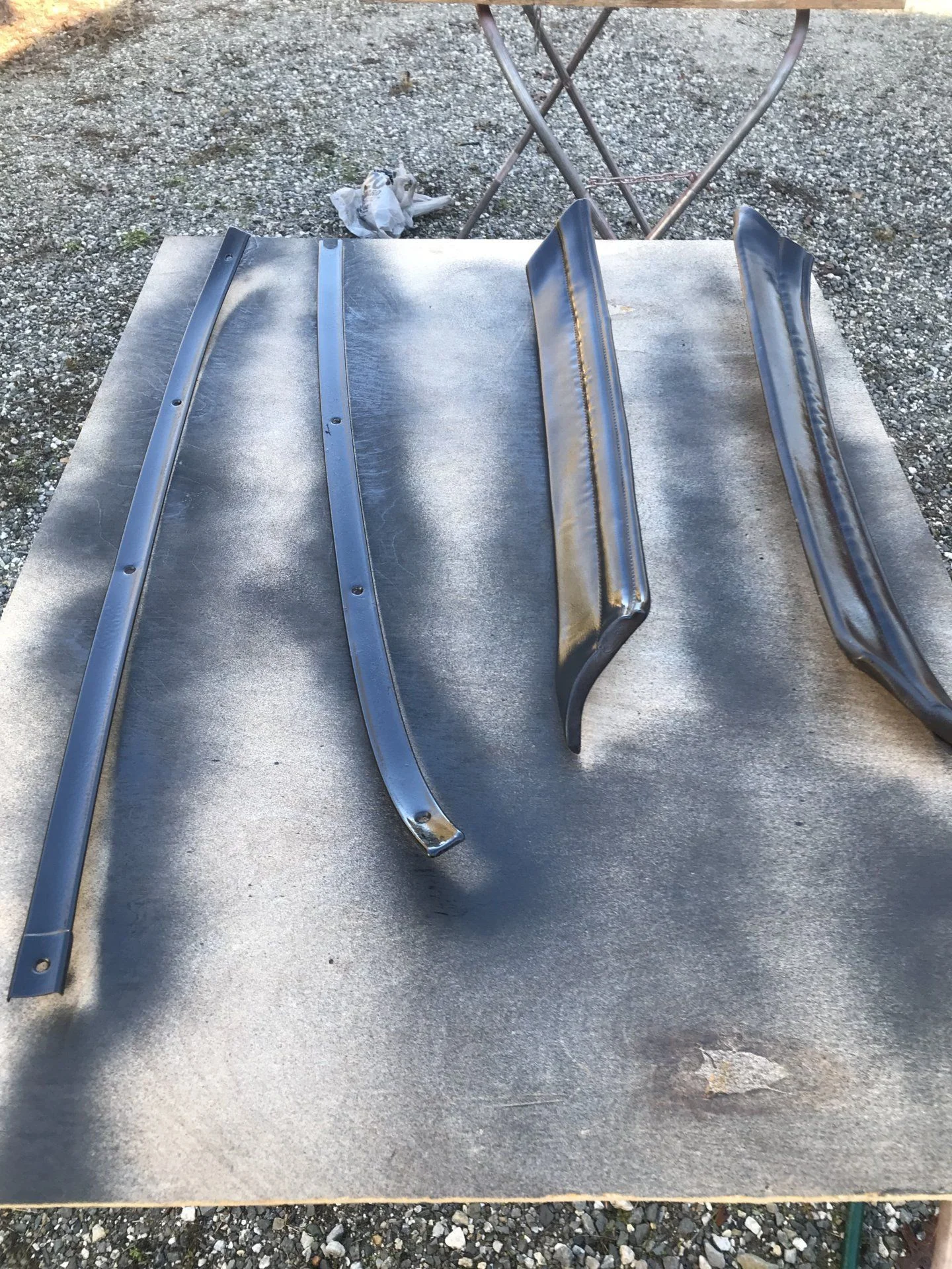

@SipLife also refreshed the steering wheel, horn button, a pillar covers, sun visors, and seat belt posts. He also got the door cards spruced up with new wire push pins.
We plan to knock out the interior this week.
Nice work. How well does paint on things like steering wheels and visors hold up in Texas heat? My 70 series wheel could use some paint. Any specific paint you guys use?
@ci
I have not done this before so I cannot offer long term results. I will take a pic of the the paint we used. It was from Autozone black gloss. Works on leather, plastic, metal. I will report back on long term testing.
I would sand with 320 grit. Hit it with epoxy primer then paint.
High heat paint might hold better against sun fade.

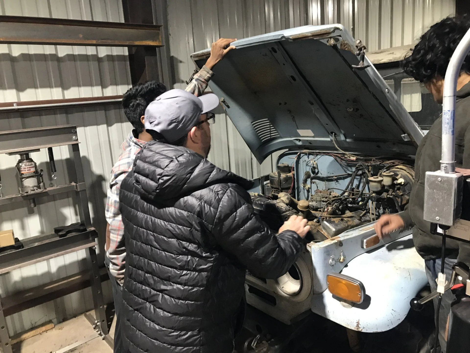

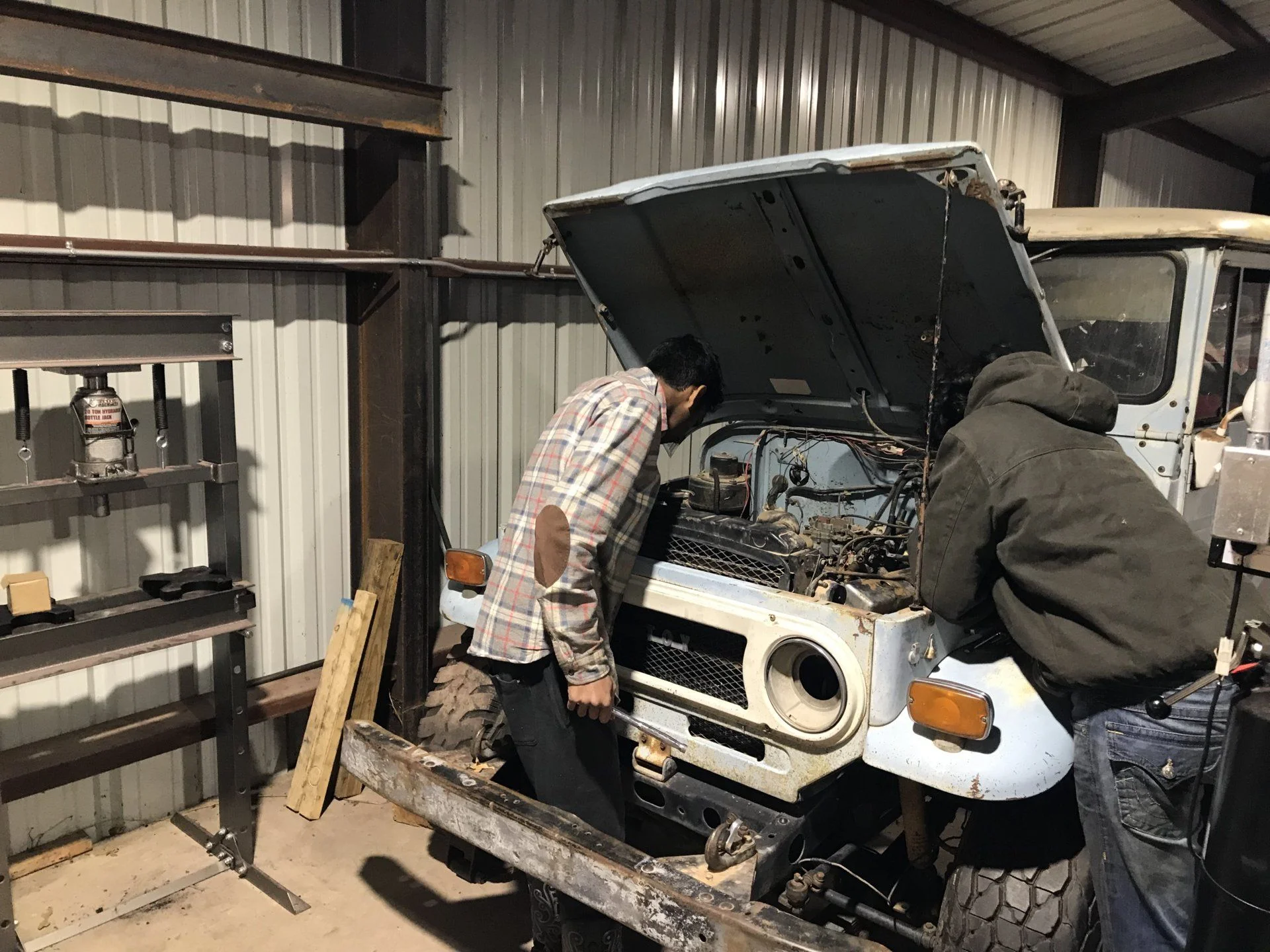

We hit the barn this weekend. @CaptClose was longing to see Old Landy. It was an epic trip we both did to get her. Forever life changing in so many ways. He helped @SipLife with the Cavazos touch on interior finishing of the Mustang. He also help @Cowboy45 remove and install precups on the 2H head. We talked about the Old Landy build plan.
We also tried to verify if the Chevy corvette motor in Bluebonnet could rotate after a marvel mystery oil soak for 4 months. Confirmed it was a dud. 2H will go into it in the next two months as part of @SipLife ‘s build.

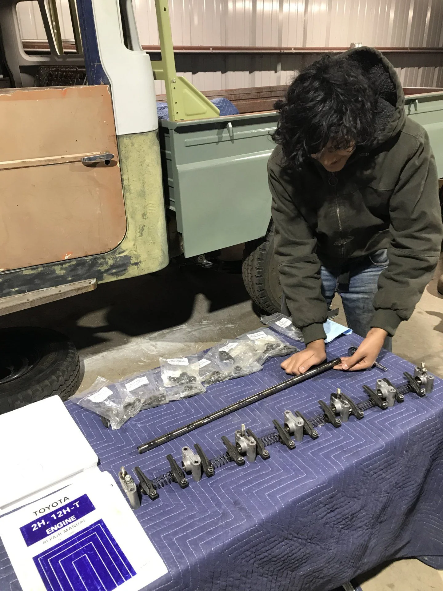

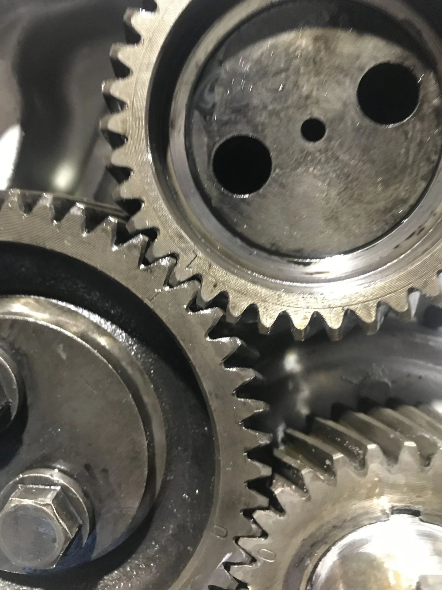

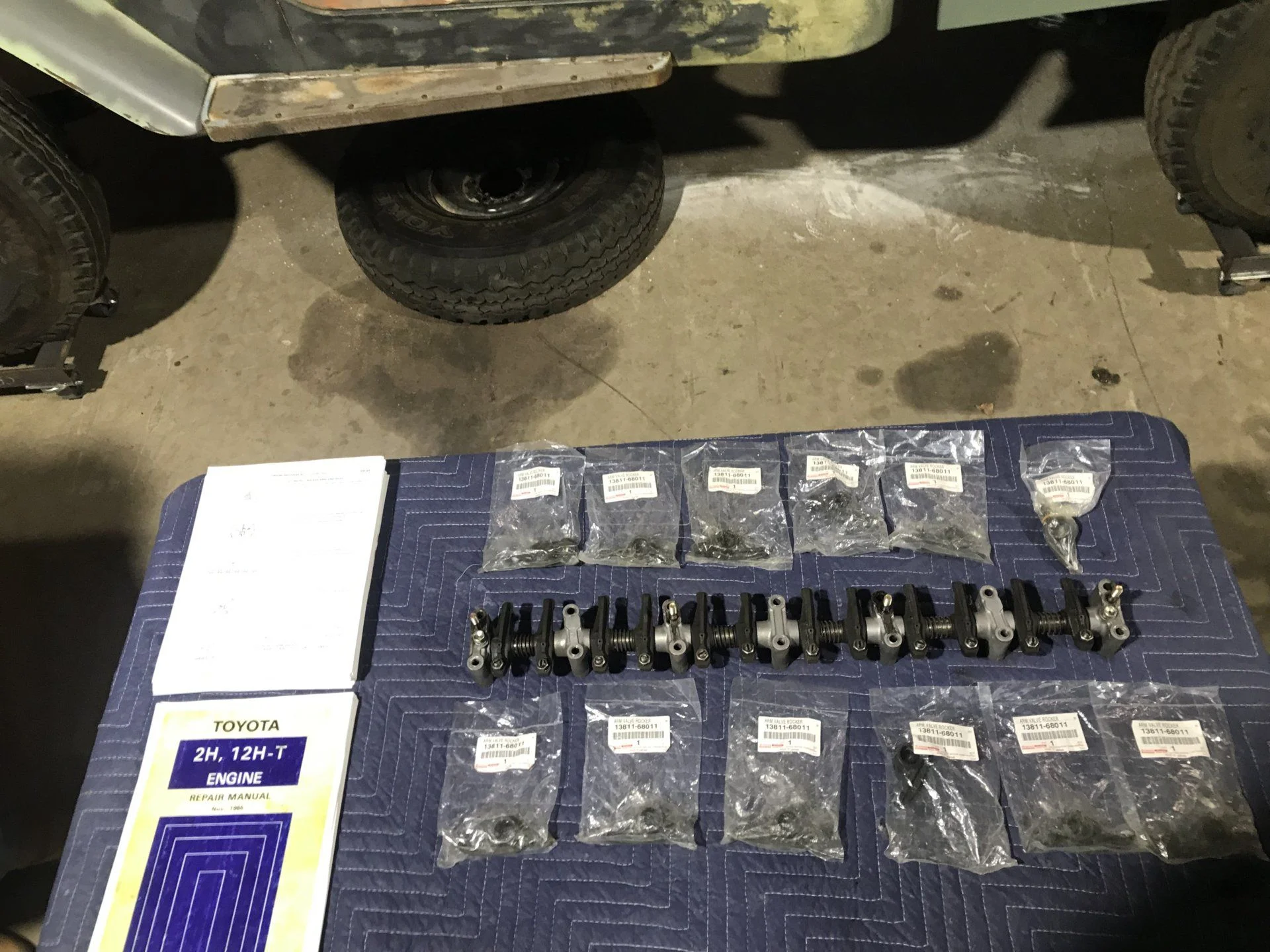

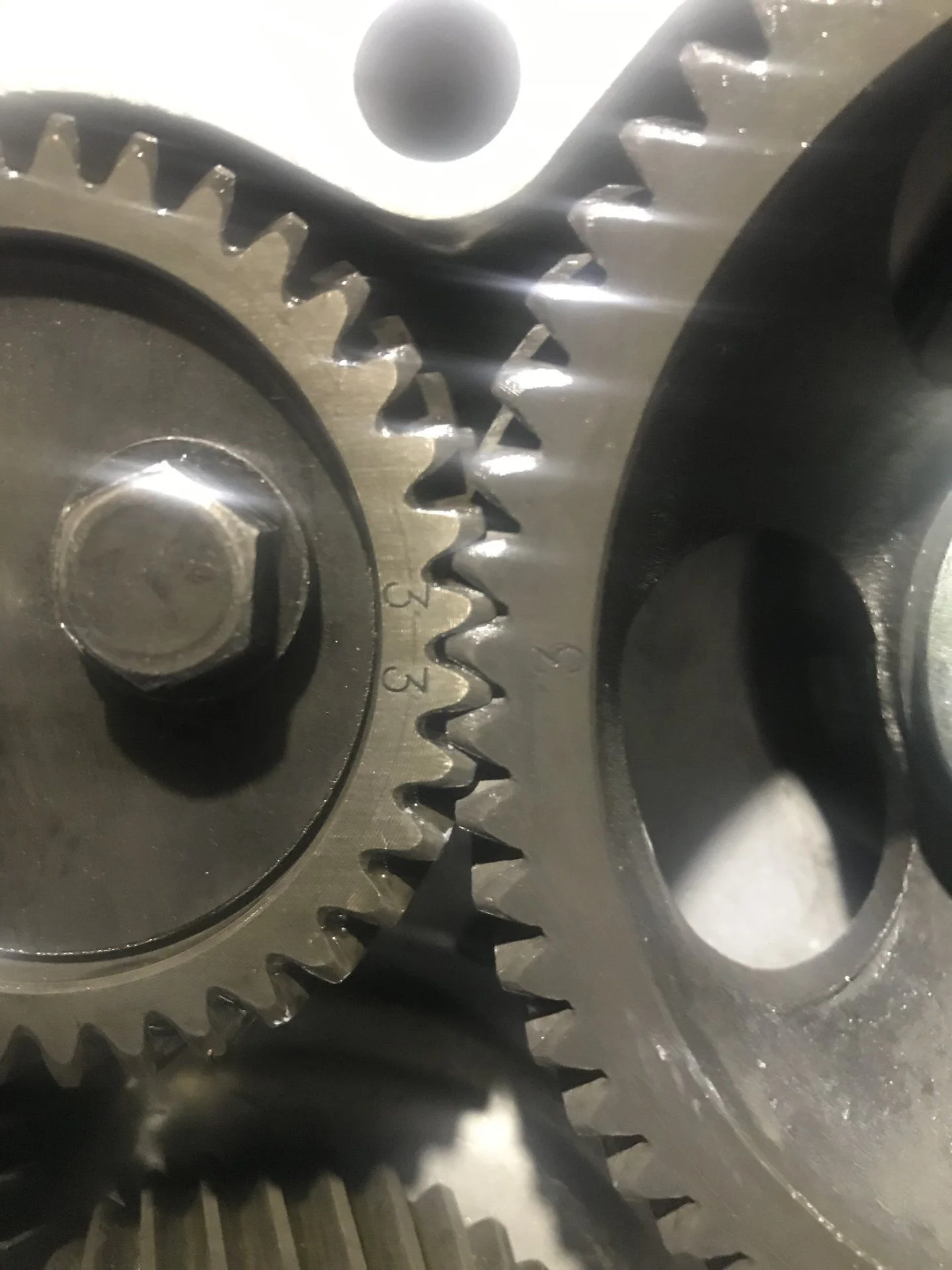

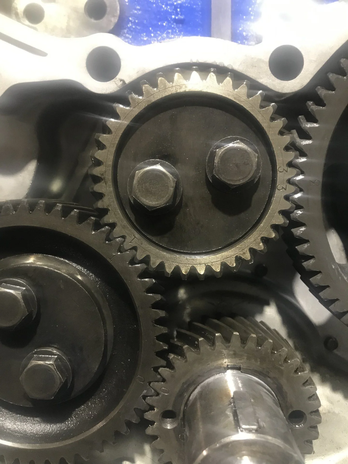

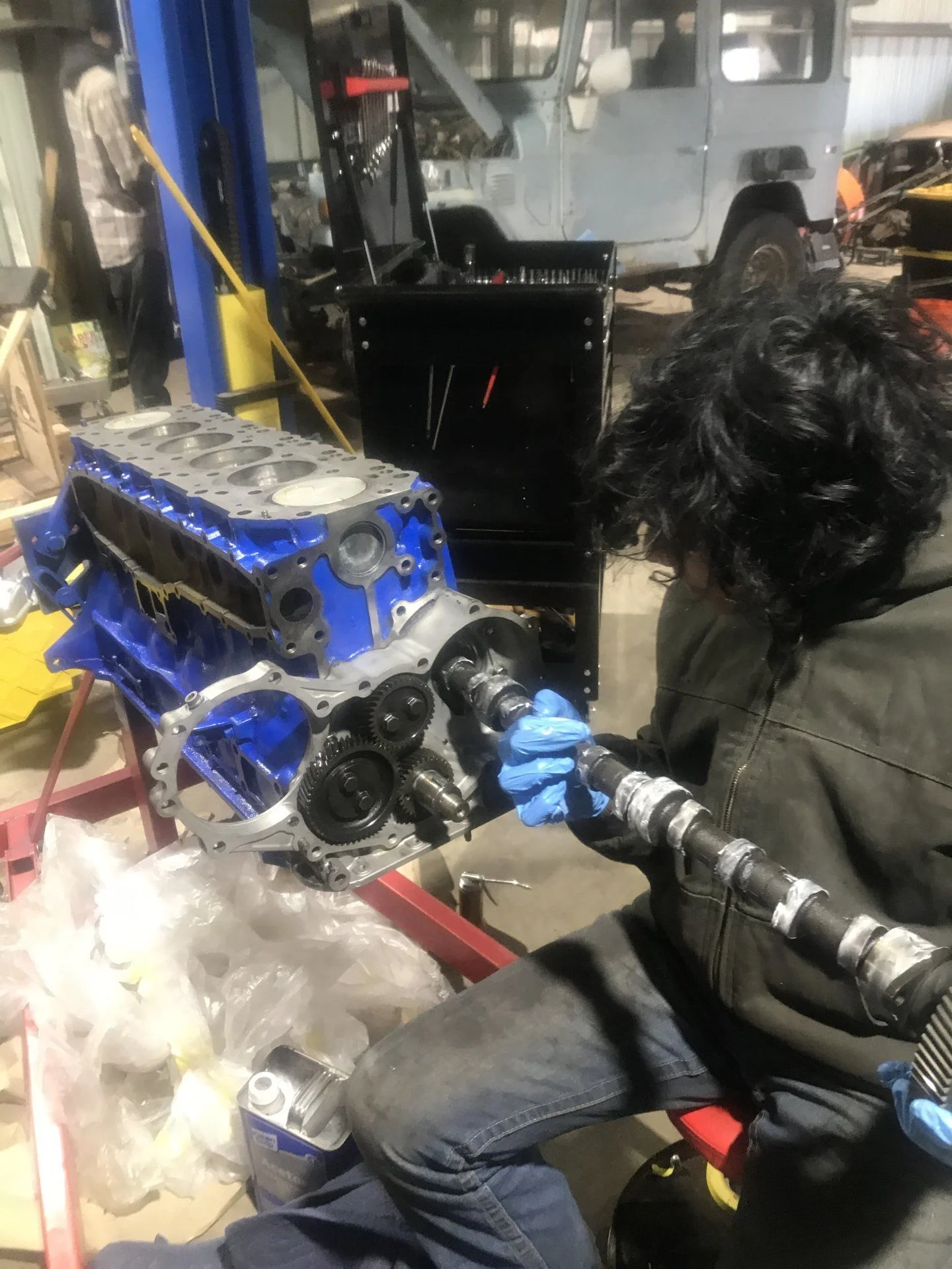

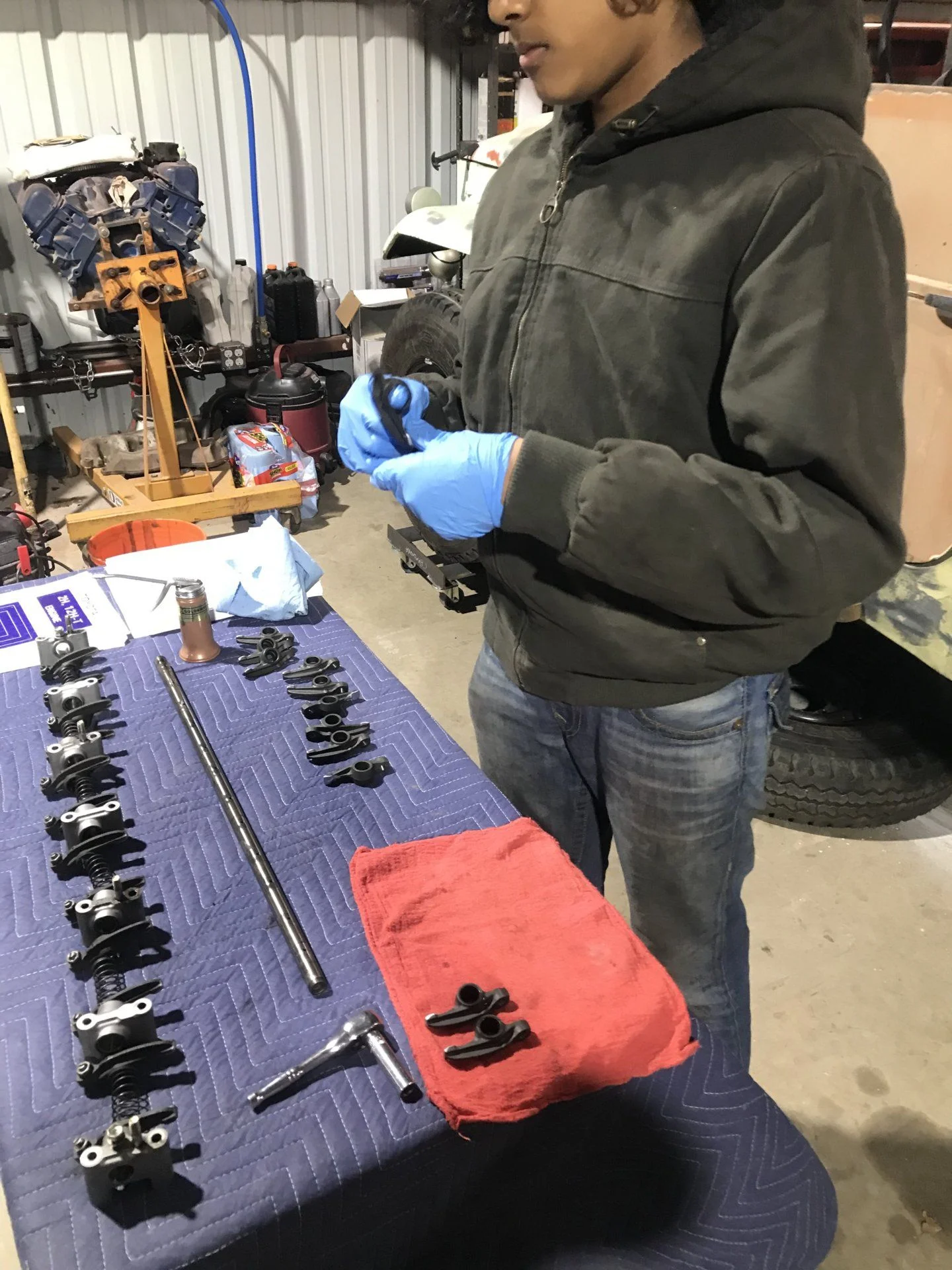

We hit the barn this past weekend just before the elves returned to school. @Cowboy45 spent a good deal of time making headway on his engine rebuild. He will document this more in his Old Landy build thread in the 45 section. He rebuilt a rocker arm, set the timing gears on the crankshaft, number 1 and 2 idler gears, and locked in the camshaft gear. It was easier and more certain to get this done with the cylinder head off

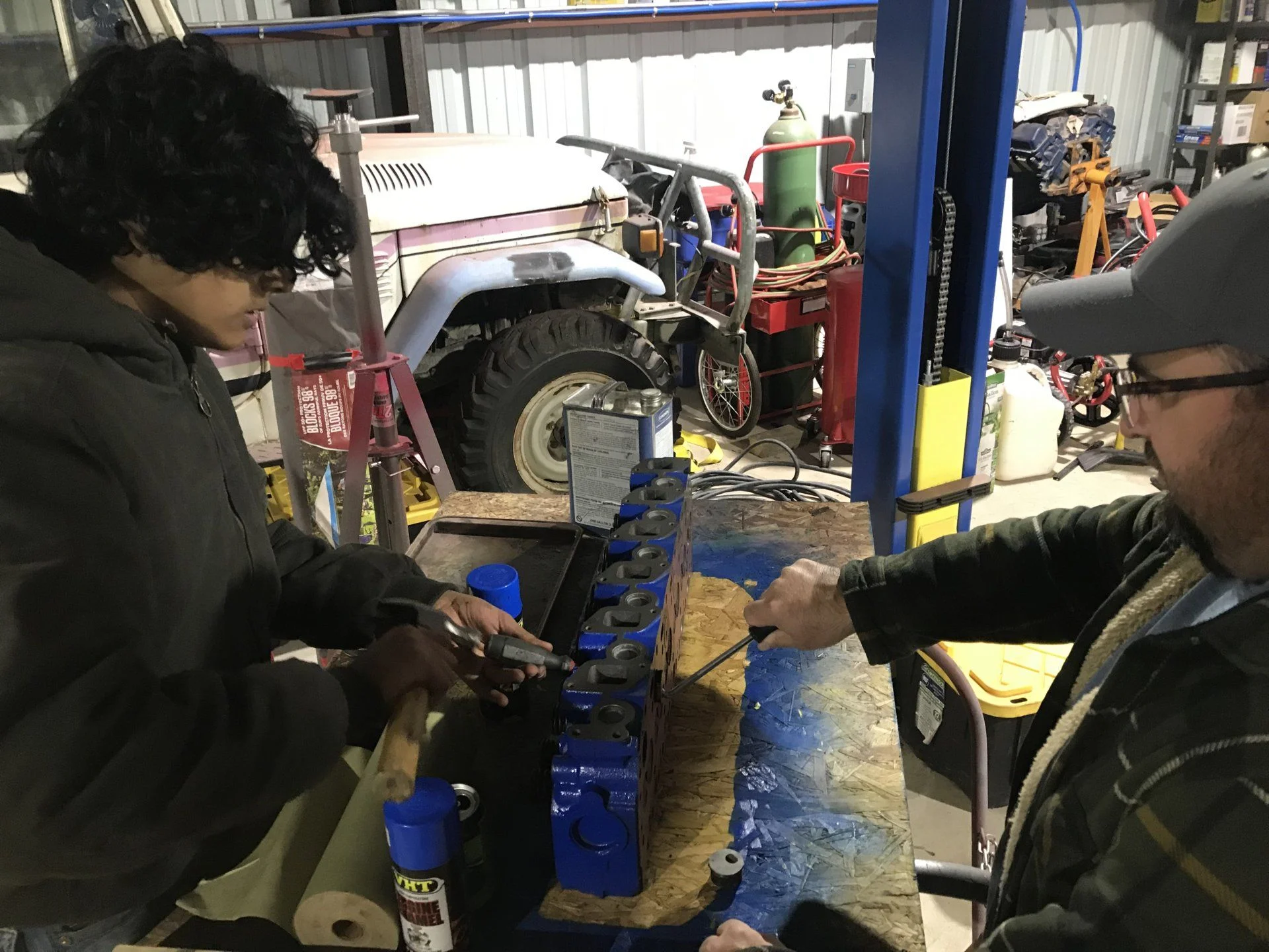

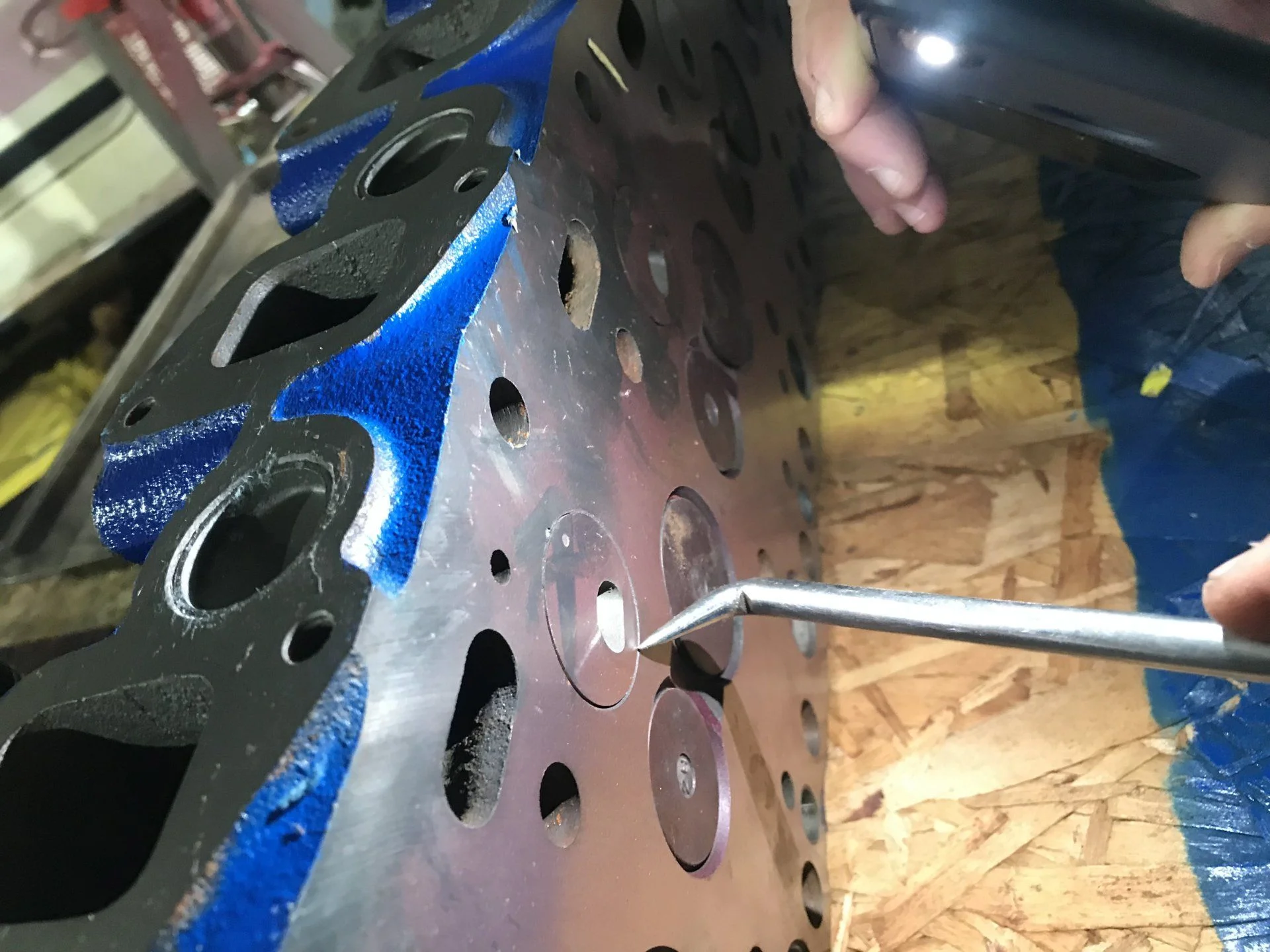

He then installed the cylinder head that was recently re-decked after precup installation. @Cowboy45 is becoming a good engine builder. Meticulous and by the FSM. Doing it right the first time is high with him. He also loaded in new lifters and lifter rods and placed the lifter covers in place. He sandblasted thermo housing, water pump housing, painted them, installed new water pump. He also installed the oil cooler after adding gaskets and seals to the oil heat exchanger.

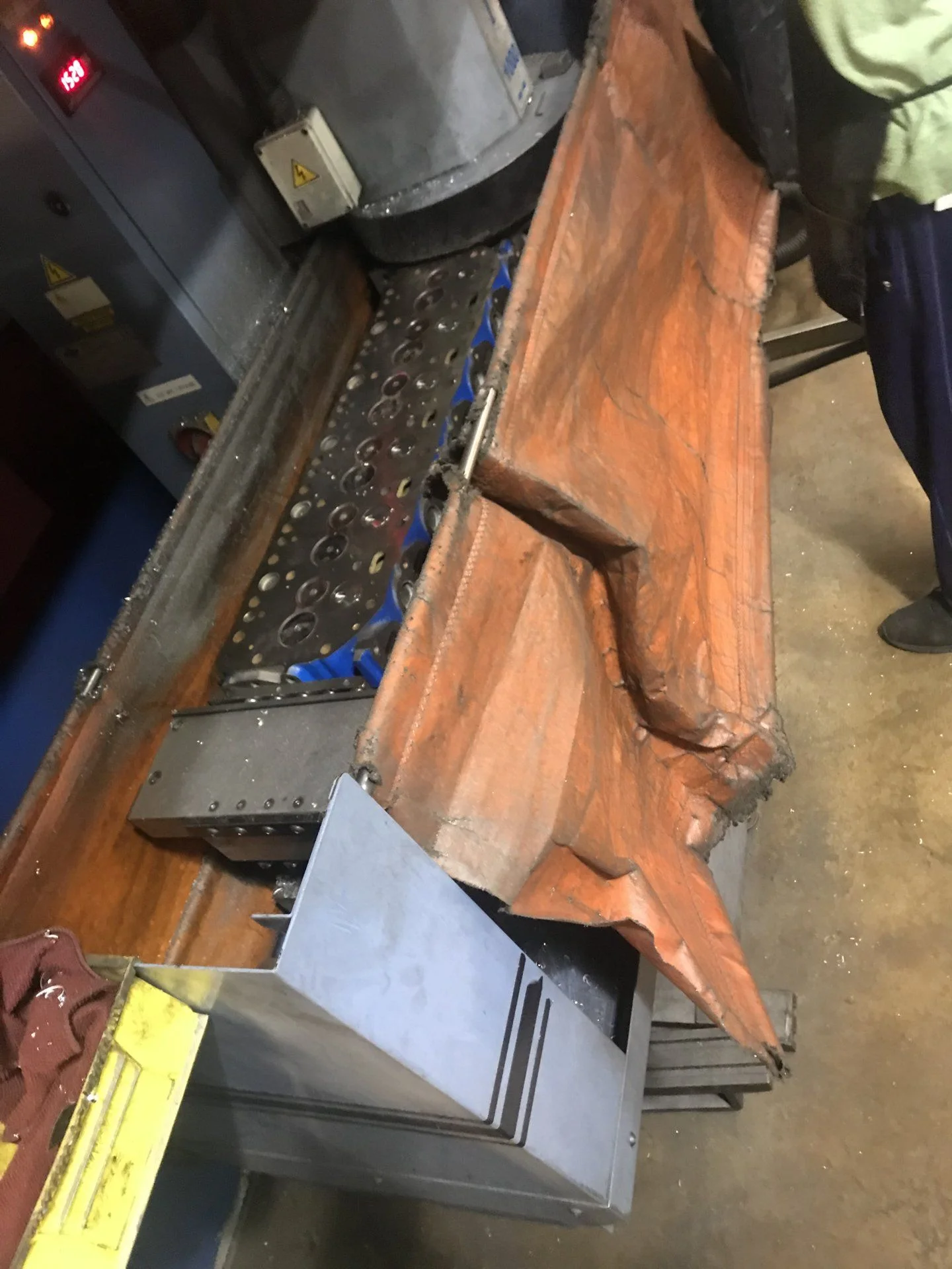

Pics of precups getting decked.
Pics of @Cowboy45 rebuilding the rocker arm with new components
Timing gears being set and camshaft gear aligned.
