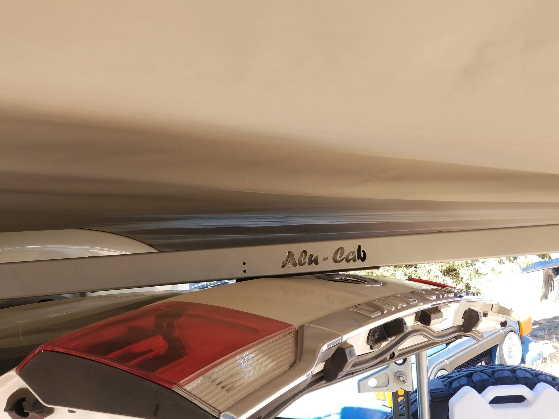

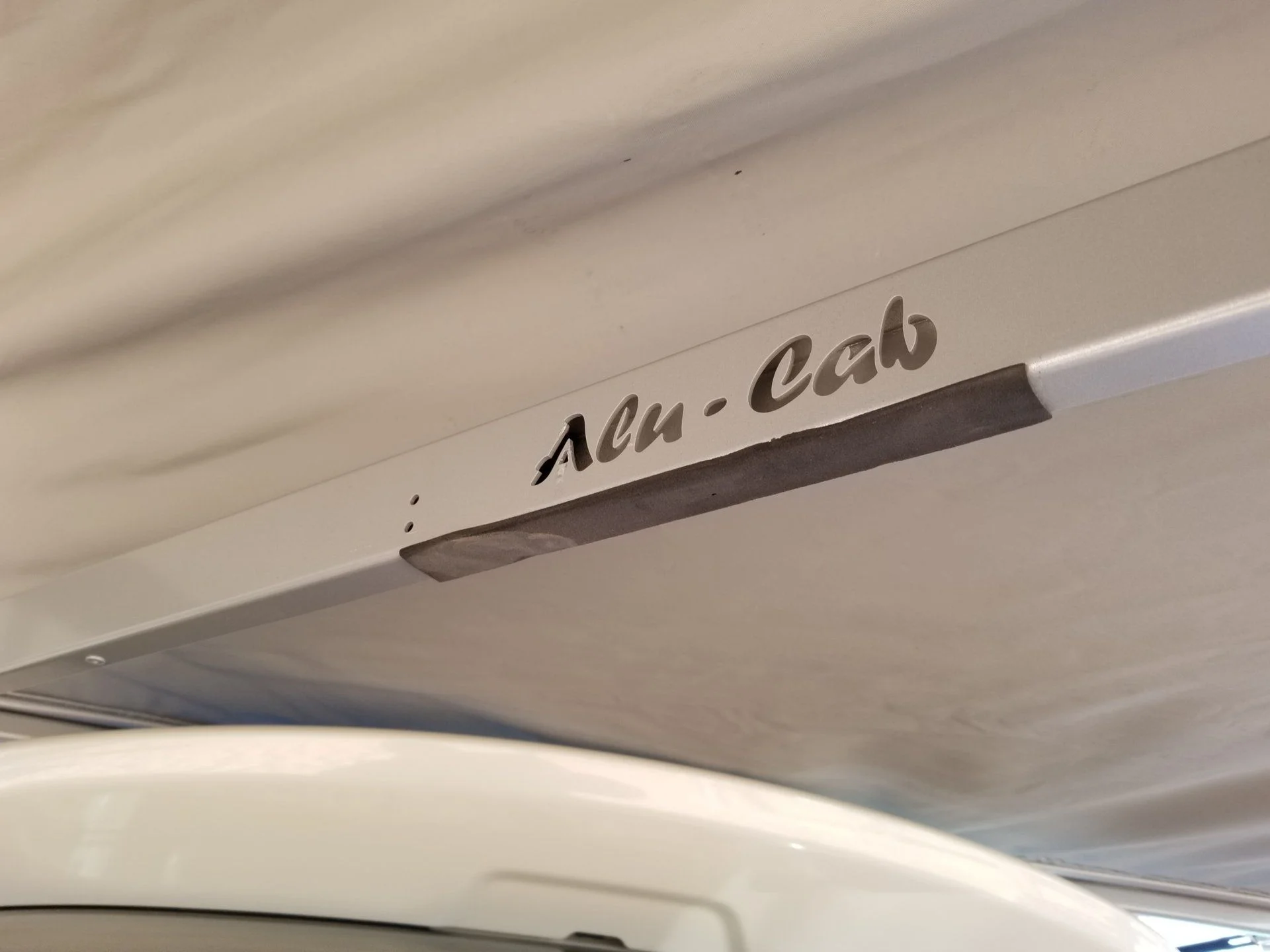

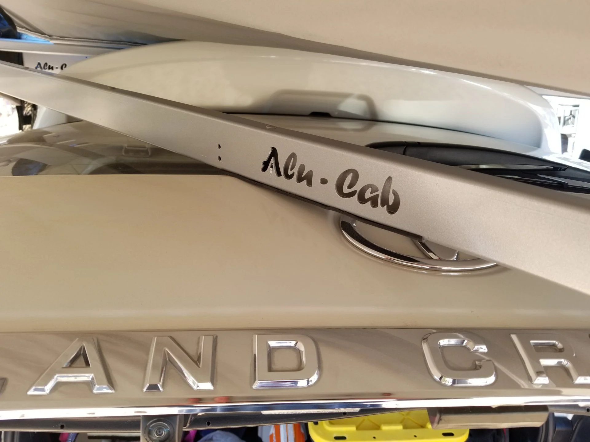

How much clearance do you have between the liftgate wing and the Alu-Cab awning where mounted on the Slimline?
Negative 2" of clearance. The tailgate bumps right before full extension. I was worried about the tailgate fin hitting the slimline - but it clears perfectly. And the fin also clear the Alu Cab perfectly as well.
I have a small rubber bumper on the bottom of the awning arm that touches the land cruiser emblem on the tailgate. Since I lifted the truck 3+", there is no headroom issue any longer. So I will probably continue to live with the 2" loss on tailgate opening with shadow deployed. The trade off to resolving the 2" clearance, is to lift the awning via fabricated brackets, but that would then require using a step stool to put the awning away. It is just about out of reach with the truck lift alone.
I was considering making lift brackets for the alu cab but glad I waited until the truck lift was completed.

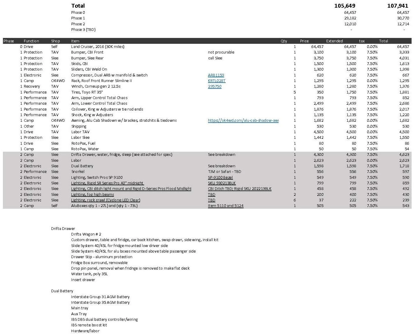

For those spreadsheet guys (yes I am one of them), here is the build and spend including my research to date on Phase 2. FWIW.
Hurry up and delete before your wife sees this!! :D
J/k I'm sure she's supportive. I actually want my wife to know how much all my toys are worth so she knows how much to sell them for if I die unexpectedly!
Thanks for the feedback. If you ever get a chance, I'd like to see a pic of it open before I buy one to visualize exactly where the contact lines up. I've been running the CVT awning, but really like the 270 style...
I posted up a few pix on my initial response above (about 5 posts up).
View attachment 1603087 View attachment 1603088 View attachment 1603089 View attachment 1603090 View attachment 1603091
Thanks for the pictures, it really helps. I sold my 270 awning because in 4 years, I never used it, but I just didn't live in areas that made it worth while. But I move a lot, so I was looking at that alu-cab, so if go that route again, I think I'll make a bracket instead, to get the awning up a bit more and fully clear it. Thanks for saving me some money.
Glad the pix were helpful. I thought about making an adapter for the existing brackets to move the awning up 2". But now that the truck is lifted 3", another 2" will make the awning a bit too high to manage. So I think I will just live with it as it is for now.
Cheers!
Thanks! That helps. Looks like the wing makes the awning fabric tent up a bit? Has anyone done a wing delete on a 200 yet? Seems like everyone was removing them from the 100s back in the day.
