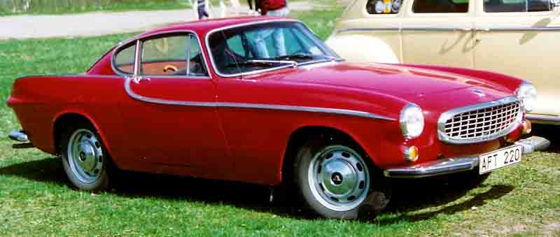

As for as Volvo's, if you are going to join this group, I say post away but roll in with one of these.
Volvo P1800 - Wikipedia, the free encyclopedia
IMOP this is the only Volvo worth leaving a cruiser for.
Volvo's are worthy of collecting and enjoying. You would join the likes of Colin Powell who loves to go into his garage and working on his Volvo's.

Oddly enough, if you go with that particular Volvo, the transmission is damn near a spittin image of an FJ40's. I offered to rebuild a buddies Volvo tranny, and it was insanely similar in shape, and construction. :-)
