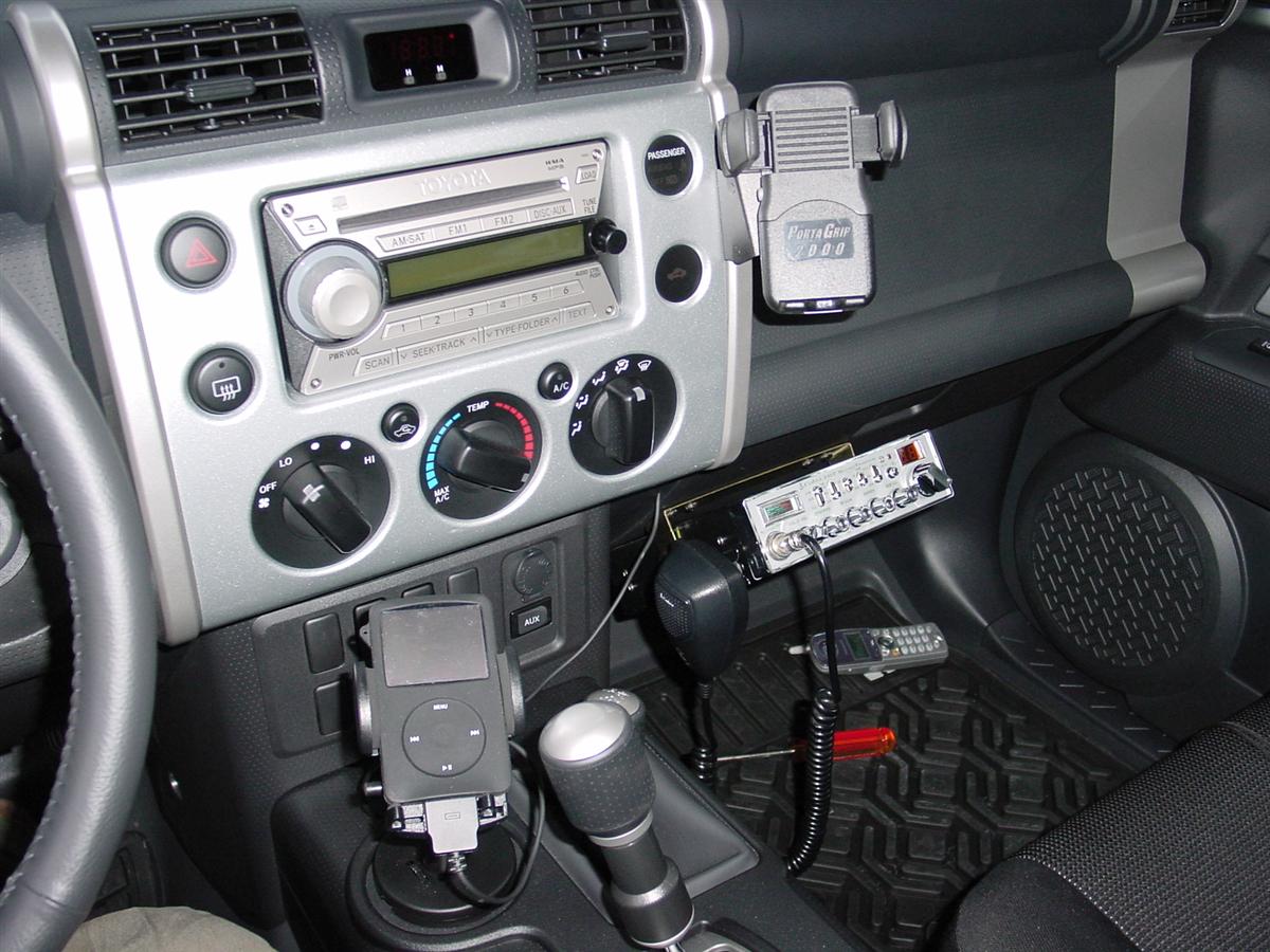

Dash mount not good for GPS signal
Drove into work this morning with the Garmin in the new mount.
Useless, it can barely get a lock on the network up in the sky.
It picked up a bit, but not good enough.
I like having the iPod up there though, it is easier to reach the wheel on it to select playlists than reaching below in the other mount.
The Garmin worked great laying it on the dash in the grove of the drivers side glovebox.
I need to find a way to mount it so it points up to read it.
Kind of hard to read it this morning there with it on its side.
Found out my speedo it dead on though, it tracked with the GPS beautifully.

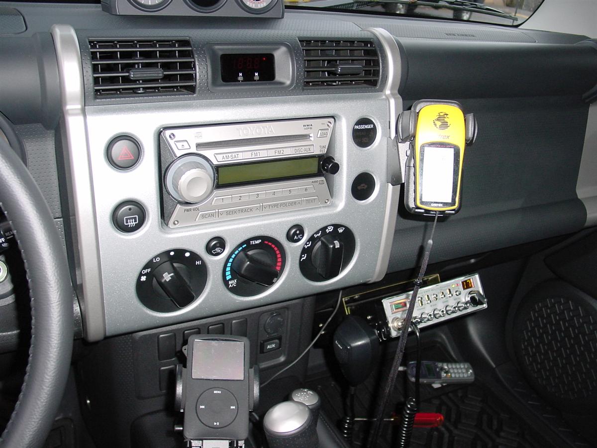

GPS works in lower mount
Good news for those wanting to carry a small GPS like the Garmin eTrex line.
I put the Garmin in my lower mount where the iPod use to be.
For some reason even though that mount is lower than my new dash mount, the Garmin on the way home did not skip a lock on the satellites.
Works great there.
From now on the lower mount will be for the GPS, and new upper dash mount will be for the iPod.
Although this does not hold a full size GPS like you would use to find a store or directions, it will hold the smaller GPS units that you take 4wheeling so you can capture your waypoints to put on your PC.
