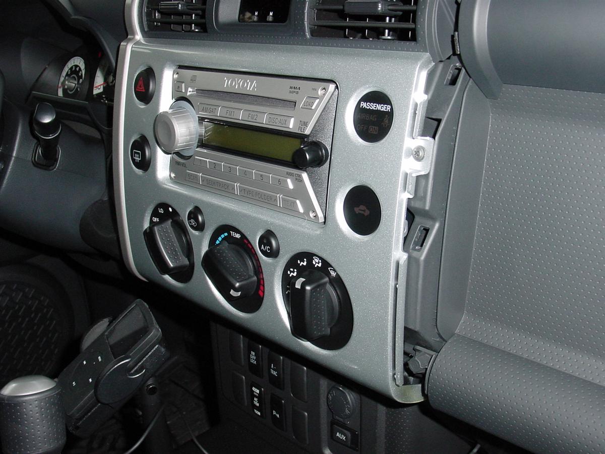

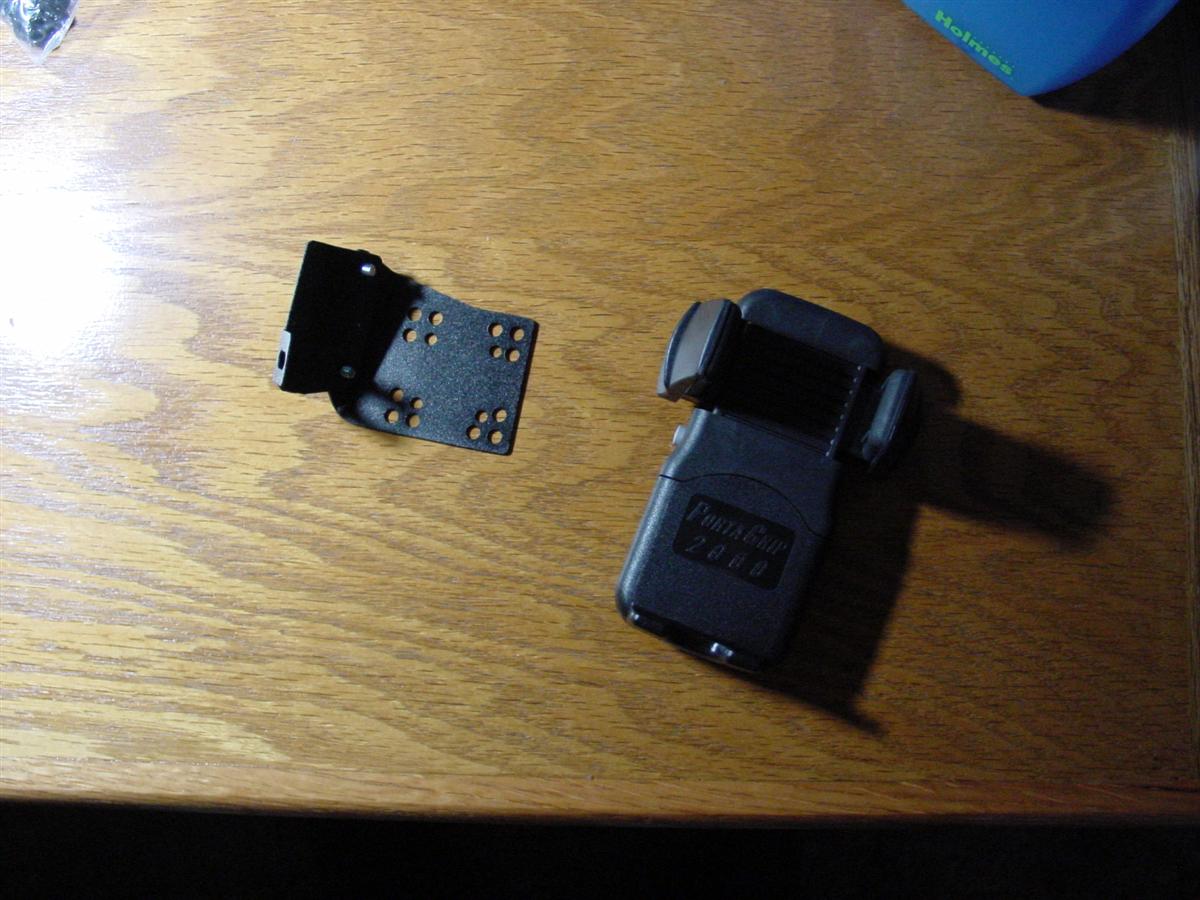

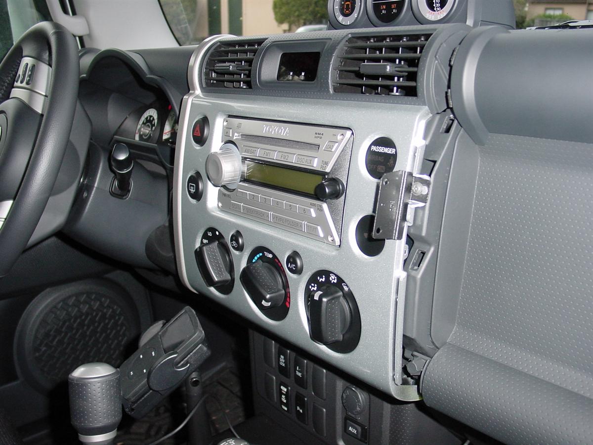

Panavice dash mount/grip installed 12-13-2006
You can use this mount for your iPod, cell phone, or a GPS.
I already have a very nice iPod mount, but it is kind of in the way of my A Trac and E Locker buttons.
I may move the iPod up above now, or use this for a GPS mount depending if I can get a signal there or not.
Very easy to install.
1. Take off the plastic wing with one screw at the bottom of your stereo dash and pull it off.
2. Take the small metal piece and put it under the screw by the stereo, and mount it.
3. Put the dash plastic wing back on again.
4. Use the two small acorn nuts to put the rest of the Panavice mount to the smaller piece.
5. You can pre-mount the PortaGrip to the backing plate first like I did.

Thanks.
I could toss mine in there too, and then just pull it out when I want to change playlists.
I find it easier to do it that way than try to do it from the head unit.
