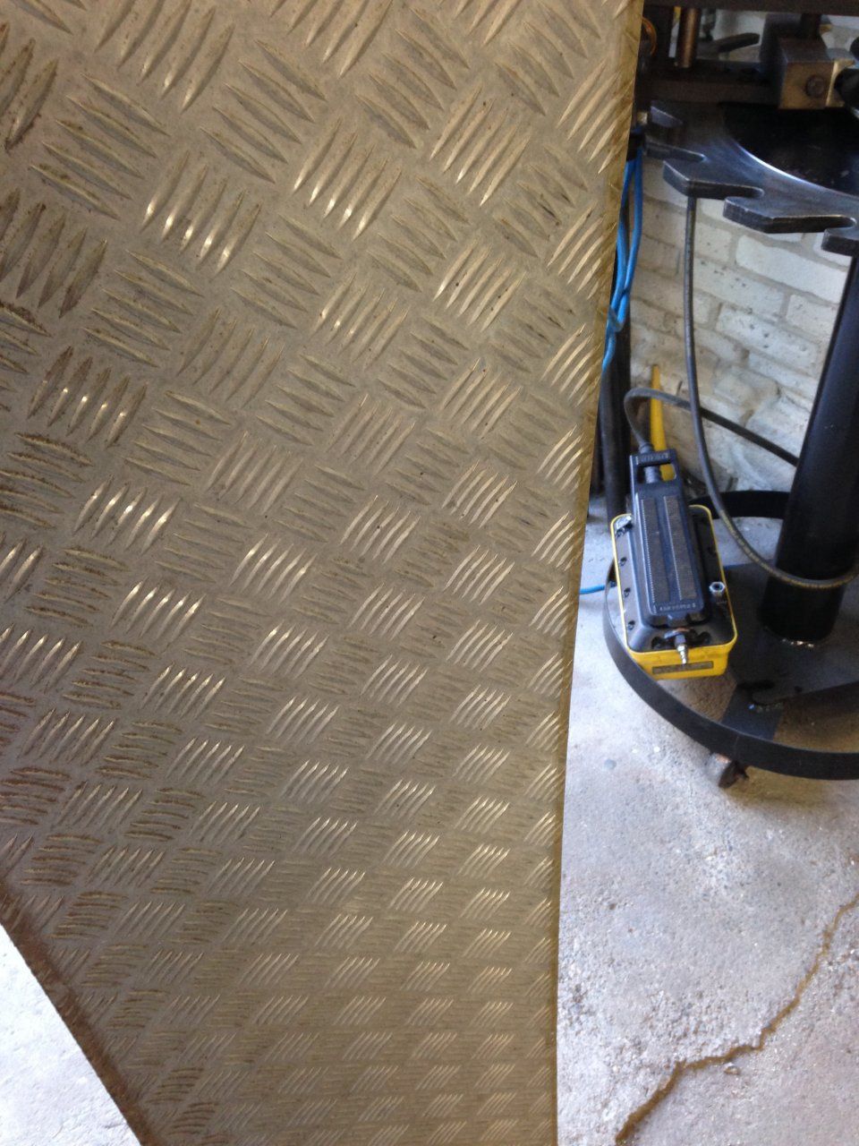

Look what I found cleaning. I think I'm gonna use this on the 80. Maybe on the hood sides. I'm always wanting to put stuff down on there but always stop my self cause I don't wanna scratch the hood up. This might be perfect. But a little land rover stylish. I'll powdercoat them flat black if I do it. Any thoughts. I have three long pieces of it.
Then I assume you have no plans to Bedliner your 80?
