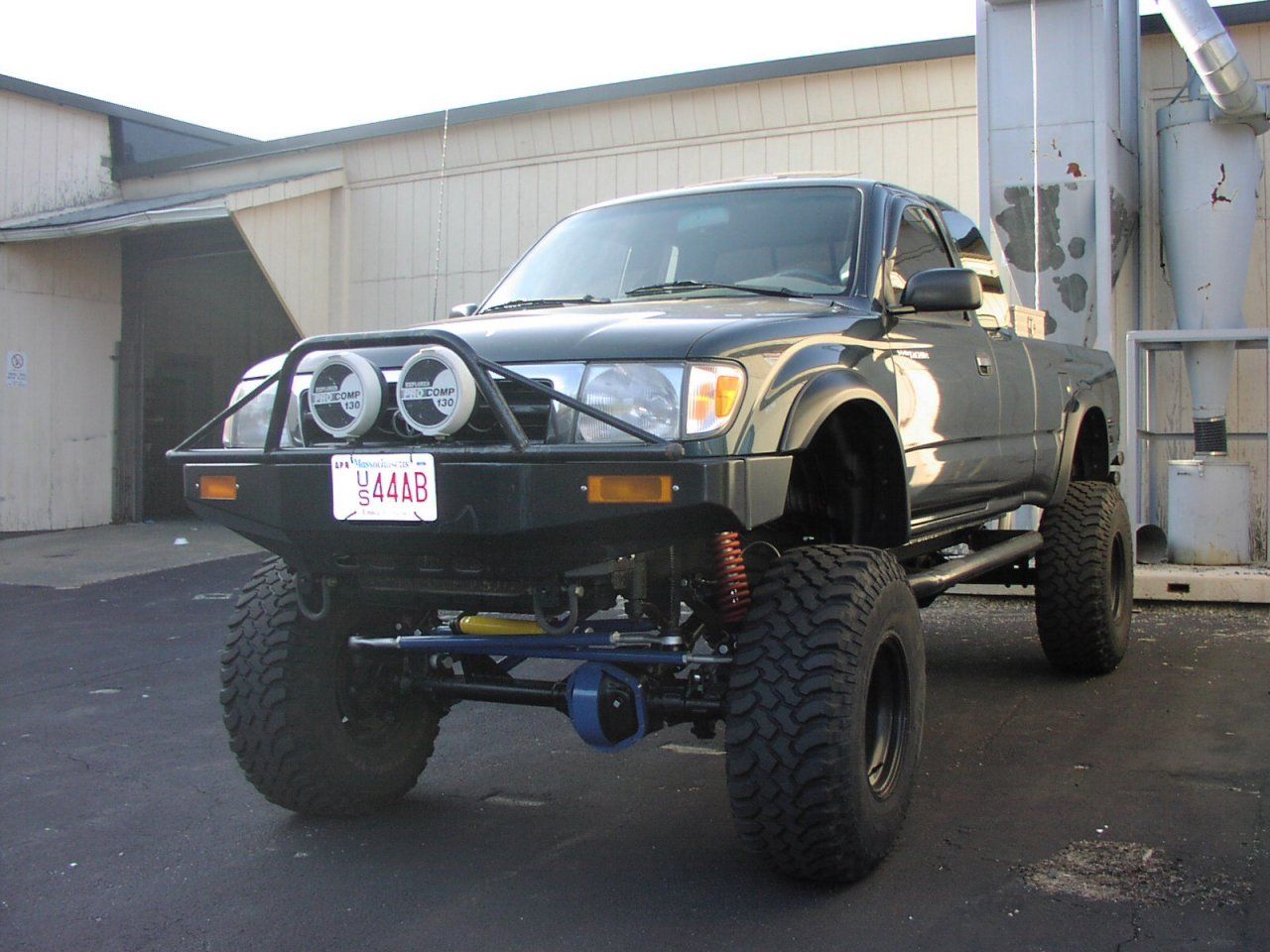

That is too damn cool. I only wish you didn't paint it black :)
You know...... I was thinking that after I sprayed it. Lol. It kinda mutes all the detail. I was gonna do like a gun metal gray to match my steel wheels. But then I would have had to paint those over too. My neighbor suggested clear coat. He said why hide all the work. I just wanted it to look finished. It looks awesome in person and looks like a different truck. I may get bored and respray it later. But for now I'm happy. You truck is awesome by the way, nice work! The front reminds me of my last Tacoma.

Thanks for the positive words. And transitional welding is very common practice in a lot of industries (except bumper building lol) you just need to use the correct filler rod. As far as the tool used to drill the large holes on the bottom of the bumper. It is a mag drill. It has an electromagnetic base and uses bits called rotabroach cutters. Cuts real clean holes. Here's what the bits look like.
