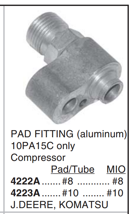

Hmmmm.....looks like 10PA15C fittings are slightly different from the 10S15C linked earlier, these are MEI P/Ns:

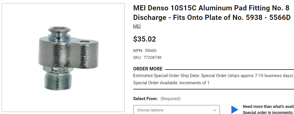

That 5566D looks just like the Omega 35-31004 I got that didn't quite fit, big diameter and there's that shoulder right at the pad that's not on my Toyota fittings:

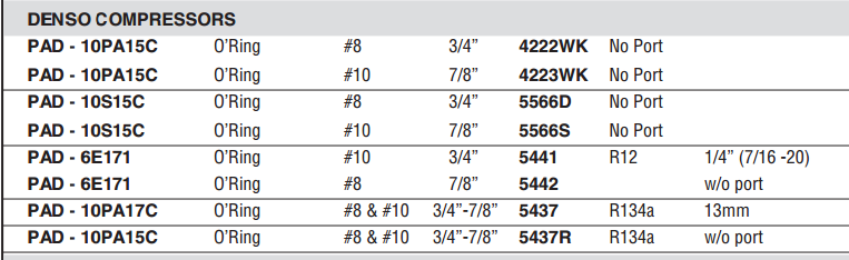

But the 4222A/4223A fittings look just like the Toyota fittings on the end of my hoses....note I did find one website listing the Omega's as a cross to this but it's clearly not:
These cross to Truck Air 08-3498 (#8) and 08-3499 (#10), so I ordered them up and we'll see.
EDIT AFTER RECEIVING ORDER: These fittings are similar but not exactly the same as the Omega's, but most importantly the bottom port is NOT as pictured above. The bags on these said 550-9050 & 550-9051 so maybe there's yet another MFG out there with their own variant! This is insane! Here's a comparison of the Truck Air (left) to the Omega fittings (right). Is shorter which might be useful to someone at some point, but more importantly the hole is the correct size (unlike the Omega's which is too small):
