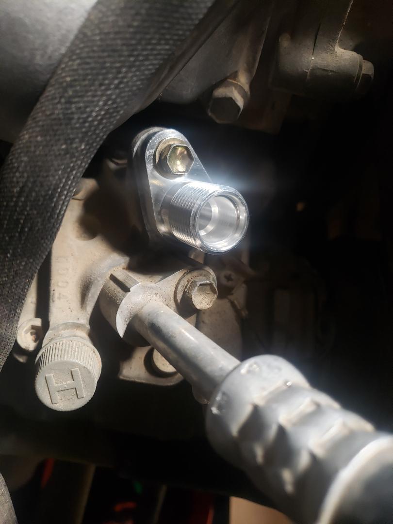

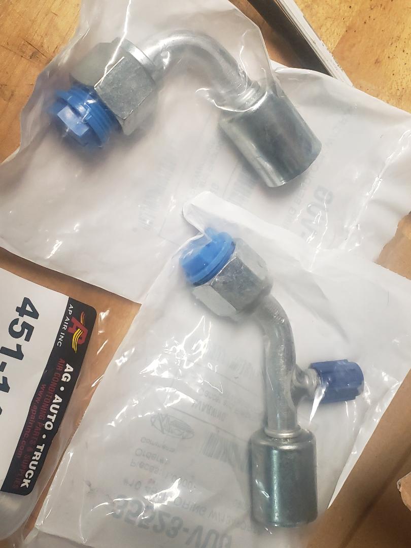

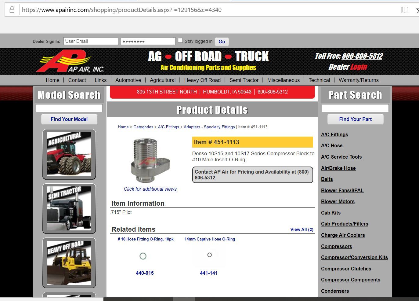

As part of my WitsEnd turbo install I decided to move the location of the A/C line that very inconveniently runs right through the hottest part of the engine bay. Its not a required mod with the turbo, and @NLXTACY does a great job with the build kit of including the necessary heat shielding. I just really didn't like the factory location, excess piping, and wanted to run it in a cooler location where it is less likely to fatigue and crack over time. I Found A/C low pressure discharge to AN10 fitting adapters at www.apairinc.com. I removed the entire discharge hose and tube assembly from the fitting at the firewall to the compressor and reroute with 2 AN10 adapter fittings and hose fittings from vintage air. I don't have a crimper so the next step will be to mockup the new location and mark the hose and fittings so I can have the local shop crimp it down at the right angles. Ill post the results once everything is installed.
Part numbers for reference:
apairinc.com - AN10 adapters #451-1113 (2ea.)
Vintage air #10 45deg w/134 port to mount at compressor. 35523-VUG
Vintage air #10 90deg fitting to mount at firewall. 35883-VUG

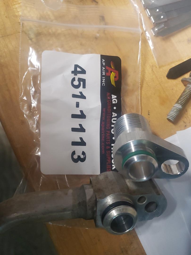

Based on the photos, I realize that the AP adapter fitting works on the Toyota OEM A/C compressor. Have you confirmed that AP Air part number 451-1113 works at the firewall?

Same fitting on compressor as firewall. In other words, both ends of the discharge hose have the same fitting. I won't be removing the condensor hose so I can't help you there. The high pressure side of the compressor uses a #8 adapter fitting, if it looks like the same size as the fitting on the condenser then I would guess it's the same. Apairinc.com has the #8 listed as well.

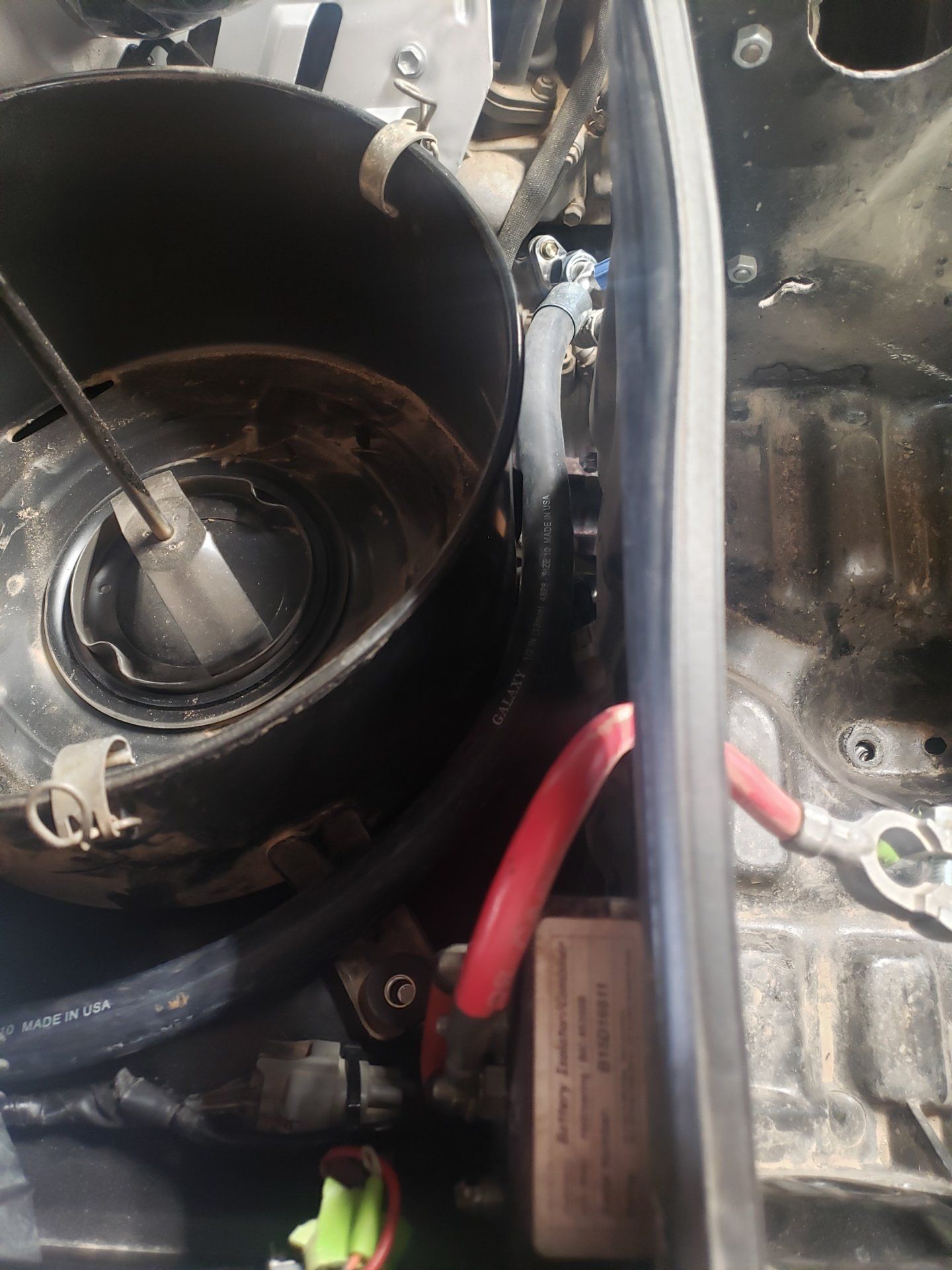

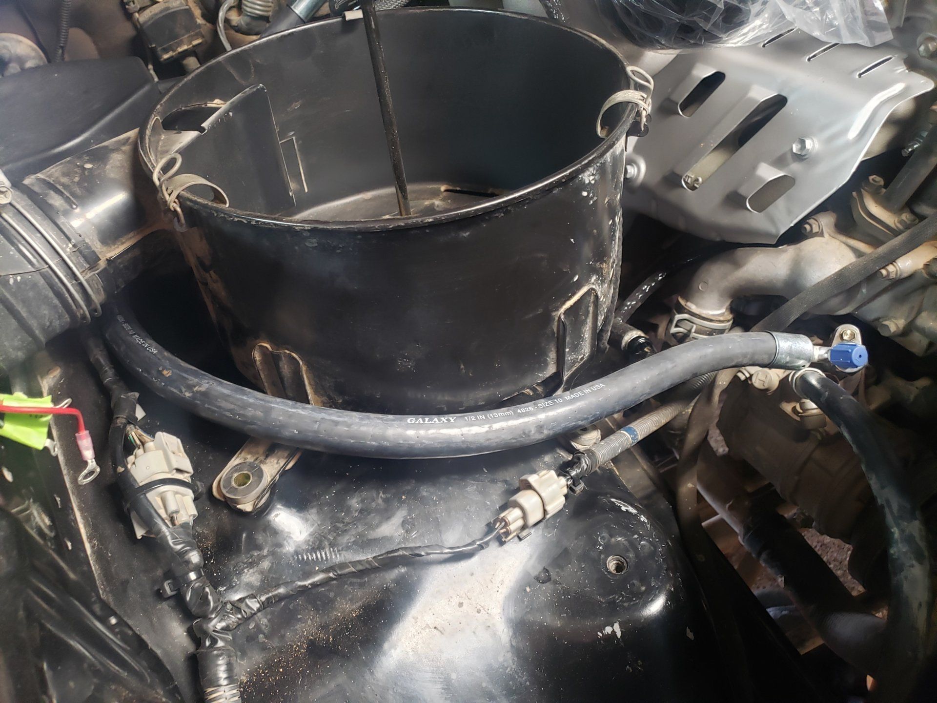

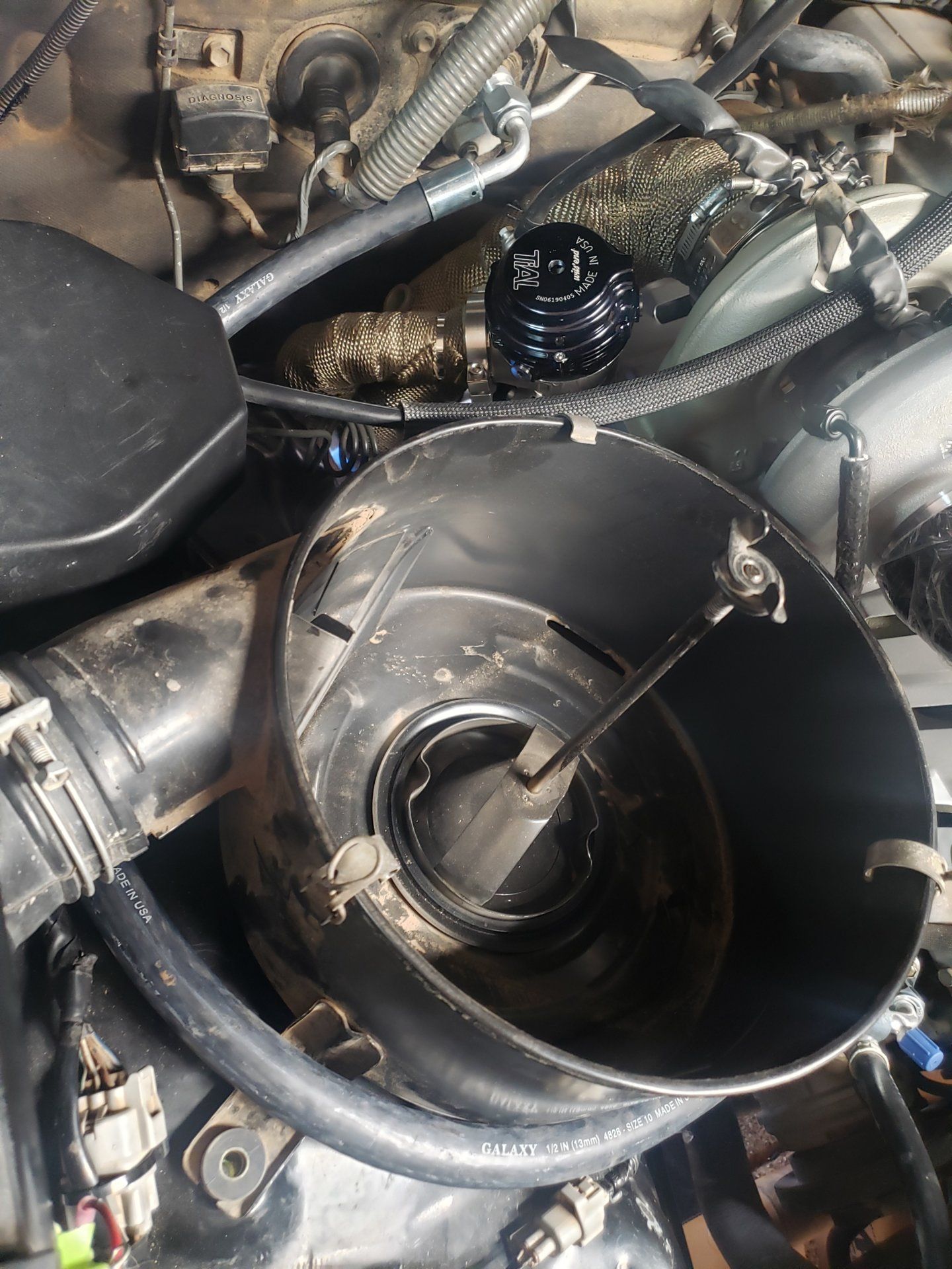

Test fit looks good! Just under 4 ft (1/2" - size 10 hose) does a perfect loop, 90° off of the firewall, under the cruise control box, around the stock air filter and between the 2nd batt box (if you have one) 45° fitting into the compressor! Just needs to be crimped, properly clamped down so it doesn't move and charged up for a leak check.

Did you by-chance have a typo in that Vintage Air P/N? I think 35883-VUG should be 35833-VUG. The one you list is a male fitting. The one ending in 33-VUG is female. Just confirming...

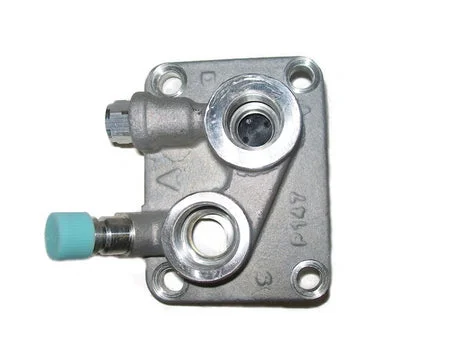

Since I found this thread so incredibly helpful, I thought I would add a bit more info that offers a different approach to solving the problem of re-routing or replacing leaking hoses WITHOUT GOING TO A SHOP. I have a 1990 HDJ81 and live in the middle of nowhere so I couldn't find a shop who said "YES I CAN DEFINITELY PRESS A NEW AC LINE FOR YOU" within a 3 hour drive! Also, I needed one re-routed due to adding a York for OBA and relocating the AC compressor so even if my hoses weren't NLA from Toyota I still couldn't use stock geometry anyway.
One of the easiest routes I found is to replace the entire manifold on top of the compressor with one that has more standard o-ring fittings; it's cheap too ($40):
This is a 10PA AC Compressor Manifold Fitting, obviously applicable to the 10PA15/10PA17s we use on 80s.
This eliminates the hassle of Toyota's specific adapters at the compressor, and the weird bends usually associated with them. Any AC shop will have components laying around to make hoses with o-ring fittings, and now there's potentially no brazing required.
