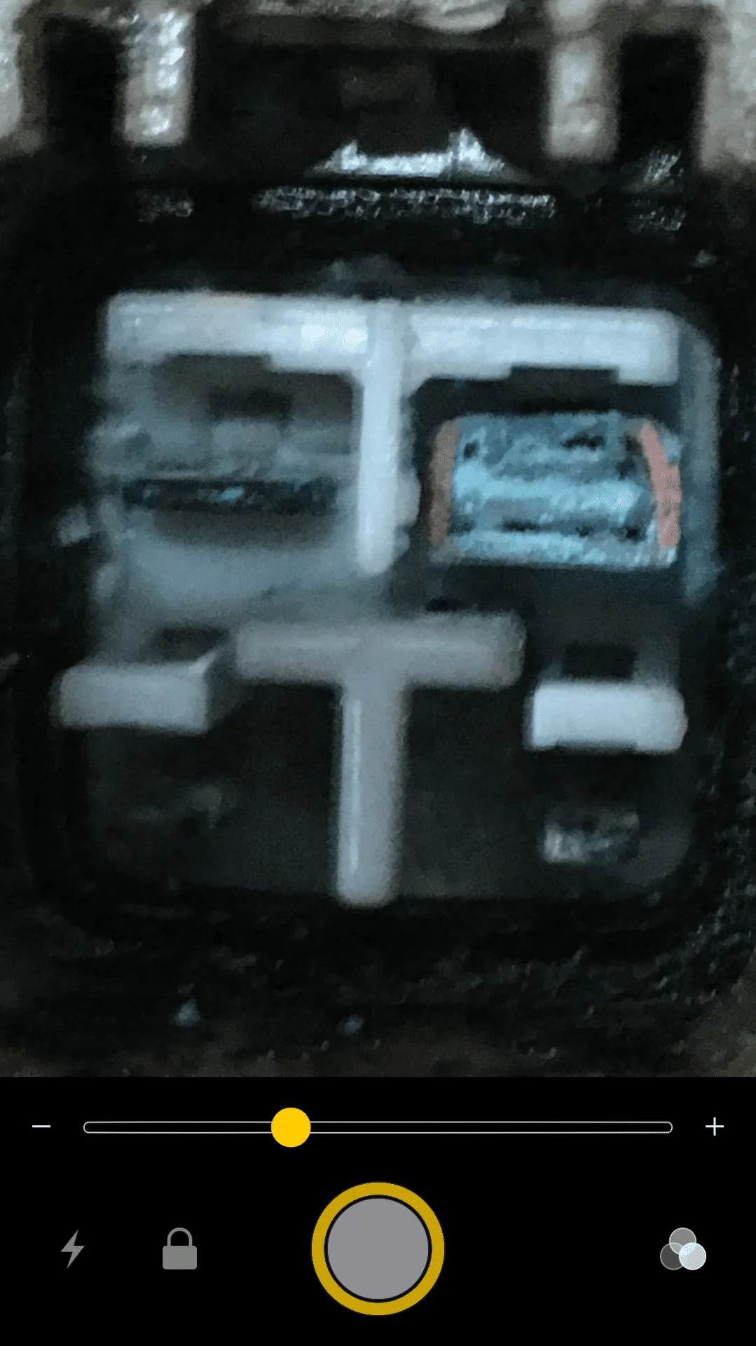

Retrieved the hidden cooling fan relay. This may be the culprit for my fan never working.
And I believe the brass prong from harness broke off. Not sure the remedy here.
I also hear something rattling inside as I shake it. Pretty sure I need another one.
Where is the fan relay?
If remember correctly, this was for my '99 LC. The relay is right below the driver's headlight. Go in beside front tire and washer reservoir.
