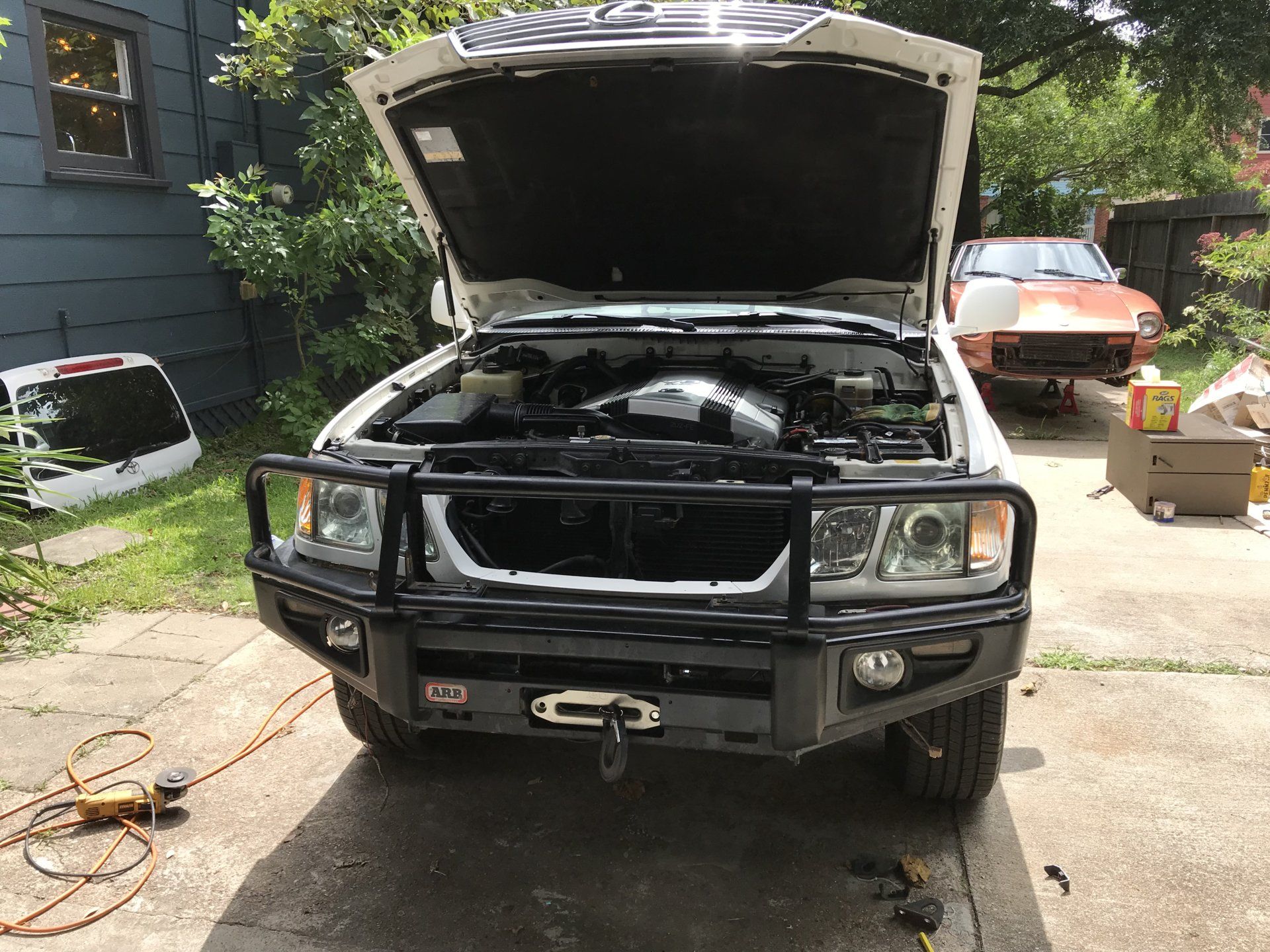

All wiring removed from the cruiser for dual battery, front locker and compressor and dual battery monitor along with the blue sea fuse block.
Front bumper on the LX with the new winch and it’s wired up and spoiled. It’s friggin hot. Quitting for the day. Basic clean up tomorrow in between work appointments then move to the shop to start doing suspension.
Perfect time to replace the ARB boat anchor with a proper @benc (Dissent bumper!!) 😉
