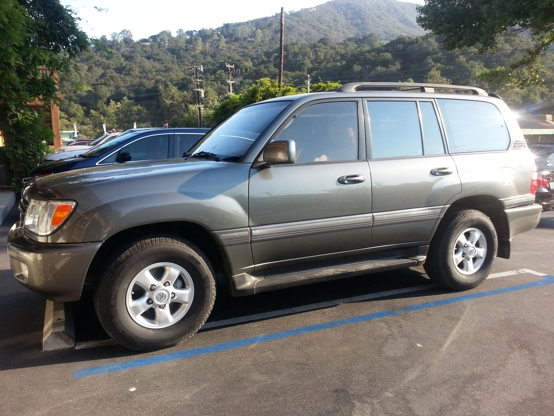

I purchased 2 LCs in the last week (long story & I'll spare you the details):
- 1999 with 107k miles in near-perfect condition (my favorite color, River Rock), recent timing belt done, new tires and shocks, garaged. Rear locker. Drives like a new car; crazy fun!

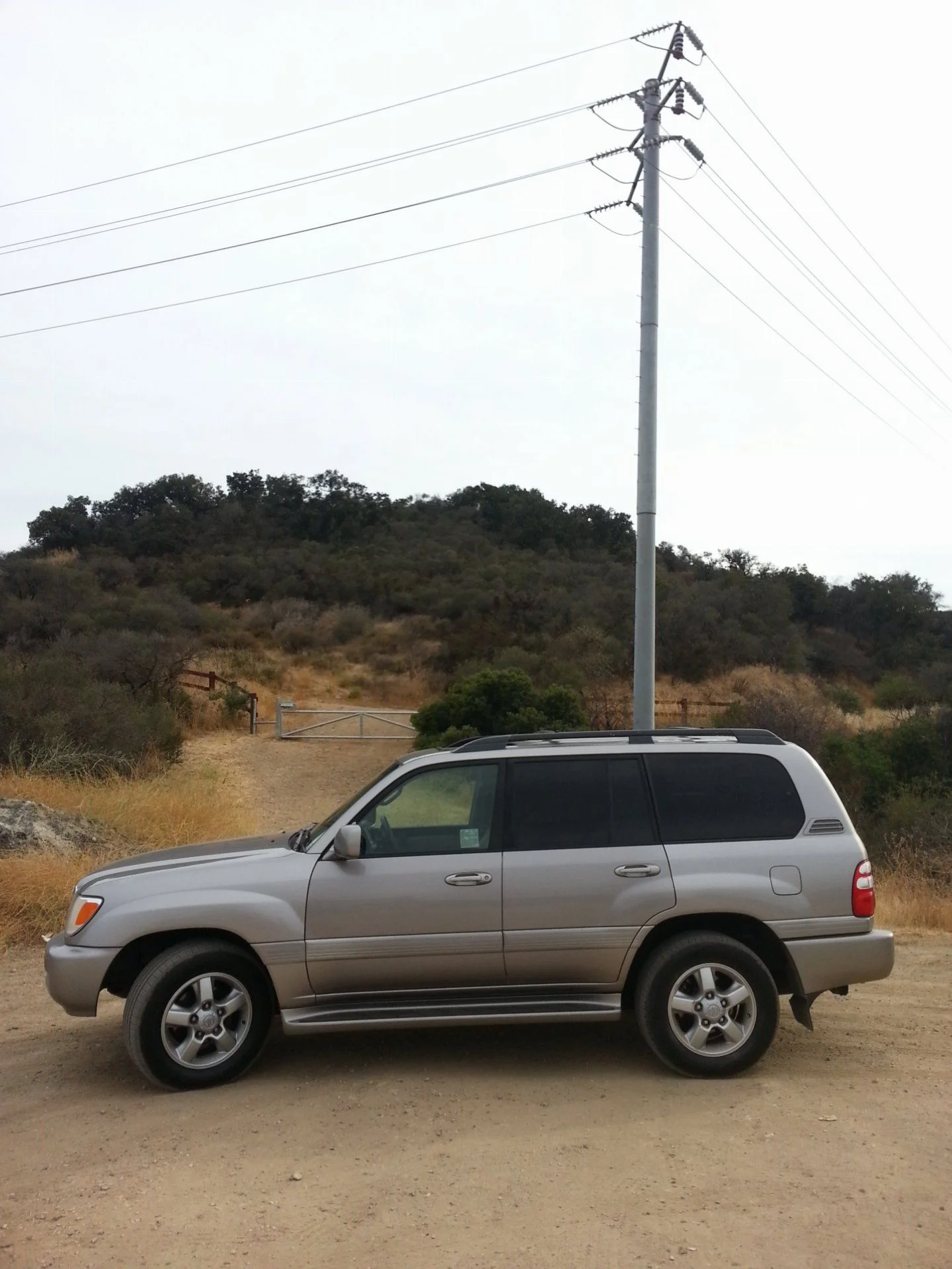

- 2004 with 169k miles in near-perfect condition, (Thundercloud) all services and recent timing belt done, new tires and brakes, garaged

Off road the 99 will have a rear differential locker, a nice feature for harder core off road. The differential locker is manual and proactive traction aid.
The '04 will have ATRAC which give almost the same capability as the locker and at all 4 wheels. ATRAC is passive and reactive traction aid. ATRAC functions whether in hi range or lo, center locked or not. What does turn off is vehicle skid control (VSC) when center is locked.

Don't forget, the 99 will have a 2-pinion front differential and the 04 will have the 4-pinion differential. No ATRAC on the 99 either. If it doesn't have the factory rear locker (optional, not standard) then it will be an LSD. I have a 98 LX and have been impressed with it's offroading capability. Granted, I'm no extreme rock-crawler/mudder, but mine scrambled up rocky passes in Colorado like it was nothing.

Is it just the lighting/shadows, or are the doors on the 04 slightly off color compared to the fenders?

Yeah, it looks weird in this photo. Likely those fenders were repainted by P.O. In daylight you can't see it but in this twilight shot you sure can. Has all its VIN stickers. I noticed the paint at night @ the dealership and nearly didn't buy it, but it has a seriously perfect service record. The P.O. was OCD attending to its maintenance schedule and replaced everything they reco'd.

Even the '99 has a repainted tailgate, but they did such a perfect color match you can only tell by touching the edges where the metal turns. River Rock is not an easy color to match, I'm impressed.

Pretty sure if it didn't have the 'optional' rear locker...then the rear diff will be 'open' (not LSD). On the same year model LX's...they have an LSD rear diff...with no locker available as an option.
Otherwise... the information you provided is correct. The 2-pinion front diff being the most concerning (if any serious off-roading is expected).
