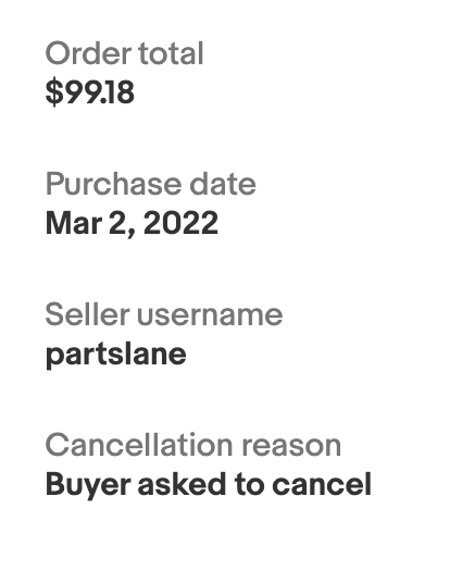

Still haven't received my refund yet. What about any of you that also got suckered by Amayama?
You didn't get refund from eBay or Amayama?
I ordered from eBay and I got that refund right away to my PayPal when they canceled the order.

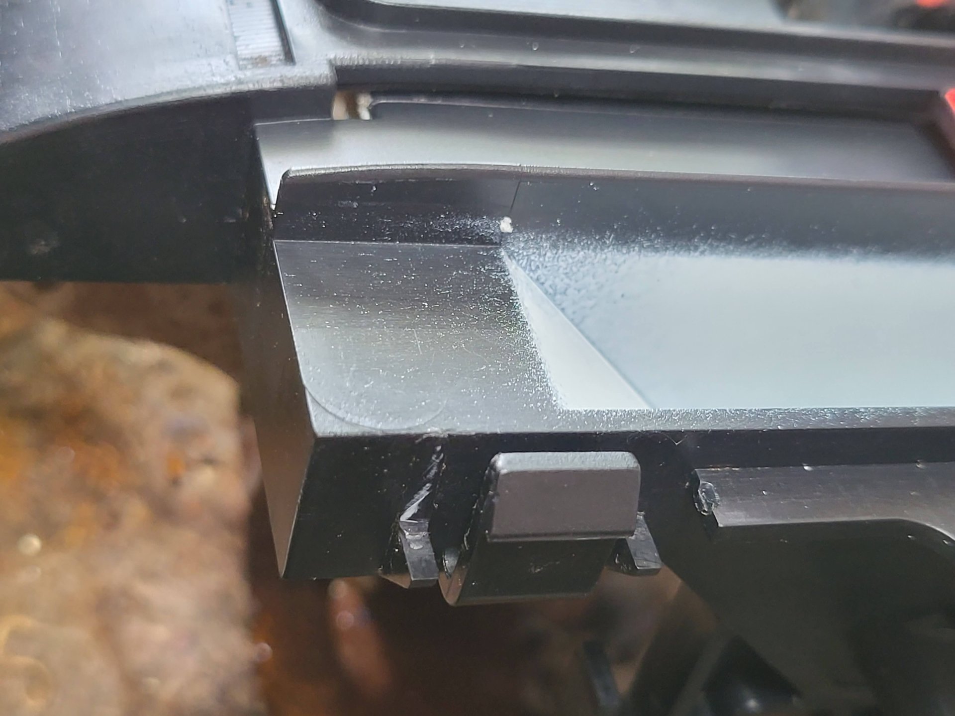

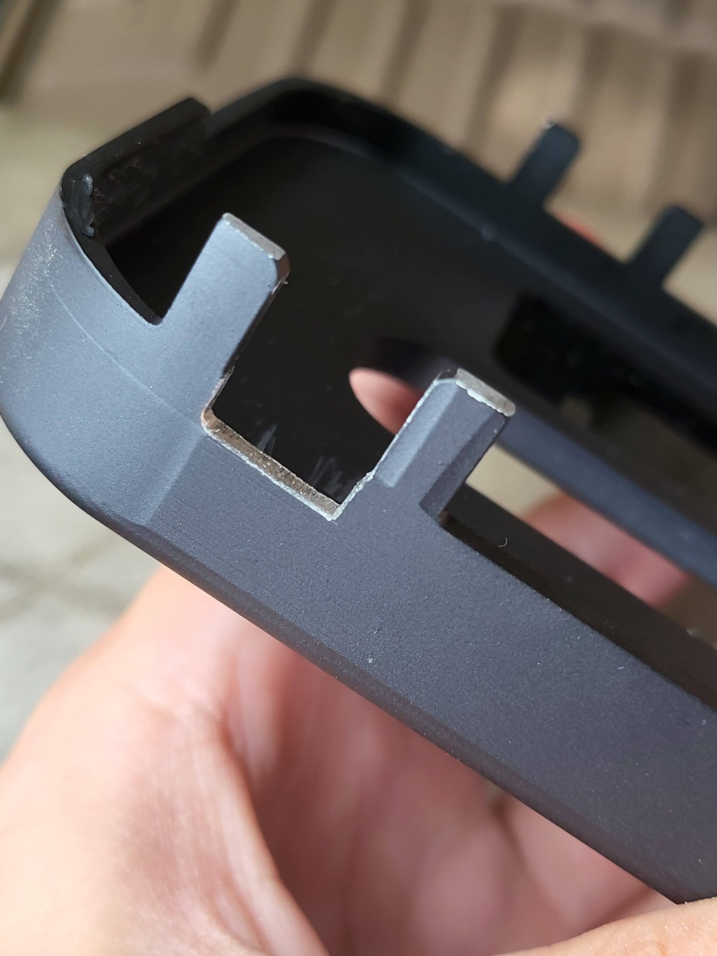

Update on the ZR Tactical shift plate. I was able to greatly improve the fit of my plate with a bit of modification. After comparing and measuring up the original plate and the ZR Tactical plate, I decided to file down the cutouts on both passenger side tabs. I also filed the tips down a little bit. This got the plate into a much better position. Fitment still isn't perfect, but it's much closer to flush now.
I also trimmed of the thin piece of plastic on the shifter to help the plate align better.
Still not sure I would recommend the ZR Tactical plate to anyone, but figured I would share my fixes for anyone who has.
