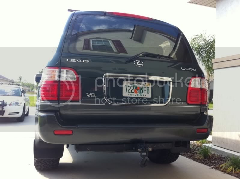

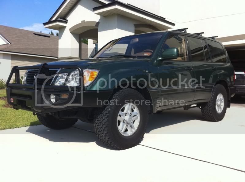

Guess I better start my build thread now. I've got pretty big plans for this one.
brought it home last weekend from ATL. Still trying to talk the CFO into keeping the 40...

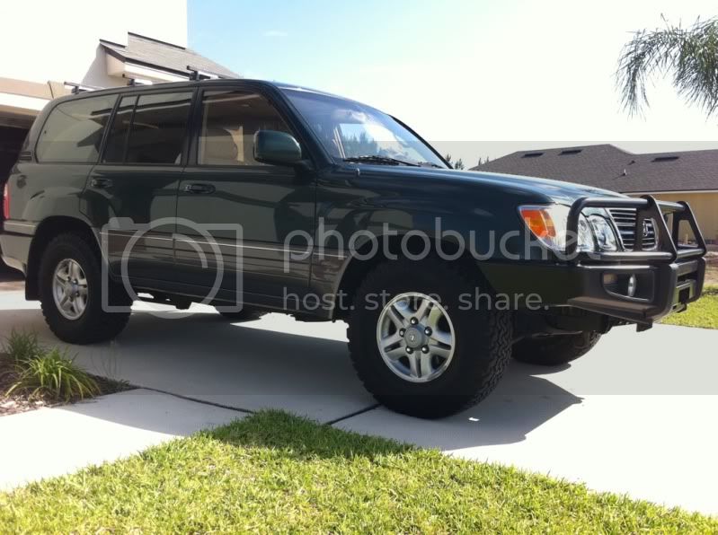

its in ridiculously clean shape, first owner drove this when it rained and he couldn't drive his Lambo... Second owner racked up 60k in two years commuting from GA to SC. It has 112k and still smells new inside. It has the AHC suspension, we'll see how long that lasts. no rubbing with the 305 BFG AT's in all modes. cant wait to get it offroad and baseline it.

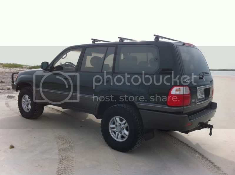

First trip to the beach, and it worked flawlessly.
It's got a pretty good rake to it, time to crank the Tbars.
no lockers or ATRAC, maybe a couple of ARB's in the future...

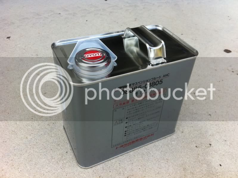

I was getting a periodic "OFF" blinking next to my AHC and the fluid in the reservoir was below the MIN level and looked like this
I could get the AHC fluid online for $30 but they wanted $10 a can to ship so I just picked it up at the local dealership for $41 a can the same day. I bought two jugs but only needed one.
This is the reason Toyota is number one, I want to put this thing in a display case its beautiful.
It only took about 30 minutes to flush and replace the fluid and I honestly didn't expect much, but its a noticeable difference in ride quality.

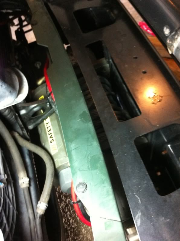

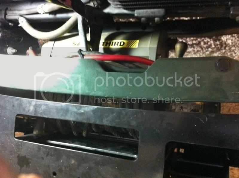

ARB said it couldn't be done and so did everyone else on the interweb, but they were wrong!
http://i80.photobucket.com/albums/j161/nickswan/af8e5d33.jpg
http://i80.photobucket.com/albums/j161/nickswan/cbf70bfc.jpg
yea, its a winch. but not any winch. look closer
http://i80.photobucket.com/albums/j161/nickswan/a9153d2a.jpg
looks like an integrated solenoid winch in an ARB
http://i80.photobucket.com/albums/j161/nickswan/45aa90c0.jpg
there is about 3/4" clearance from the cross member bolts and half an inch from the front fender brace that holds the Toyota Denso smoke detector. (WTF?)
http://i80.photobucket.com/albums/j161/nickswan/a4e313bc.jpg
http://i80.photobucket.com/albums/j161/nickswan/d7a5ae70.jpg
everywhere I looked online everyone said an integrated solenoid winch couldn't fit in an ARB and I needed to spend another $800. I picked up this winch about five years ago and its paid for itself a hundred times over, its a sealed waterproof 10k winch with an additional wireless transmitter as well. I had to use the hawse fairlead but I plan to go to a synthetic line in the near future anyway.
so for anyone else looking at an ARB but turned off by what they've heard about their integrated solenoid winches not fitting, measure first before you blindly follow everyone's advice, yours might fit too.
Obviously in a front end collision that solenoid is going into the crossmember, which is what I assume ARB is trying to protect people from by saying they wont fit. hopefully I wont find out.

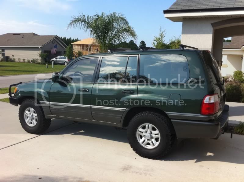

Are those 16" rims or 18? I like the look of those 305s. Also, what rack/crossbar system is that & how does it attach to the factory rail mounts? Nice looking rig.
Hi Nick,
they are 16" factory Lexus rims. The rack is ARB feet with 1" square tubing from a hardware store cut to fit and painted with hammerite spray paint. It works very well, and I think set the PO back all of $100. It will be replaced with a Gamiviti expo shortly and will be for sale if you want it.
