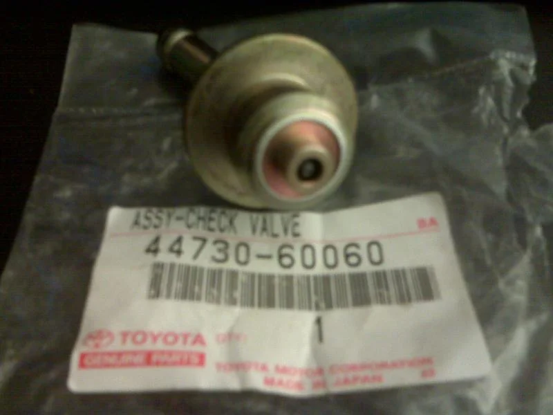

Well my friend has recently changed out this check valve assembly and had several days in the - 20 deg C range ( -4 deg F) and no more problems for now.
Hopefully this is the fix.

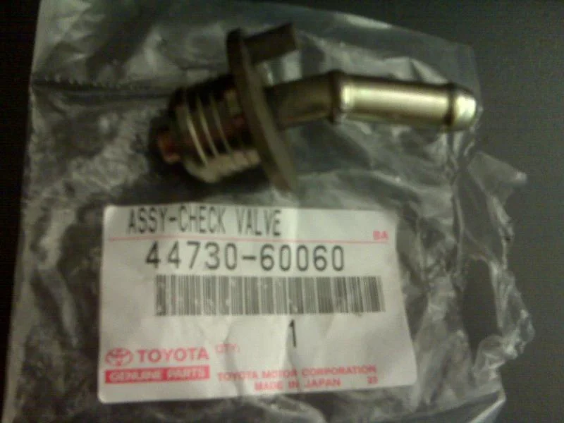

This removed check valve looks fine and I suppose I will hang onto it until next winter is over to see if it did fix the problem for sure. Then I might take it apart to see what is really inside this thing. There are at least 7 parts which look to be mostly pressed together made of at least 4 different materials.
Our 96 has never done this so I wonder if theses assemblies were different for newer model years or what.
What are the years of the vehicles you guys have experienced this with? 99, 2000 and any other years?
