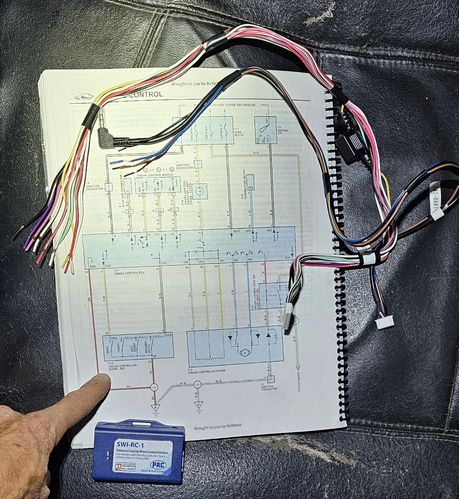

sbman, would you mind sharing how you wired your PAC-RC1 to the cruise control lever? I have the EWD infront of me and I understand how the cruise control lever functions (although my multimeter is not picking up any resistance between the Brown (20) and Black/Green (5) wire when the Cancel, Set, or Resume actions are pressed. I do get 1.7ohms between Yellow/Red (15) and Brown (20) when I press the On/Off button on the lever.). What I can't wrap my head around is what the PAC's dip switches do and where I need to land the LX450's wires to the PAC. I got your description above, but:
-Do I need to ditch the resistors built into the cruise control lever and build my own resistor bank?
-My PAC came with 2 wiring harnesses, from which harness do I tie the red, white, and black wires into?
-I have a Kenwood deck with a Blue/yellow wire, so that part is obvious.
I guess what I need is a pinout diagram of the PAC to understand where to tie my 97 LX450's wires into it, but I haven't found one. Any help would be appreciated!

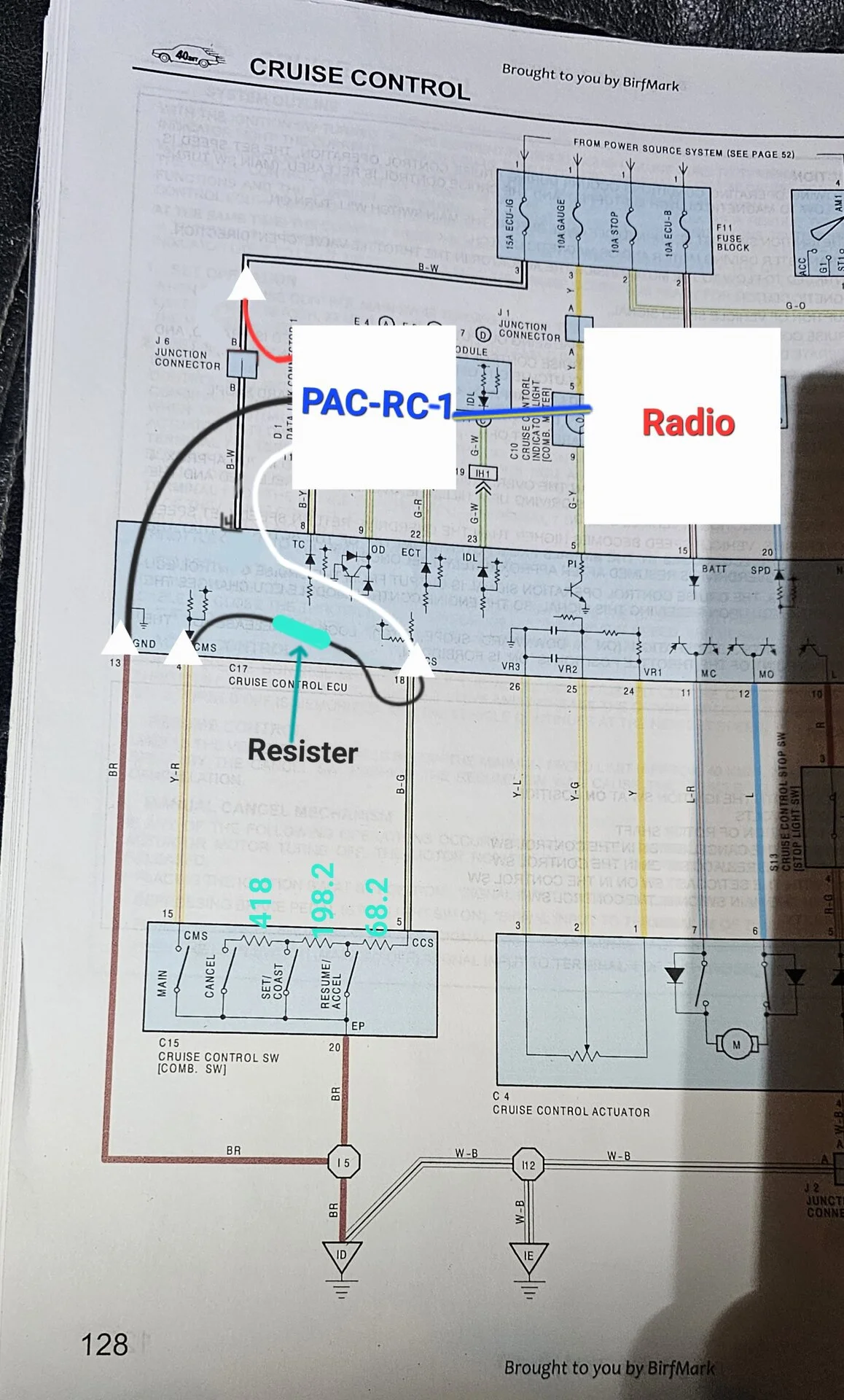

Here is a wiring diagram for my install
I connected the Black/Green wire to the White/Black wire on the PAC and Yellow/Red to White. You also need power and ground on the red and black, as well as the green/white connected to blue/yellow on your JVC. You definitely should be seeing resistance values between the Brown and Black-Green wires when you move the cruise control stalk. You must disconnect the wires from the cruise control, you cannot have it connected to both the PAC-RC1 and the cruise control at the same time.
The dip switches need to be set for your head unit, should be the same as mine. I've attached the PAC-RC1 programming guide that shows the DIP switch settings for JVC as well as the instructions to program the unit once you have it all connected.
I used a DPDT switch to switch between stereo control and cruise control. I could not find a Toyota switch that would do this, but I was able to take apart the rear heater HI/LO/OFF switch and modify it to to do the job, but that isn't an easy thing to do and I don't recommend it.
It's been working great for me and I rarely need to interact with the touchscreen. I programmed up/down to be volume control, pull back to be next track and the push button on the end of the stalk to be 'Voice Dial' which in Android Auto mode initiates the 'OK Google' function so I can send text or start navigation, get directions, etc...

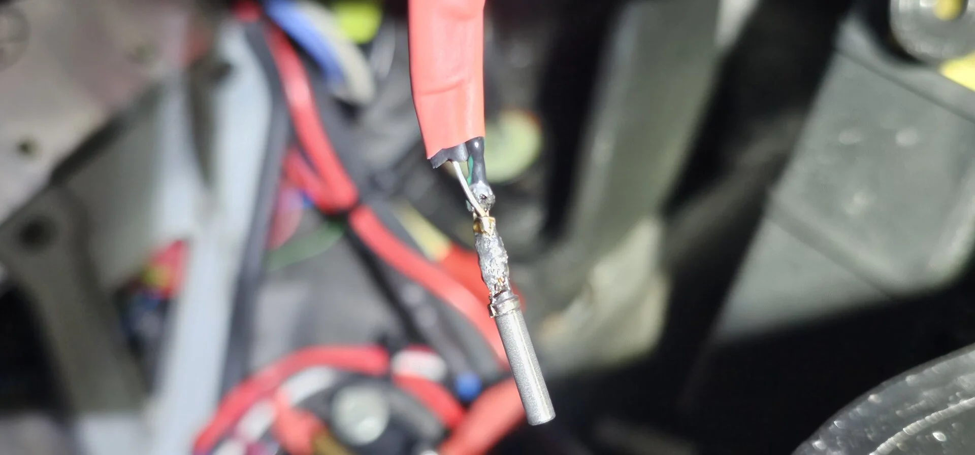

Here's an update. I was able to get this to work! The reason I wasn't getting any resistance between the Brown and black/green wire was because the pin underneath my steering wheel was bent and wasn't making contact. I bent it back, plugged back in the cruise control lever, and i was getting resistance. Attached is a schematic of how I wired the control and some pictures to go along with it.
-I have a Kenwood stereo with a blue/yellow wire. Other brands might might not have that wire. You might have to connect to your stereo with the audio jack. The PAC website can tell you how to do this.
-There are two sets of dip switches on the PAC. The 4 bank tells the control to which stereo it needs to communicate.
-I don't know exactly what the 8 bank of dip switches does. I left all those switches off.
-If you want to use the On/Off button on the CC lever, you need to add a resister. I don't think it matter what resistance it is as long as it different that the other three values. The values of each lever action is on the schematic and the picture. I used a 3.3ohm resister for the On/Off button because I had one lying around.
-I wasn't able to get the long press functions to program, I don't know why. Maybe it has something to do with that 8 bank dip switches.

You don't need to add a resistor. You can connect the Yellow/Red wire directly to the PAC-1 on it's white/black wire. The PAC-1 has two analog inputs and it watches them both all the time, one on it's white wire and on on the white/black wire so you don't need a resistor on that connection. The other dip switches are to set the PAC-1 for a particular car's resistor network, so if you have a car that has actual stereo controls built in, you just set the switches for 'FORD' or whatever so that it knows what vehicle it is connected to and you don't have to program the PAC-1.
I am able to use the long press and short press controls on my install with no issues. The short press needs to be quite short, like typing a key on a PC keyboard. You might be programming all 'long' presses, the long press isn't very long at all.
If you add a switch to move the wire connections back to the cruise control, you can easily use the stalk for both systems. Mine works great that way.
