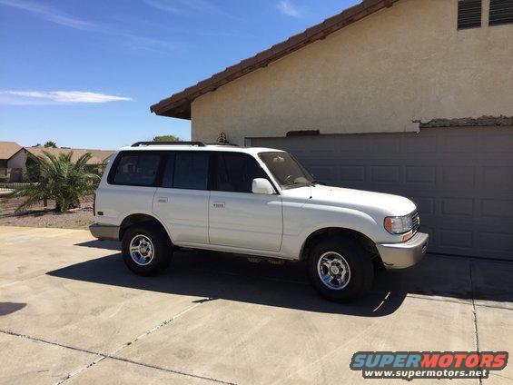

I was looking for an 80 series for a few months while I was in the process of selling my 2001 Tacoma. I was looking for a clean low mile 96 or 97 in white. I found this 97 LX450 for sale on here in southern California. The only thing it didn't have was lockers but I really like the look without the fender flares, plus it was white and only had 118K miles. I decided the lockers could always be added later on down the road and drove to California and trailered it back. The interior is immaculate and the exterior is not to bad either. It's been repainted and wasn't as good as I was told over the phone but it's still pretty decent.

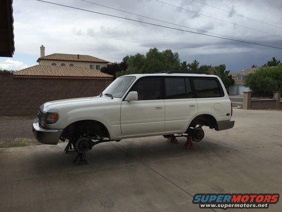

The chrome on the stock wheels was flaking pretty bad. After some time trying to find a set of wheels I liked I decided I would just stick with the stock ones and get them sandblasted and powdercoated black. It was much cheaper than buying 5 new wheels! While I had the wheels off I spent a couple hours with the pressure washer getting the 20 years of grease/oil and road grime off the undercarriage and engine compartment.

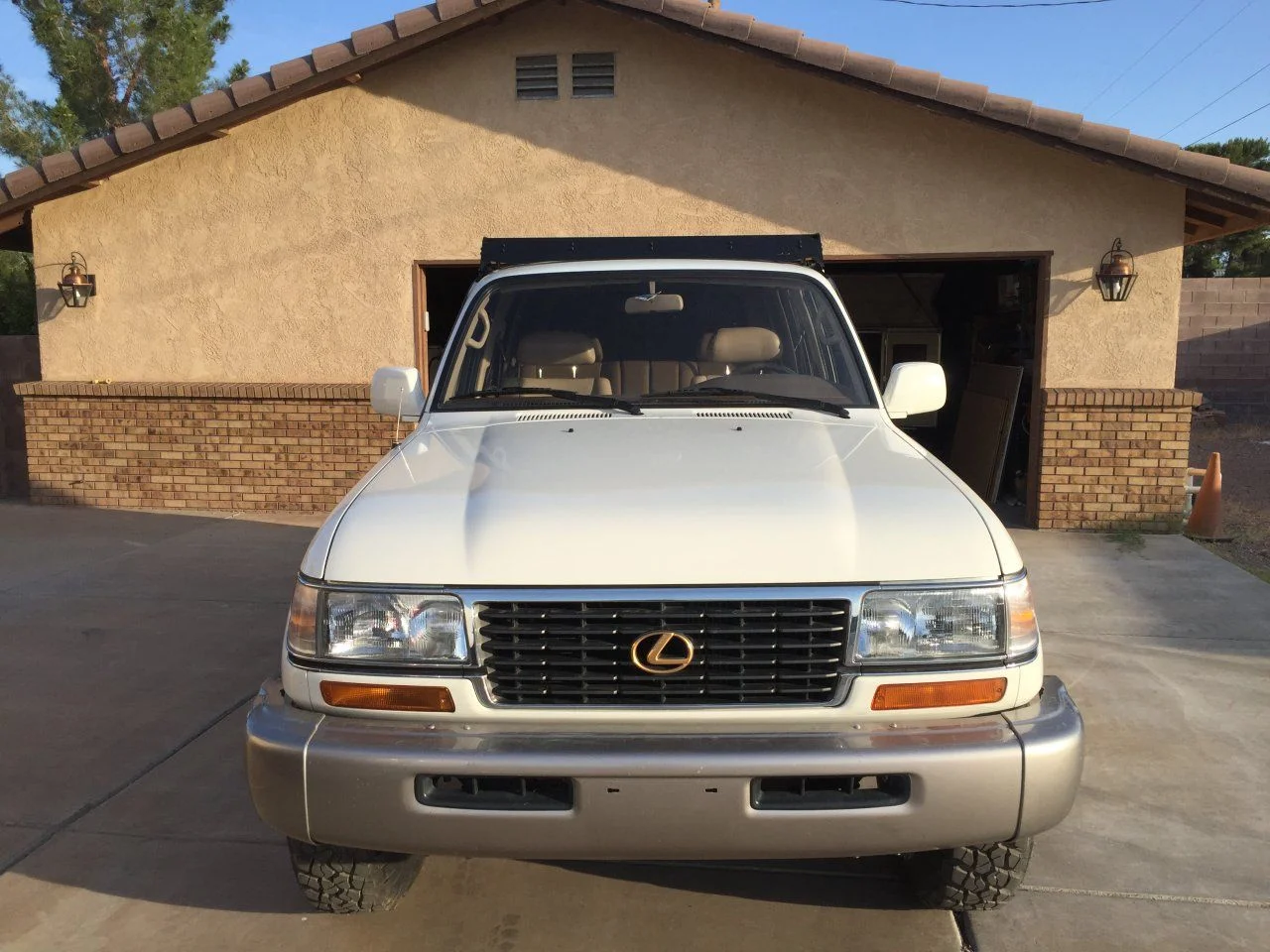

I also found a good deal on some new BFG KM2 255/85/16's on ebay. I ran these tires on my Tacoma and was really happy with how they performed. Plus there about 1/2" taller than most of the 285's measuring in at 33.3" tall, not to mention they are lighter. Since I'm trying to get by without regearing I think they will work out well.
The new tires and Prinsu roof rack awaiting install.

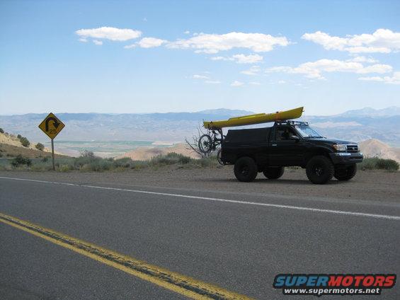

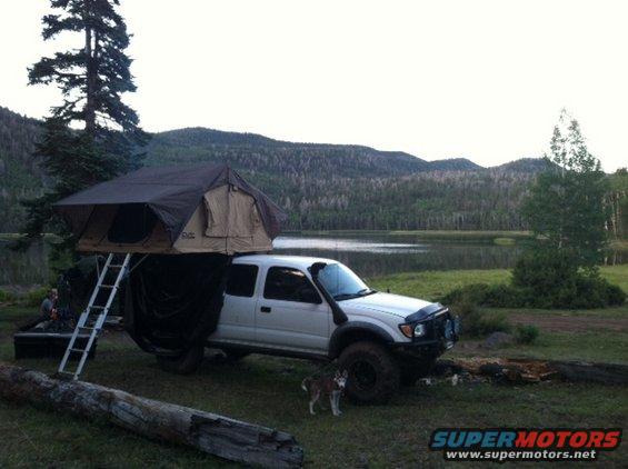

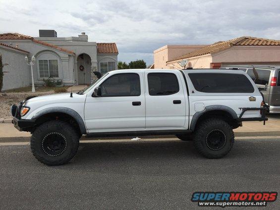

The 2001 Tacoma I have talked so much about. It was originally built by Will from Sierra Expeditions. It was a great truck but with myself, the wife and 3 dogs the cab just wasn't big enough for all of us. I needed a big SUV!

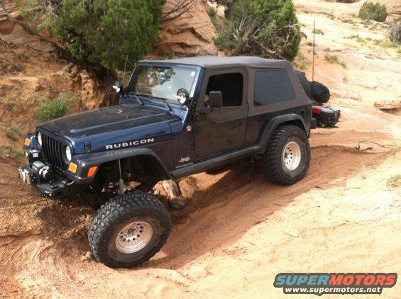

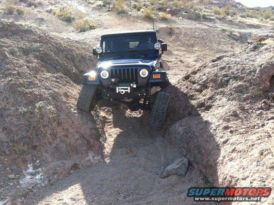

Uhh it's not a Toyota but it was pretty nice... for a Jeep... It was just way to small!!!

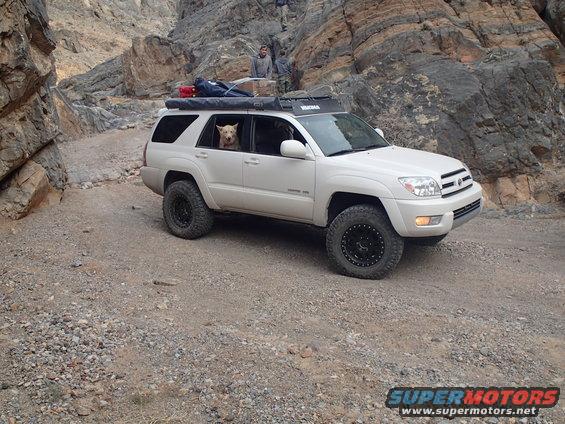

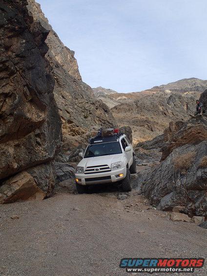

2003 4Runner. This one didn't last long, the lack of a tailgate drove me nuts!

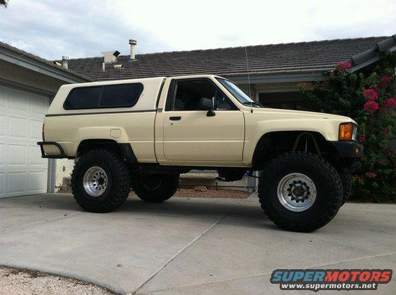

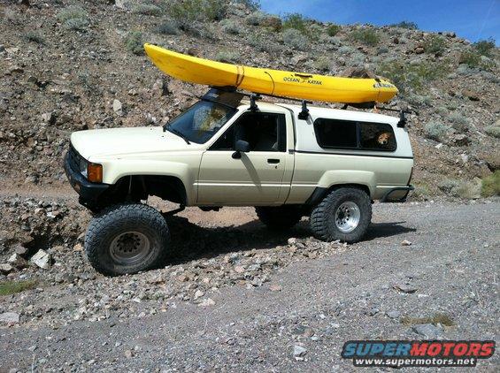

1985 SR5 Pickup. I regret selling this one...

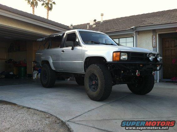

1987 SR5 4Runner

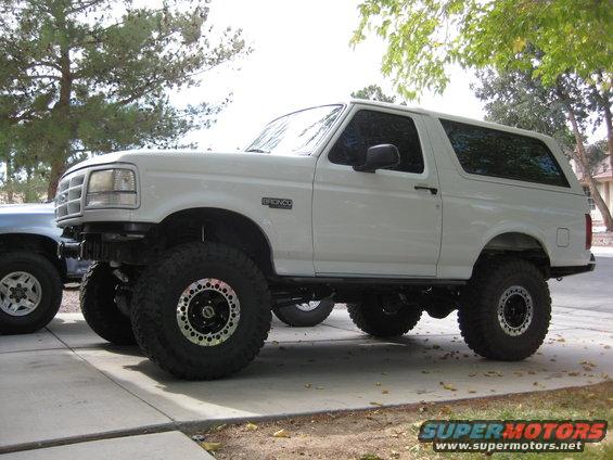

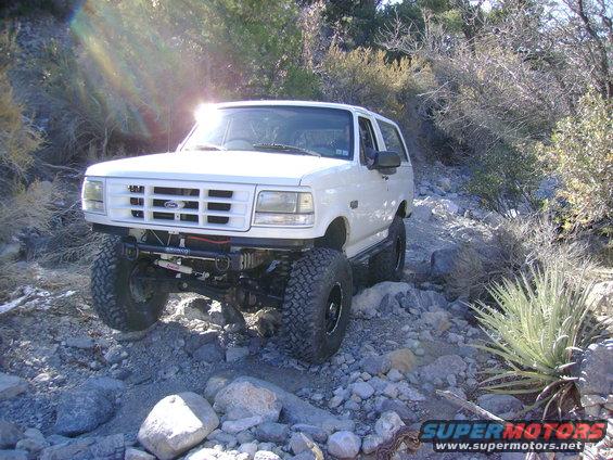

1996 Bronco. Where the addiction started! I regret selling this one as well...

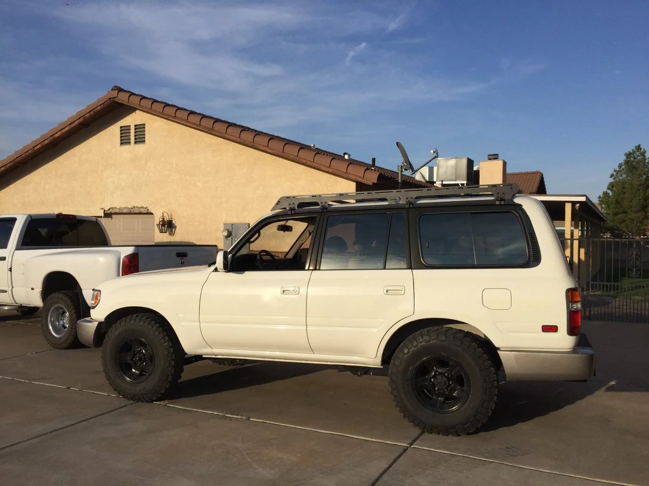

Got the wheels and tires mounted up. Also got the Prinsu rack and ARB drawers installed. I received my 4x4 labs front and rear bumper kits. Probably won't start those until the weather cools off!

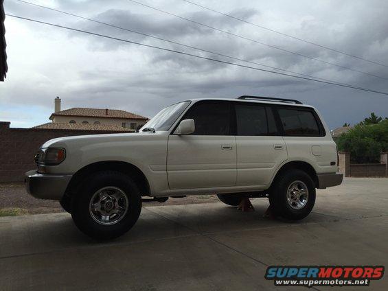

I installed the lift this weekend. I added some pictures to the Autocraft thread in the redline vendor section. I will add some more to this thread in the next couple days. Stock height OME and icon or fox shocks was my second choice and had I known it was going to take 6 months to get the autocraft kit I would have gone with the OME. However after installing the kit this weekend I'm glad I waited. I don't know how the OME springs ride but these springs ride really nice. I haven't had it off road yet but I have a bunch of dips in my neighborhood and I hit a couple of those at about 25-30mph and it soaked them up really nice. The springs ride nice and soft, not harsh at all. The best part is the shock length is perfect for the spring length. At full extension of the shocks the springs stay seated and at full compression there's about 1" of shock shaft exposed. So it's dialed in pretty good. If Justin @ redline can assure you he has a complete kit on the shelf then I would definitely spend the extra $ on the autocraft.
