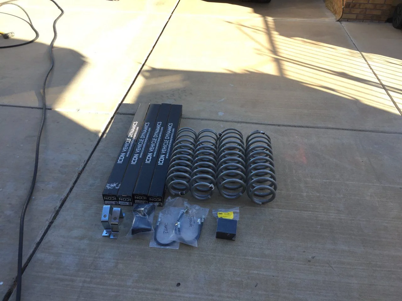

New parts awaiting installation

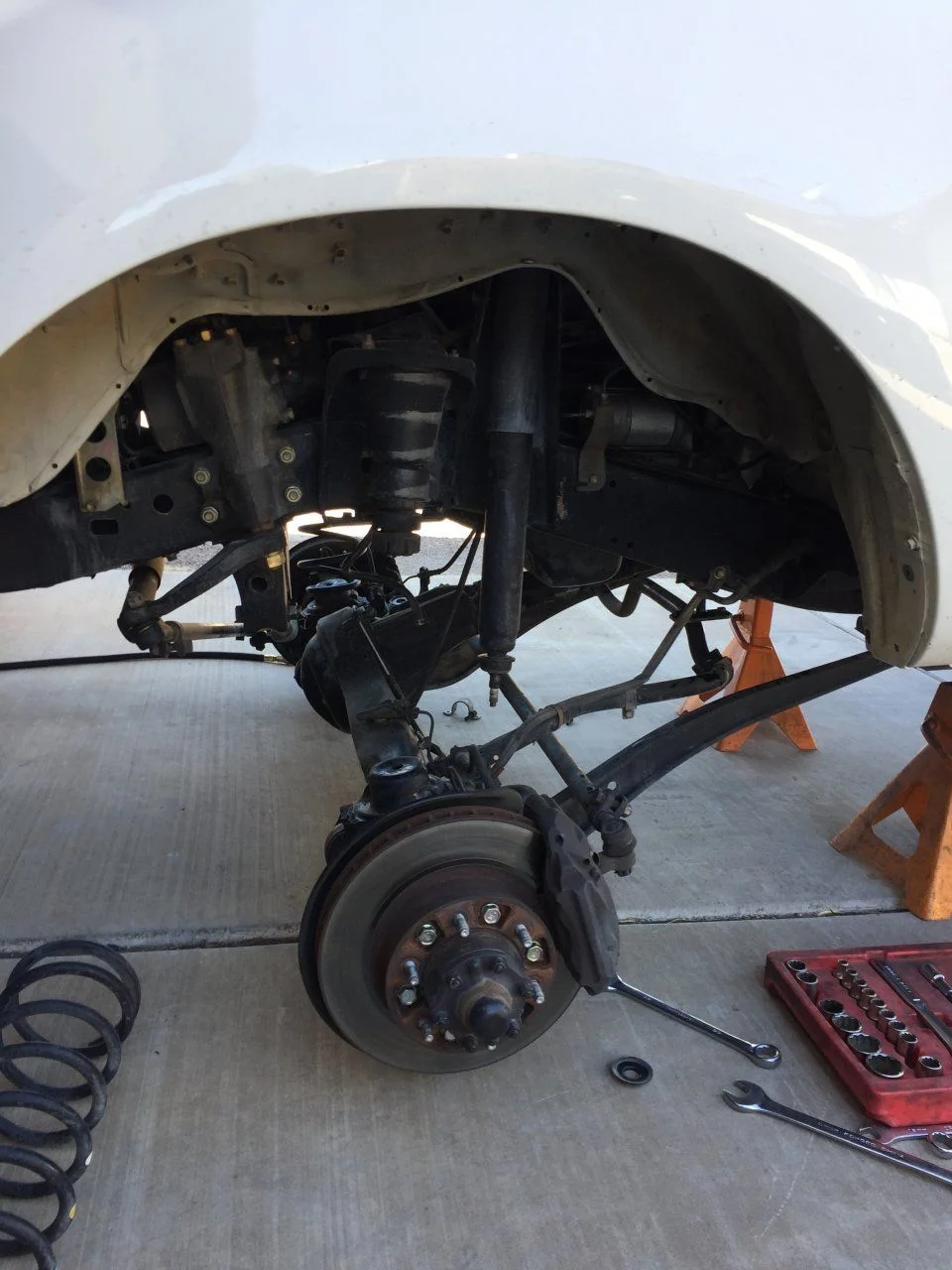

Rear shocks, springs, sway bar drop brackets and longer bump stops installed. I loosened up both track bar bolts and all 8 control arm bolts to let the suspension droop. Made installing the new springs a breeze. I tightened everything back up once the tires were back on and it was sitting on the ground.

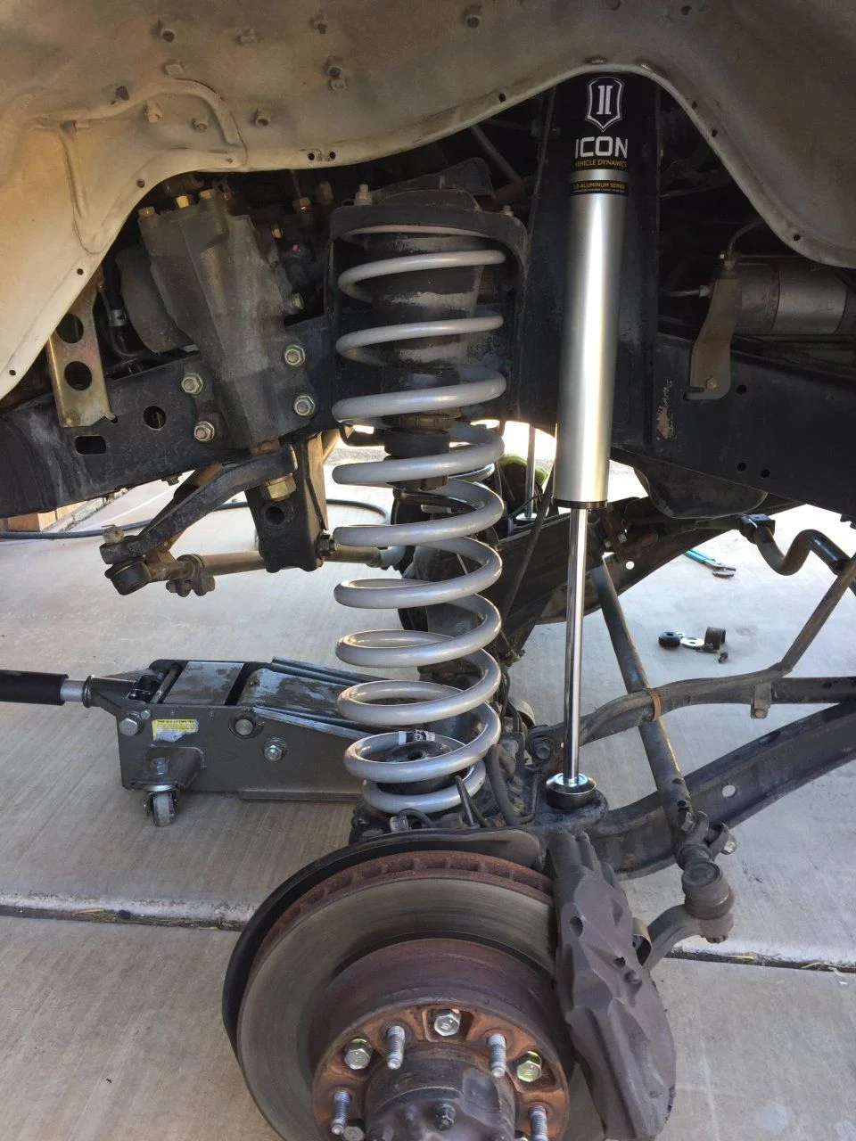

Front springs out. Again I loosened up bothe track bar bolts and the 2 frame side radius arm bolts.

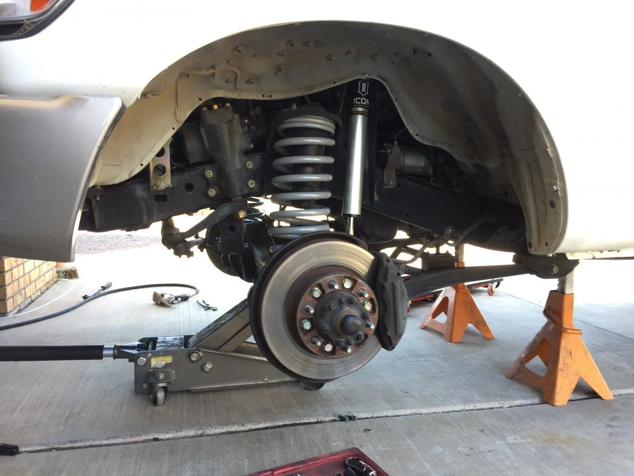

The kit didn't come with any provisions for longer front bump stops so I wanted to make sure the shock wasn't going to bottom out before hitting the bump stops. This pic is with the weight of the vehicle on the bump stops. About 1" of shock shaft exposed, doesn't get much better than that!
This is full drop. The spring is still fully seated.

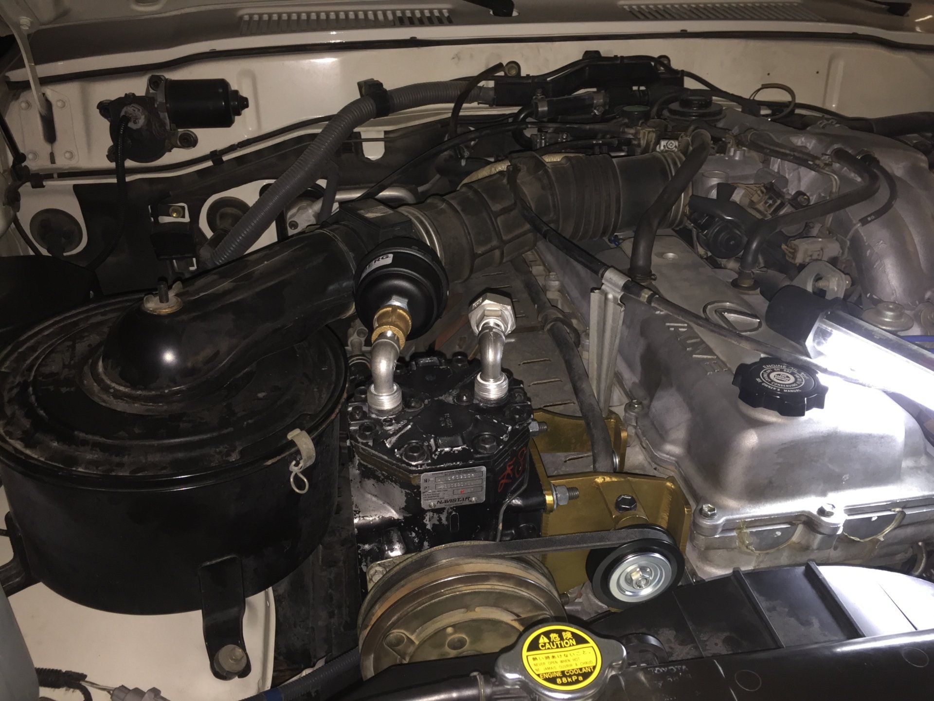

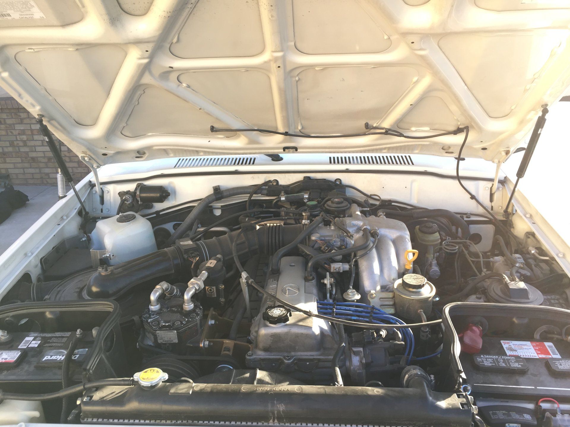

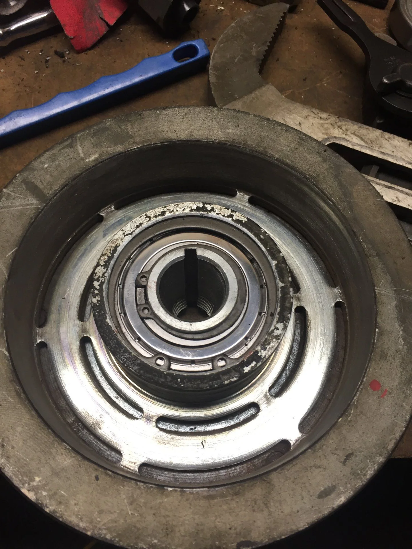

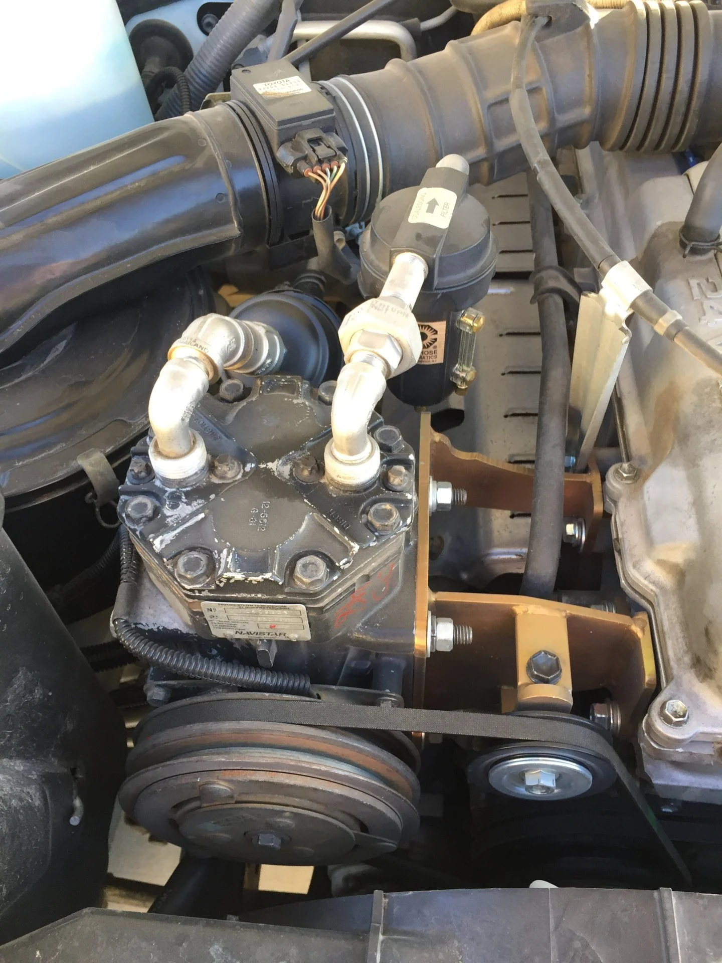

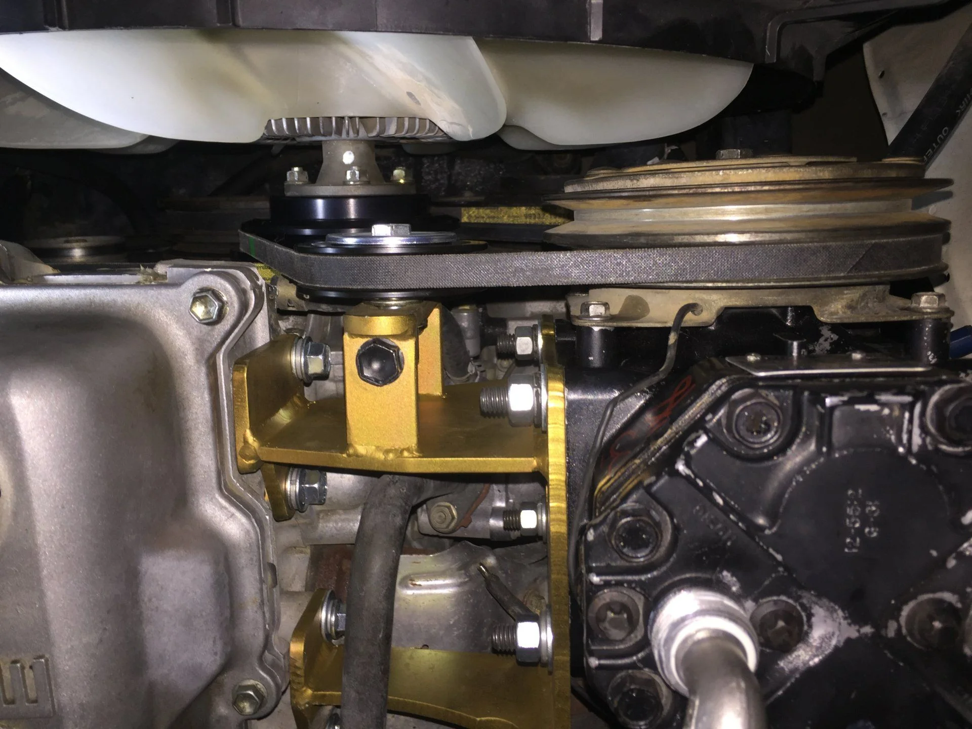

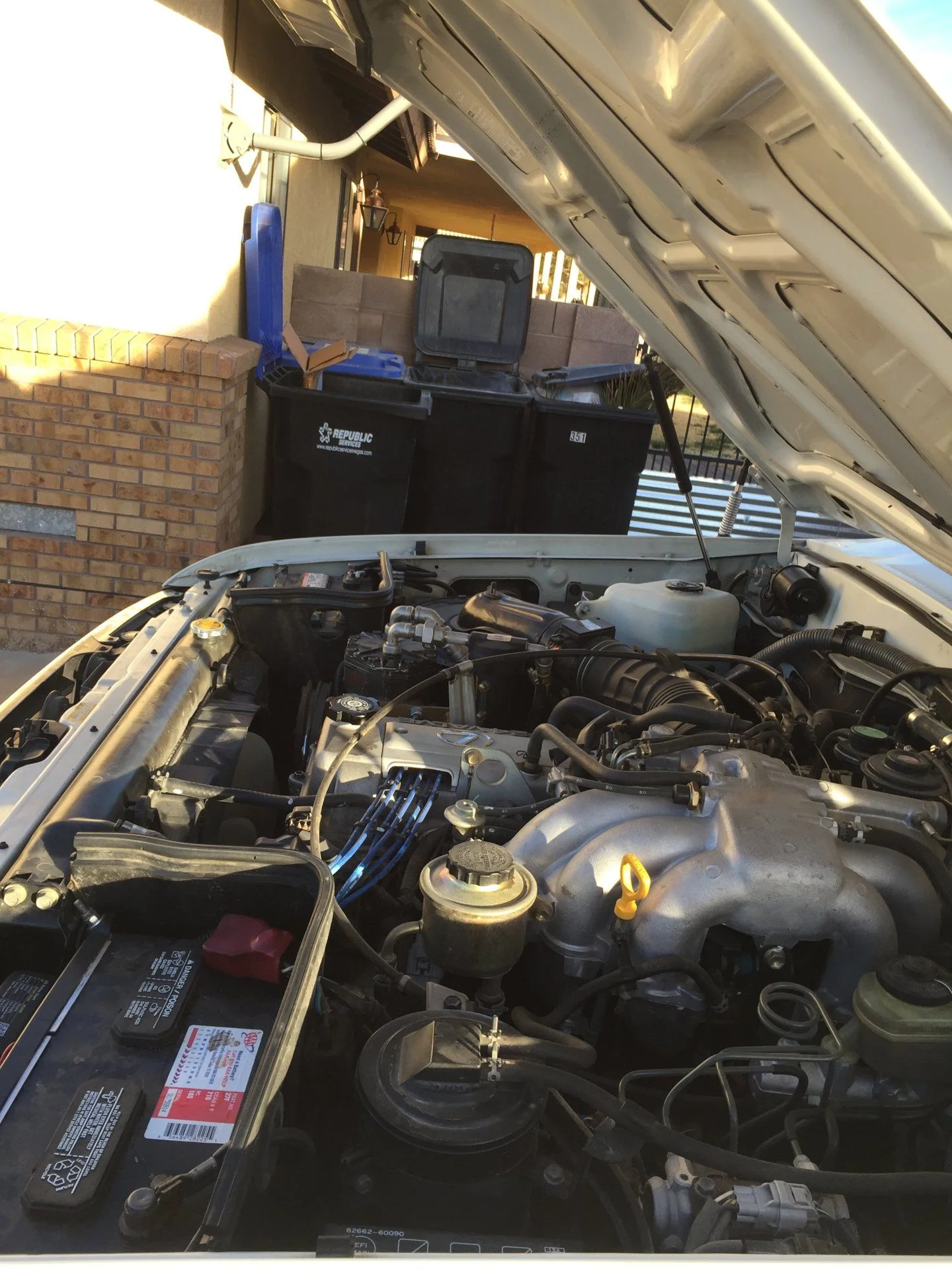

A couple pictures from the York 210 OBA install. Fills the tires up nice and fast!
Picture of the distribution manifold with the pressure switch, pop off, gauge and quick connect coupler. For now the switch is just wired in the engine bay. I also replaced the bearings in the clutch assembly.

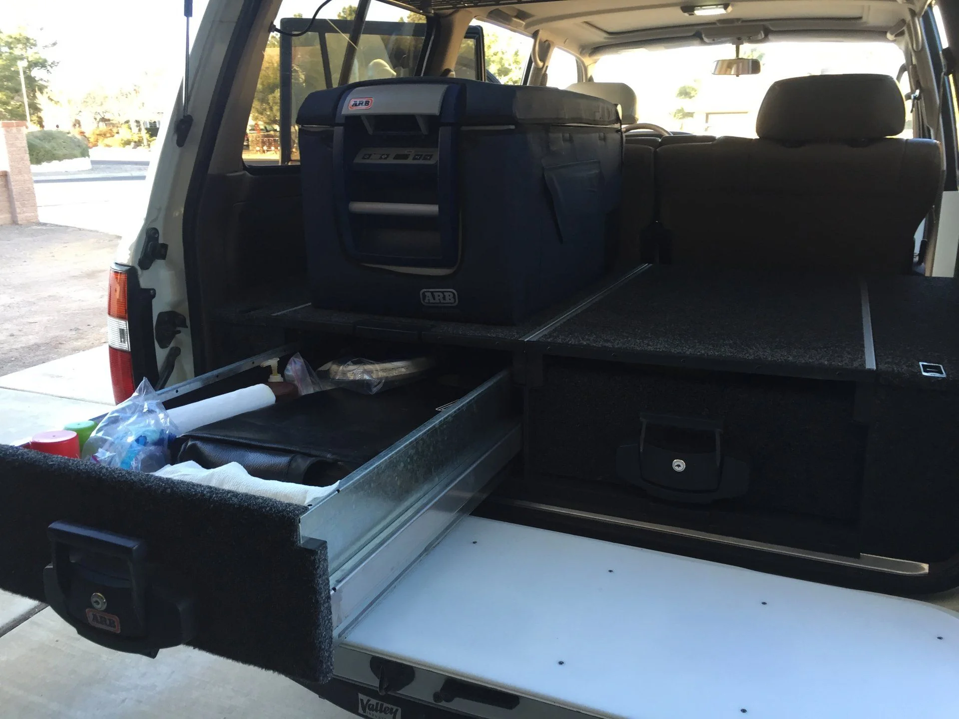

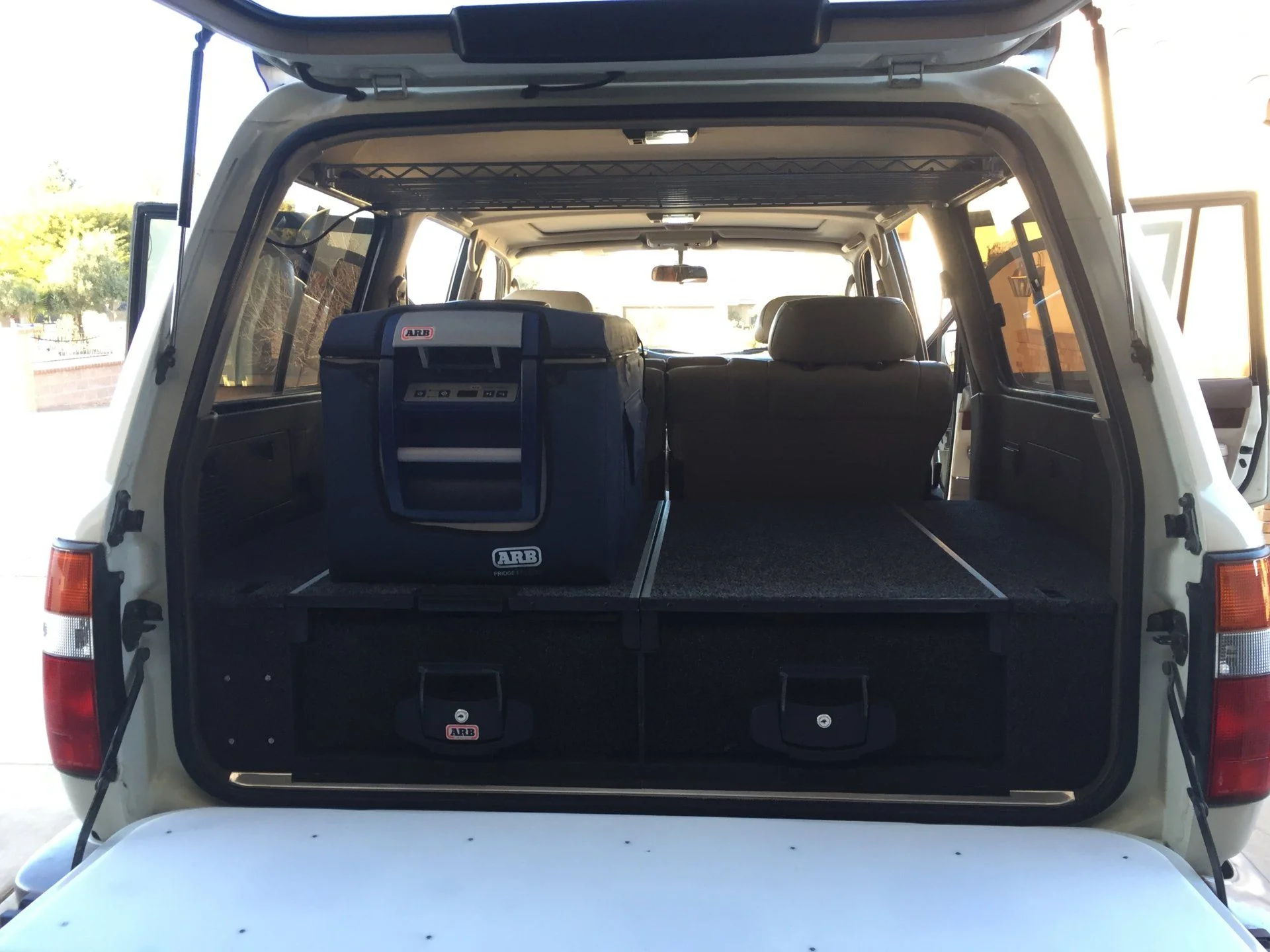

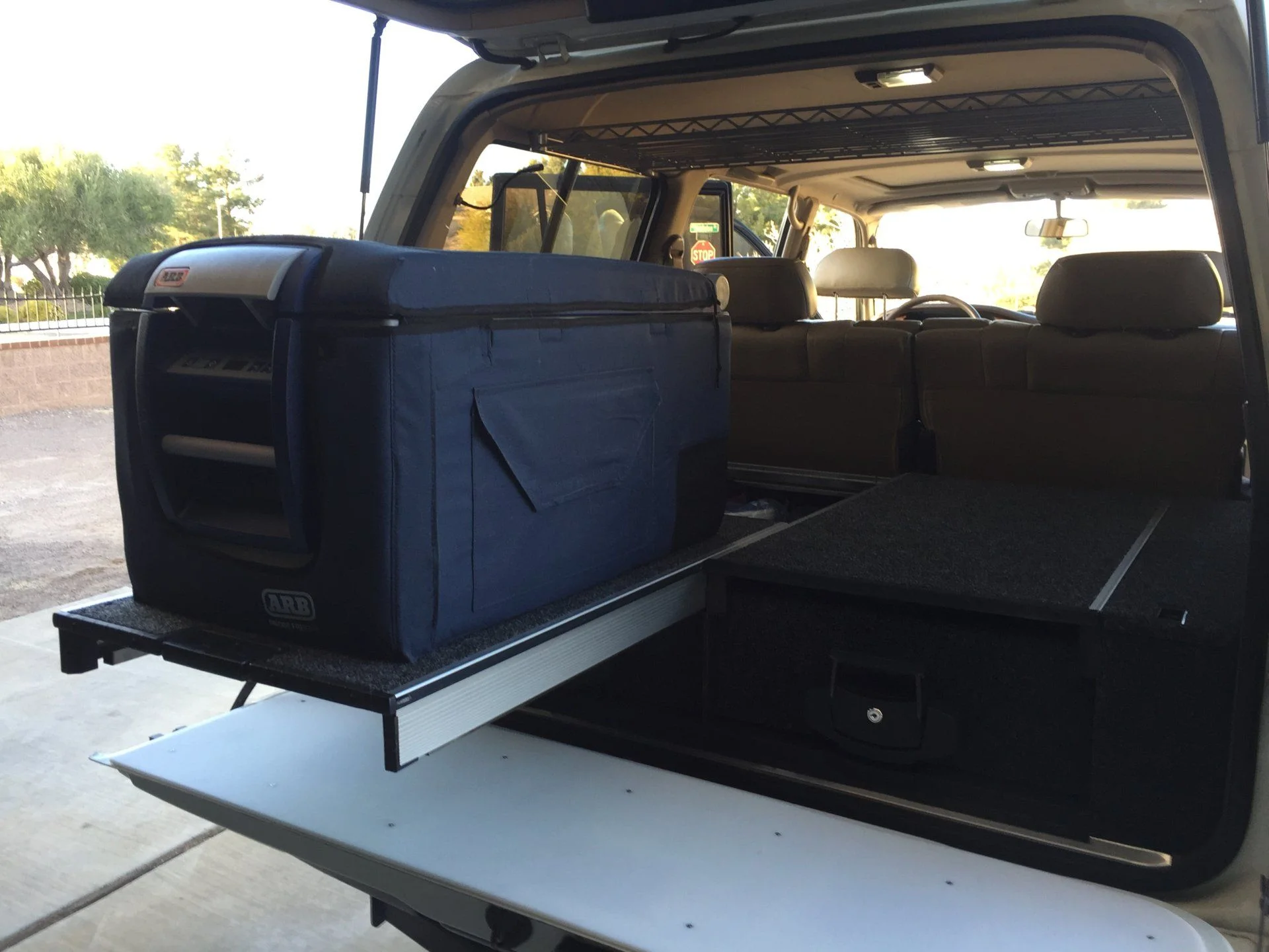

Arb 63qt fridge with transit bag. Also visible is the cruiserparts tailgate cutting board.

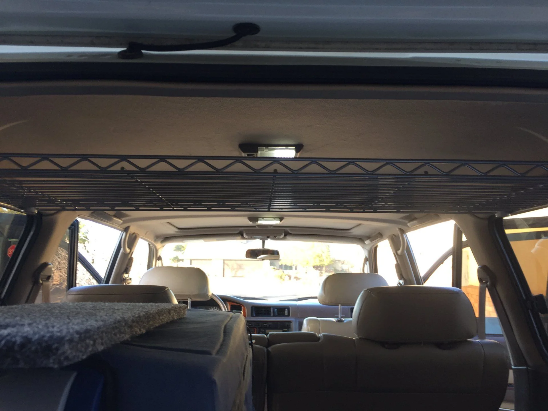

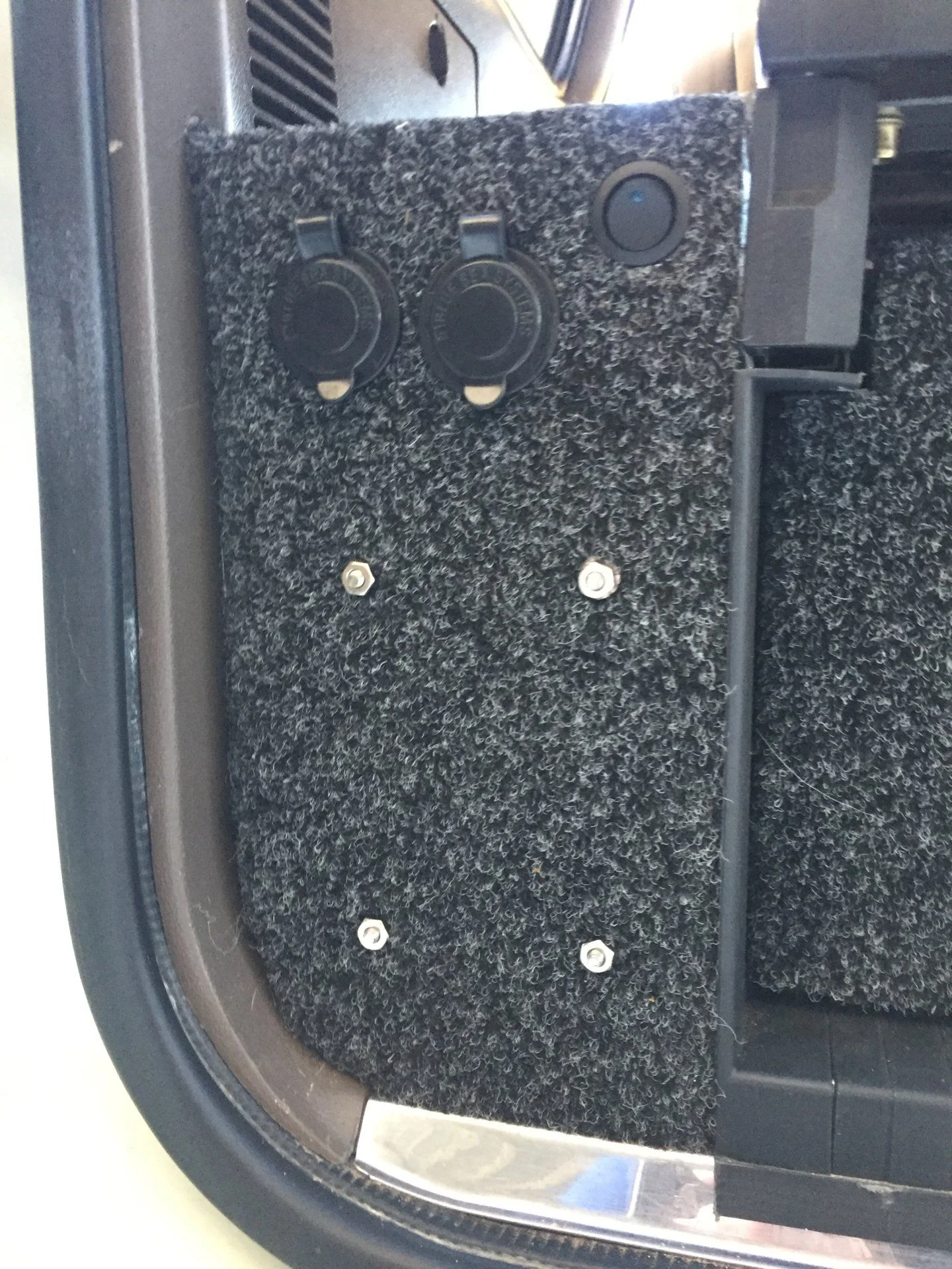

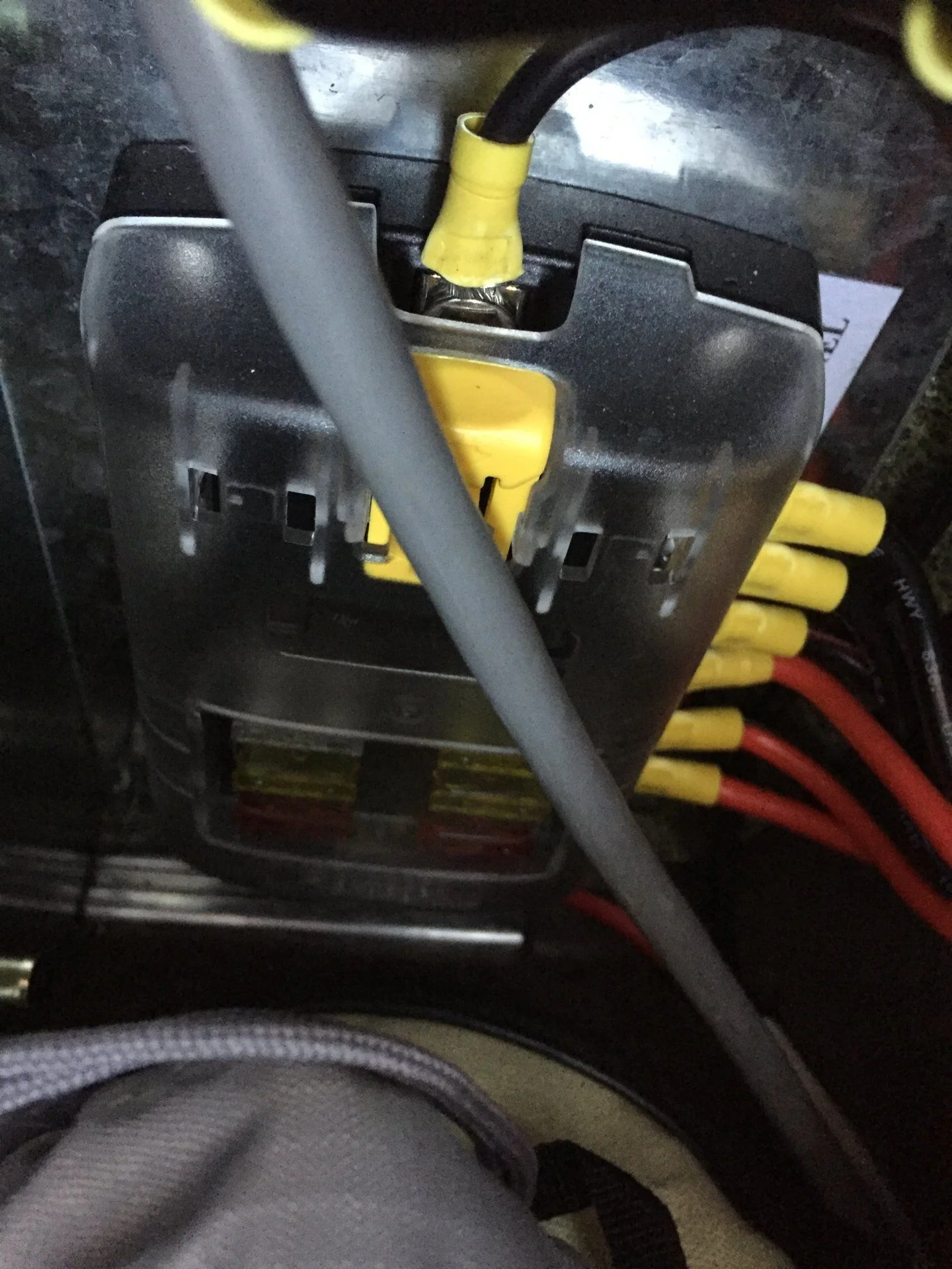

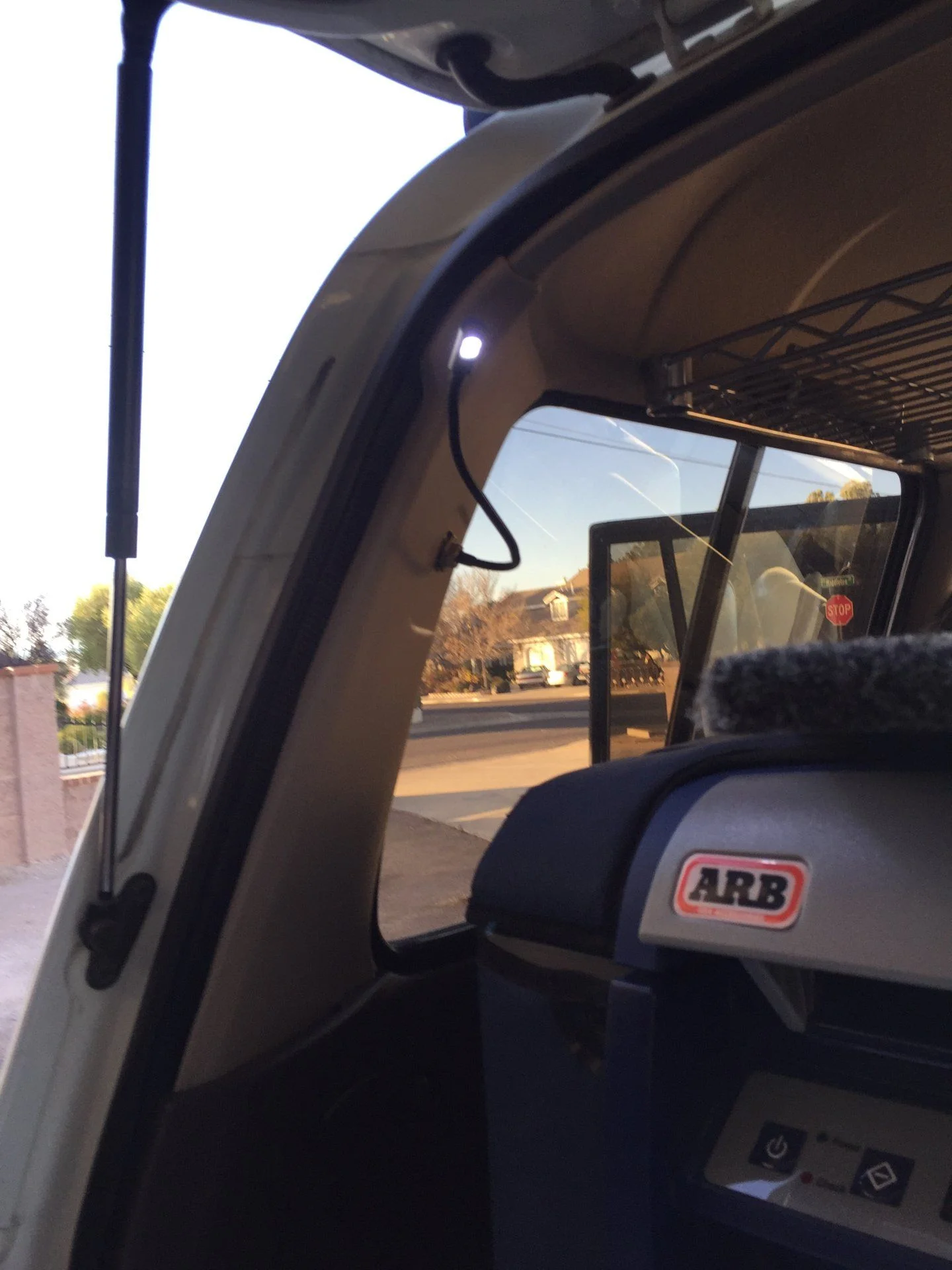

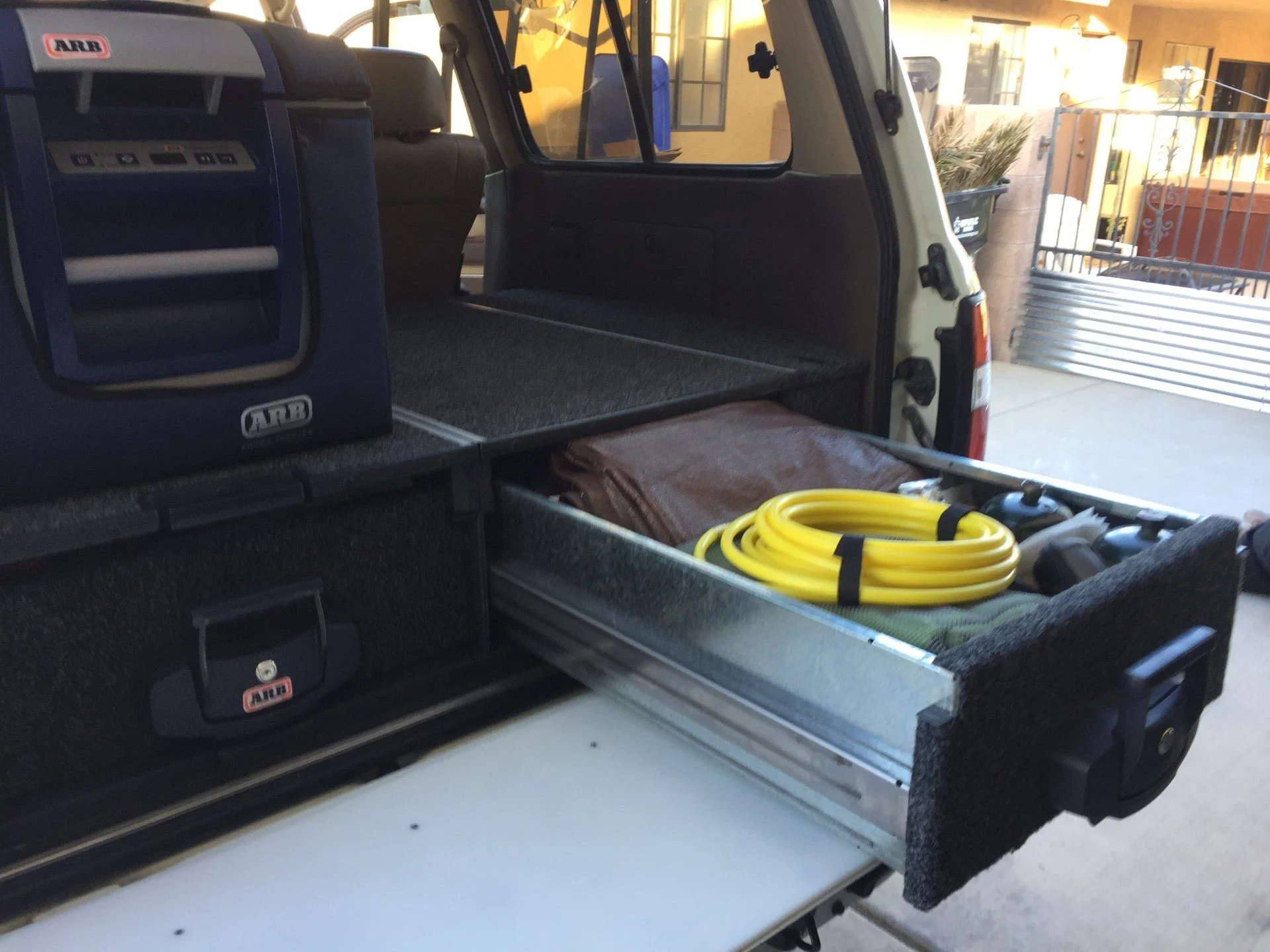

I added a blue sea fuse panel in the rear on the drivers side. It’s hidden in the little drivers side arb drawer cubby hole. It provides power to the led work light and 12v outlets mounted to the drawer panel. You can also see the $20 container store attic rack that I added a while ago. Comes in handy!

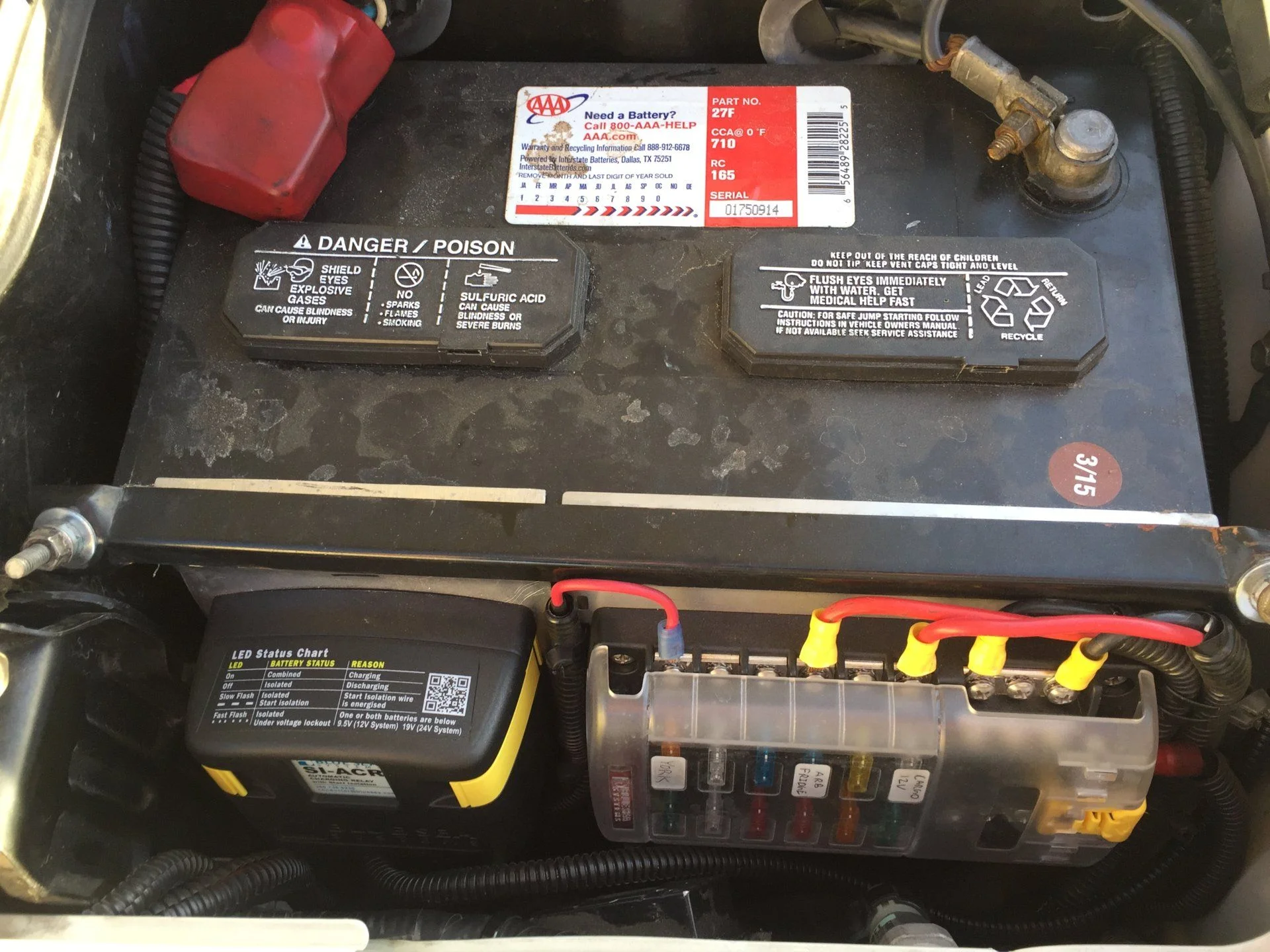

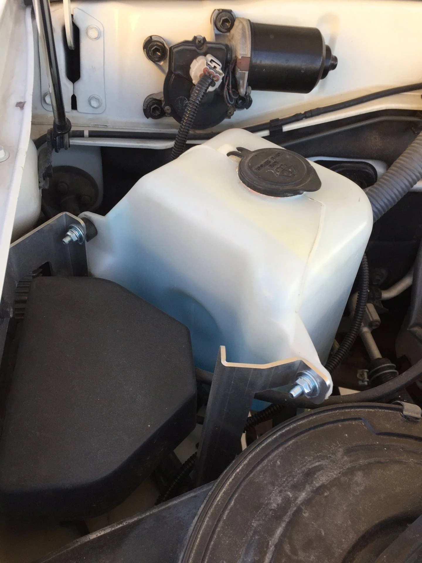

Dual battery setup using factory Toyota passenger side battery box, slee windshield washer relocation bracket, blue sea fuse box and automatic charging switch. All the rear 12v outlets, led lights and fridge are off of the house battery.

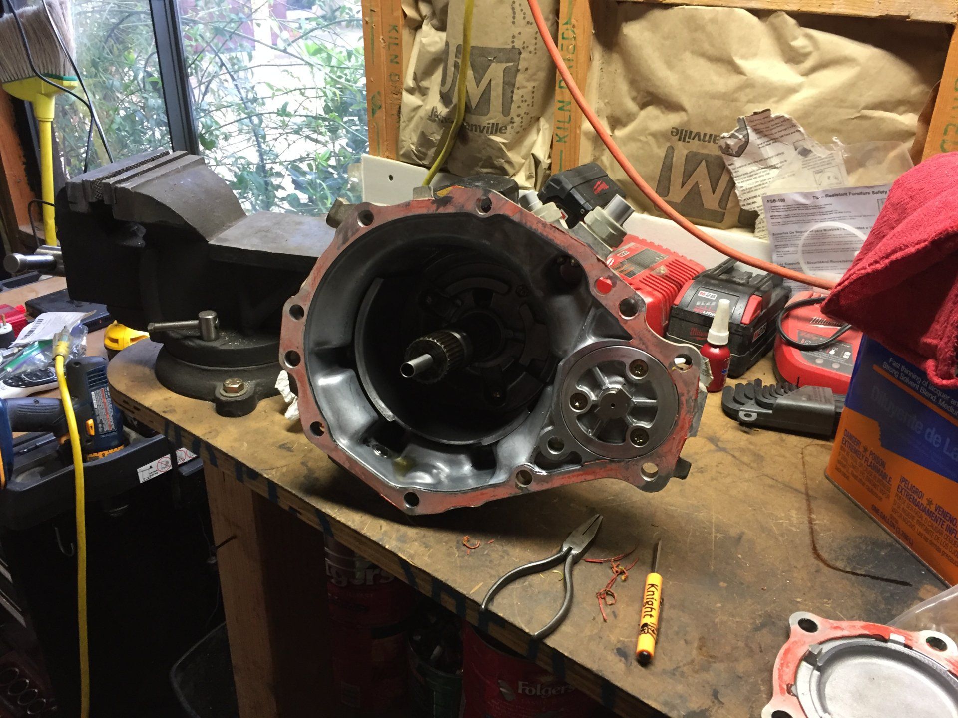

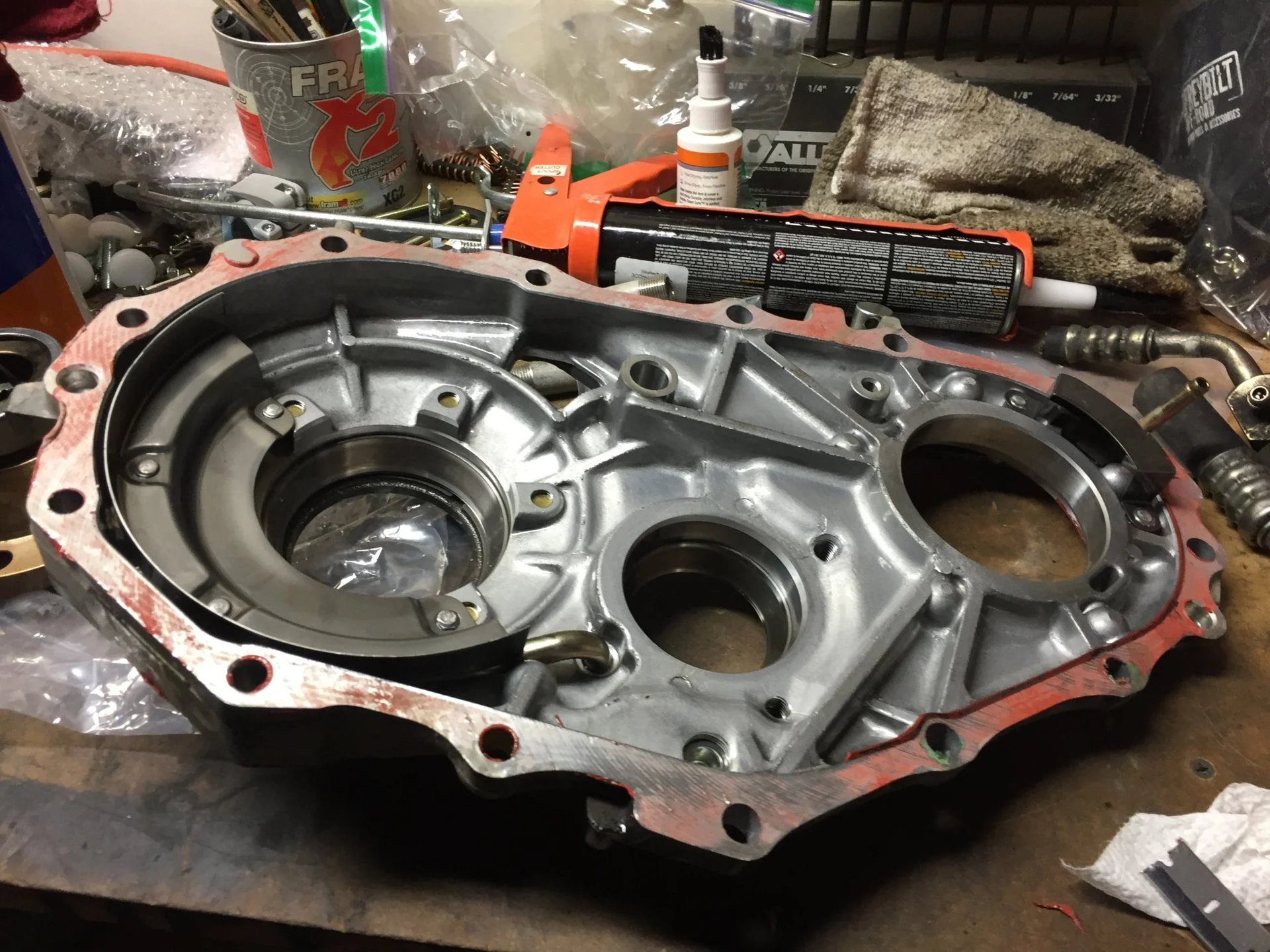

Most recently was the Marlin crawler part time transfer case install. It replaces the viscous coupler in the transfer case and allows you to have part time 4 wheel drive. I wanted to do this so there was less wear and tear on the front end.
