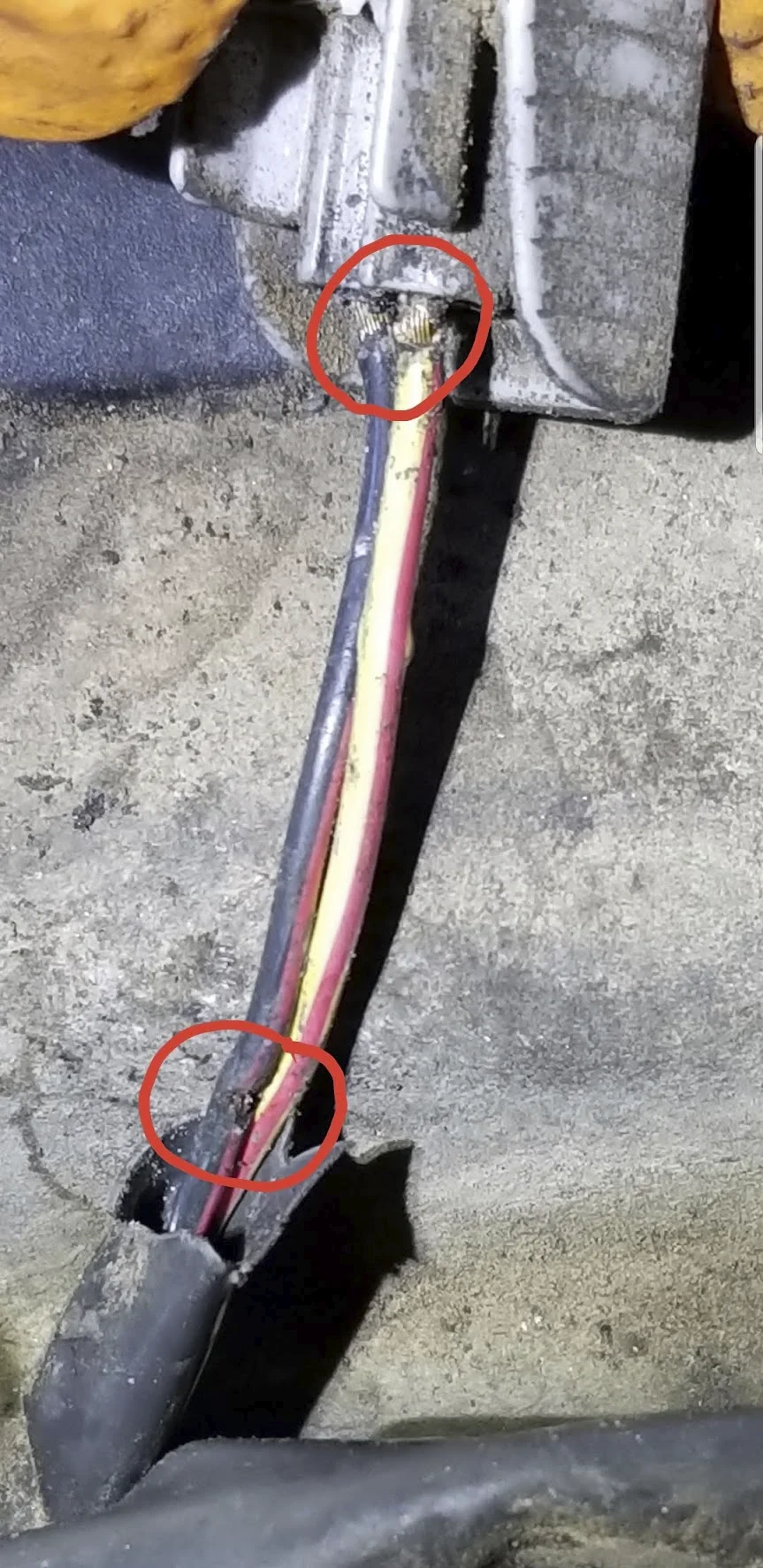

My truck shutoff when I made a right hand turn into my neighborhood. It would crank but not fire. I found that the fusible link had popped so I replaced it thinking it was age related. The second fusible link popped almost as soon as I started the truck indicating it was a short somewhere. Turns out the wire for injector #5 was shorting against the valve cover.
