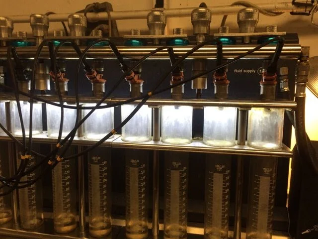

A small amount of progress today. Murf hooked me up with a guy who does injectors. I called him as I was in Phoenix today for spring training baseball. The dude came to the game and picked them up for me and had them done by the time the game was over. Talk about service!! He even let me in the shop and showed me my injectors on his machine and explained all that he had done and what all of it meant. The injectors look great and had a great report. Finally some good news.
