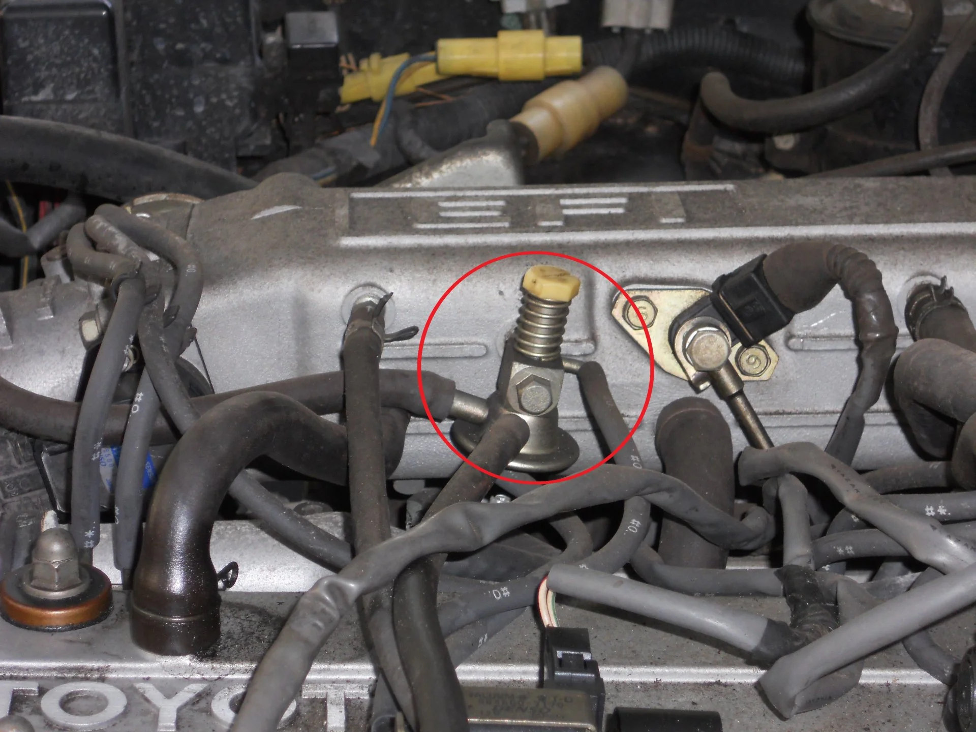

Got one of these on it?
A/C idle up valve
"Usually" it's a blown diaphragm in the idle up valve. BUT....the solenoid can also be bad. The valve is NLA new so troubleshoot to see if it's the valve or solenoid.
I got a used valve that worked from a friend. I also saw some good writeups on yotatec where some people used a later model valve from a Toyota van or something that is still available new. And there is a thread where a guy cut the crimp off the old valve, opened it up, replaced the diaphragm and used small nuts and bolts to put back together. Too much work for me.
You can always turn up your idle for now until you get it fixed.
If I can find those threads later I'll post the links.
That plastic nut on top of the valve 88repo shared can also be turned to allow more air into the plenum, increasing the idle with the AC (counter-clockwise, up). The VSV was still available awhile back. 88690-22470.

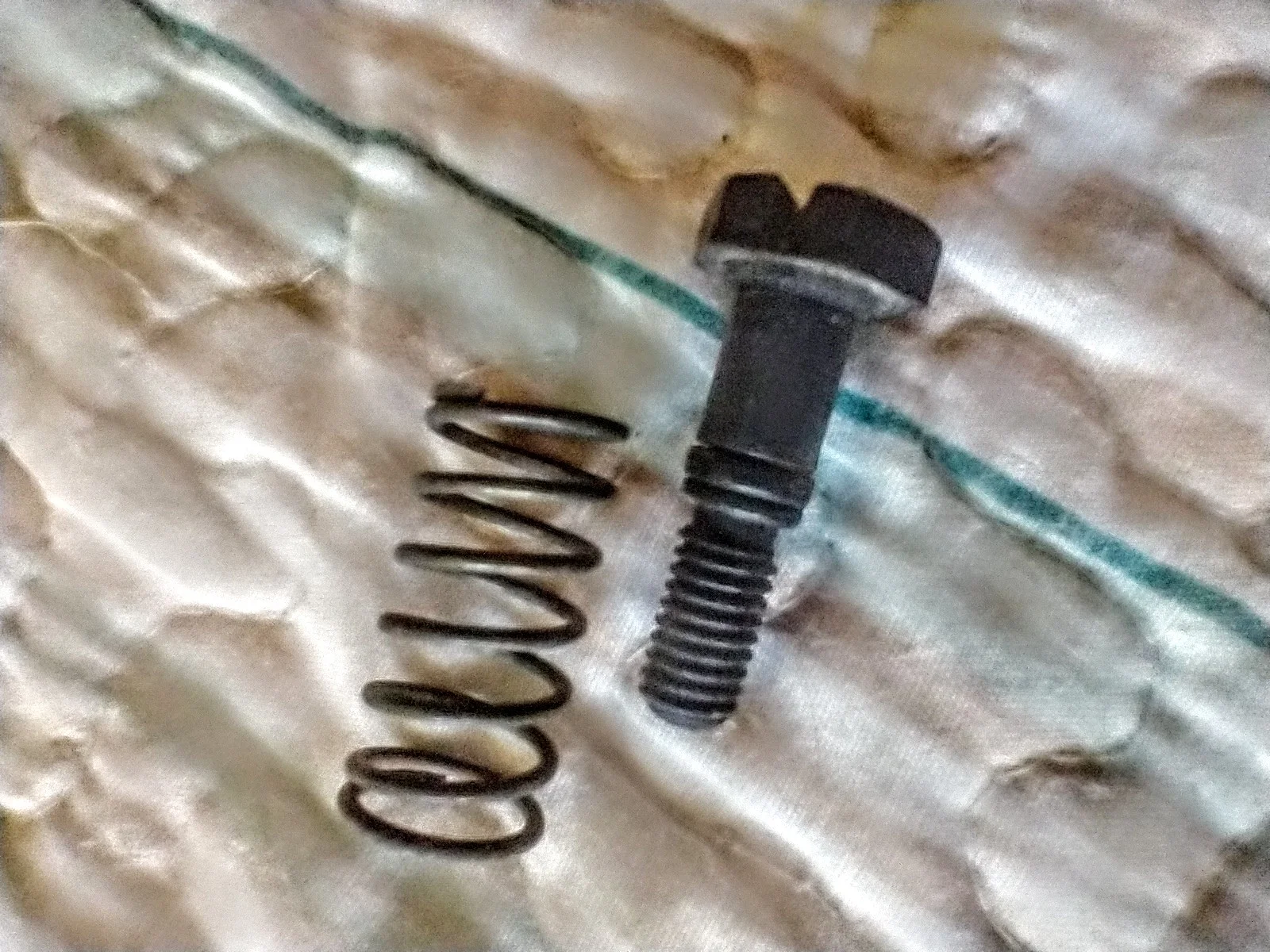

Here's the one I cut open. I checked it with a Mity -Vac and it didn't hold vacuum.
The diaphragm is dried out and cracked.
The OP can have the adjusting screw if wanted. I'm leaving for Wisconsin tomorrow so let me know soon.
