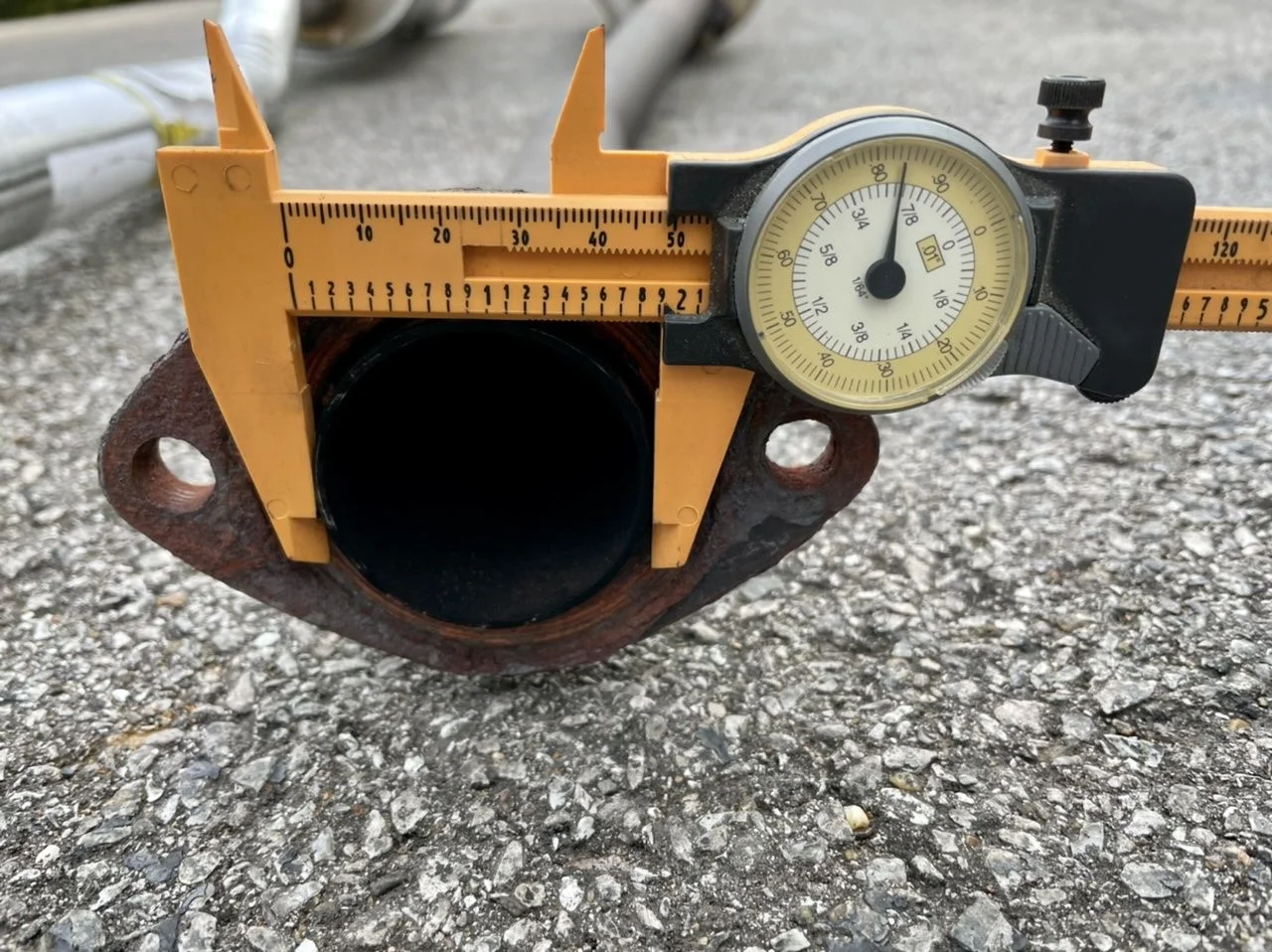

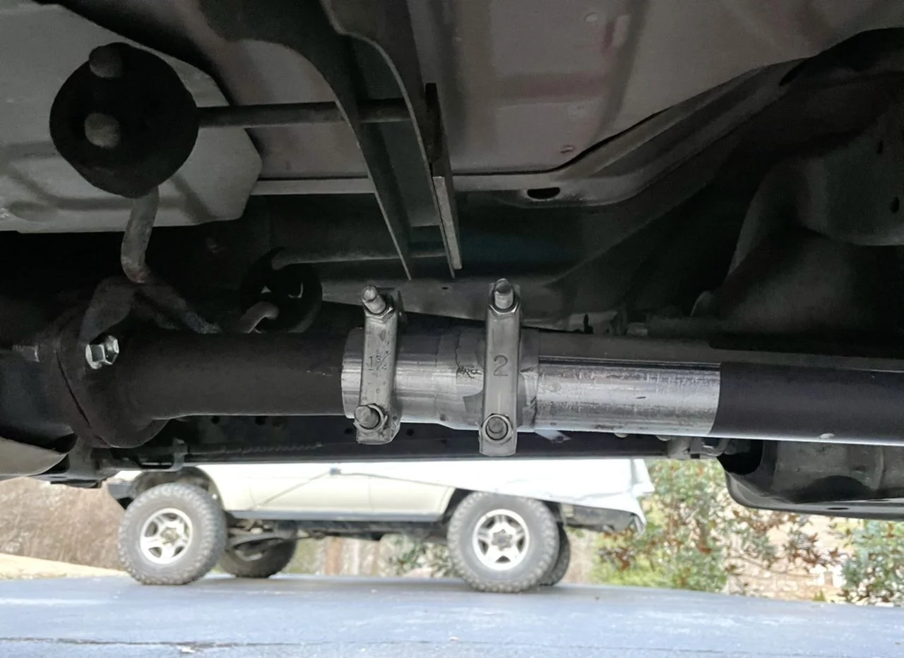

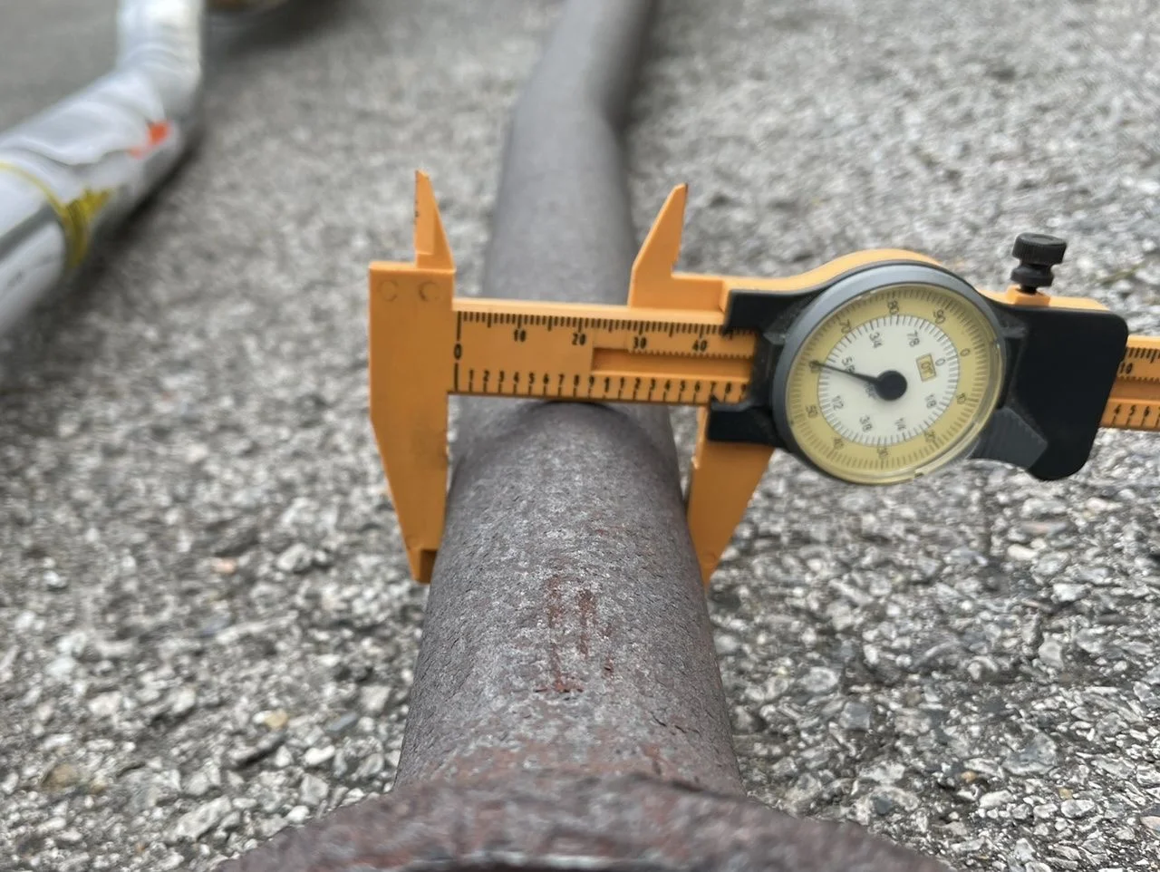

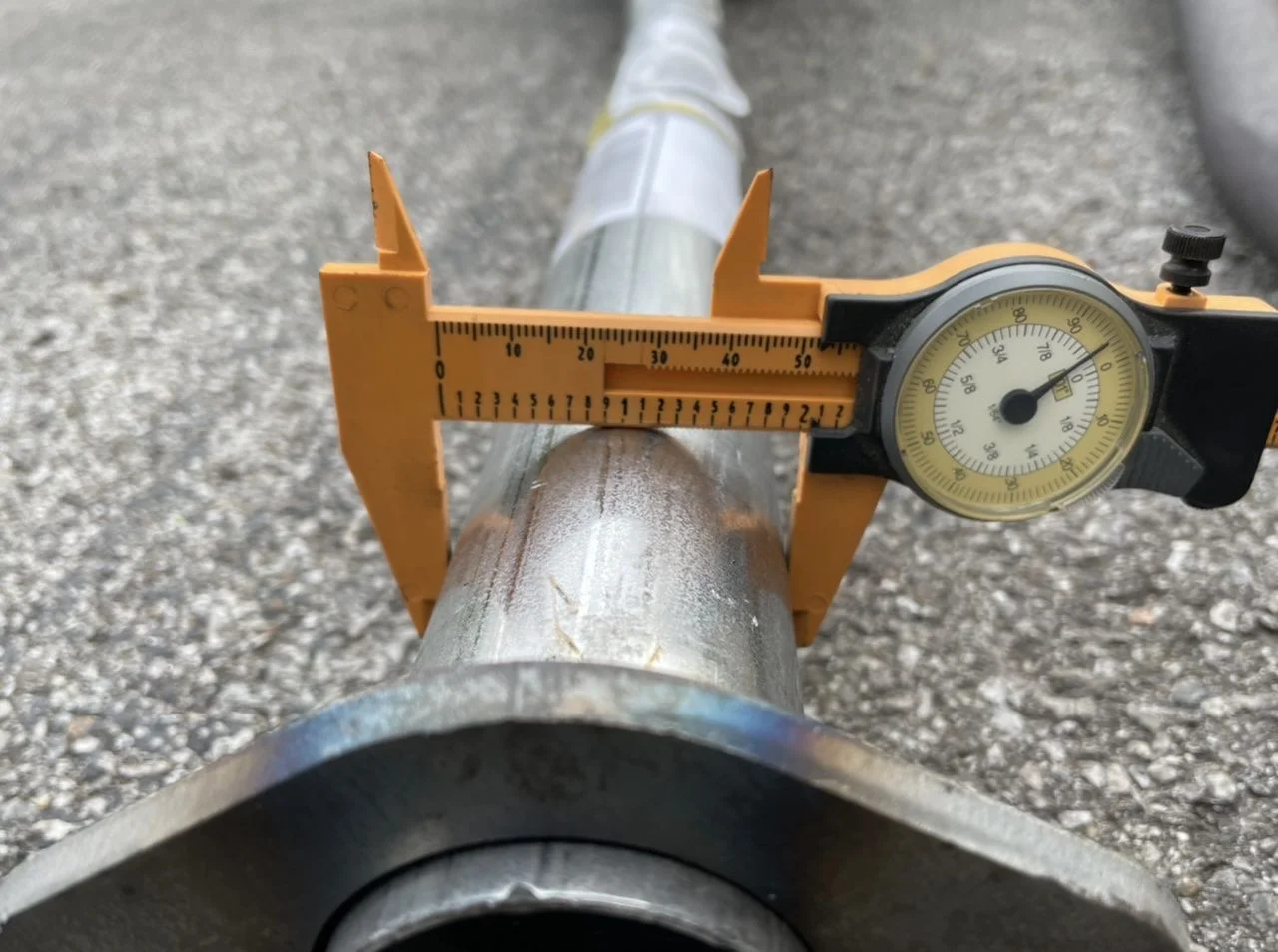

I ordered the cat-back system for a 3.0 truck and will post pics and the results here.
This replacement exhaust is Walker 47716 for use on a pickup w 3.0, 4wd, and extended cab. The main difference from the 22RE seems to be that this muffler is larger and the pipe size is 2” vs the 1.75” on the 22RE.

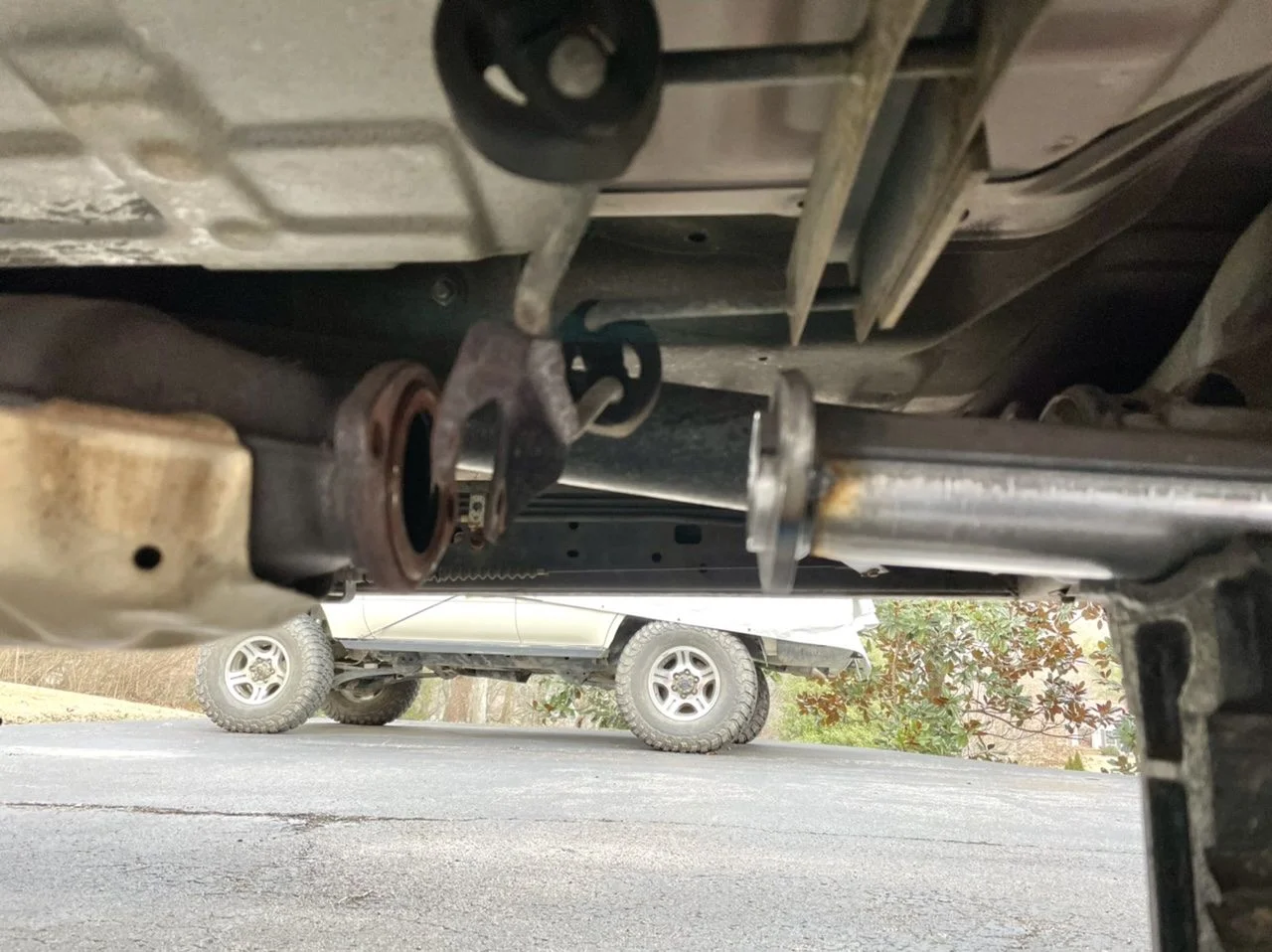

Walker 47716 for 3.0 pickup, extended cab, 4wd. Compared to stock pipes (PO muffler replacement) from 22RE, extended cab, 4wd.
Note that Walker has same flange at cat, but has larger pipes and larger muffler. I got excited and thought it would bolt up, but it’s about 6” too short.
I think the issue you had is the difference in catalytic converter lengths. The 22re will have a 12.5" catalytic converter whereas the 3vze will have a 17.5"
