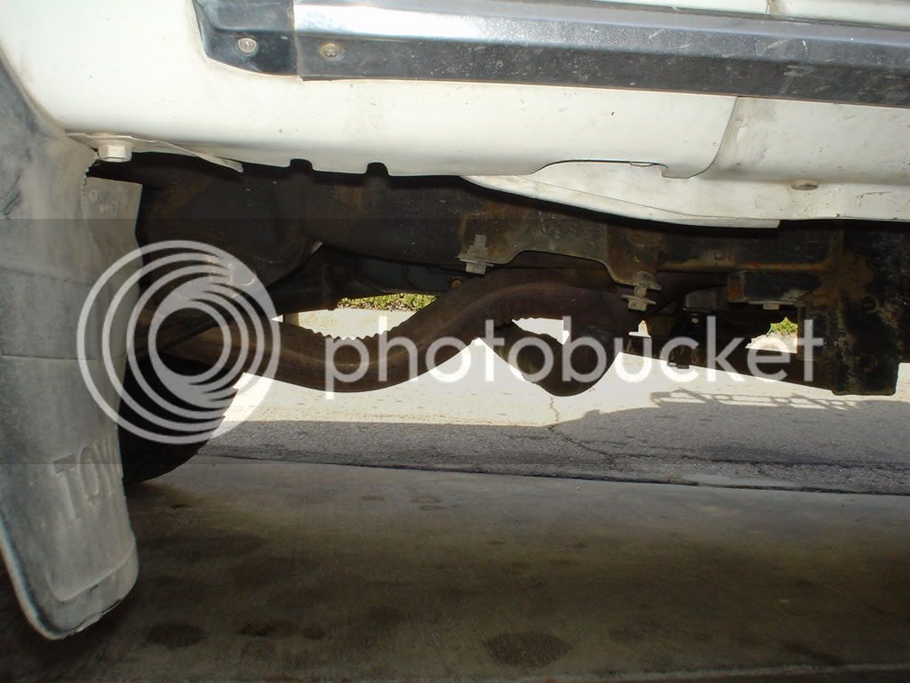

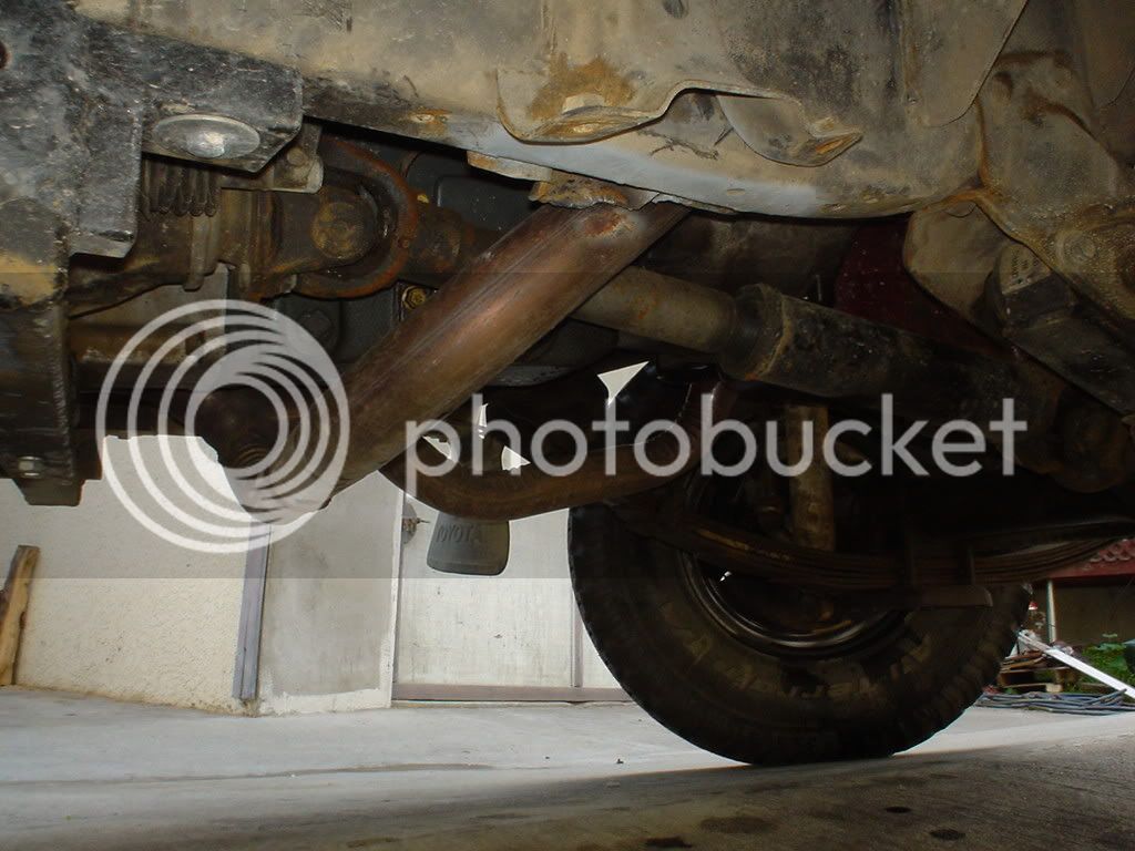

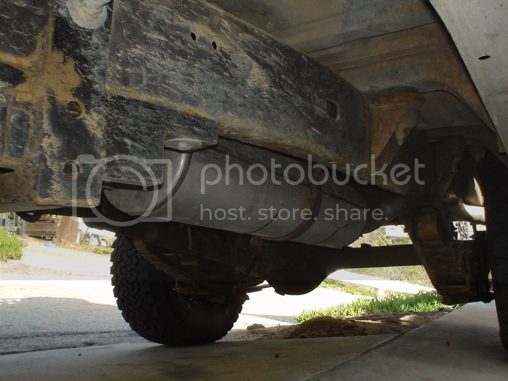

Man..... they are lagging. Here's some pics of mine, I think my exhaust guy did it in about three hours but I had brand
new down pipes from my dads old suburban that he modified for my cruiser.
Sorry, I thought I had some better photo's but this is all I have for right now.
I should have gotten more of the exhaust, I think they are having trouble finding flange bolts (metric) and maybe even flanges. It is sort of typical of my luck. I talked to the guys a few weeks ago about doing it. At the time it was slow for them so they said it wasn't a problem. It made sense at the time to take it to them because I needed both exhaust and transmission work, they do both plus they are willing to fabricate things if needed, just a little slowly. Anyway, I think they are finally on it, I will stop by there in the morning and hope to pick it up tomorrow at some point so I don't have to wait until Monday! I don't think they have more than about 30 minutes work in it so far, it has just been sitting. If I was brave I would take it out town with me tomorrow night but I need to check alot of things out before I head out on a 300 mile trip. Maybe next time.
Will post my thoughts as soon as it hits the road.

Nice work. Very tidy install.
