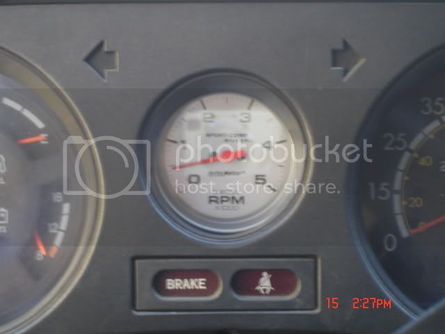

What are you using for a tachometer?

The tach I'm using is from auto meter. It fits nicely in a 60 series but I don't know what will work for your 80 unless you mount it somewhere like your dash.

That tach looks factory in the 60 dash, I don't think there is a spot for mine like that. I am going to play with getting the factory tach to work. I will probably stick with the V-belt set-up I have, just wish the guy would hurry and get my brackets to me.

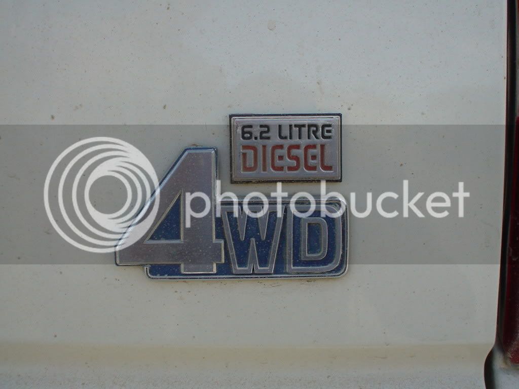

By the way, I got the same 6.2 Diesel badges for my fenders too.
