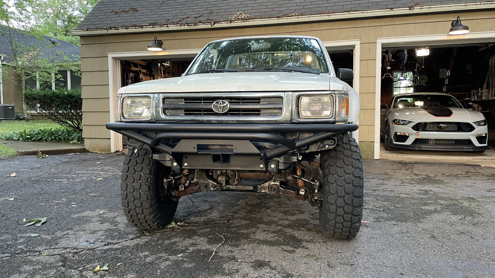

-I have added a trail gear front bumper and need to figure out turn signals... I don't care for what trail gear has to offer as far as lights that strap onto the tubing... Has anyone gotten their outer front marker lights to work as turn signals???

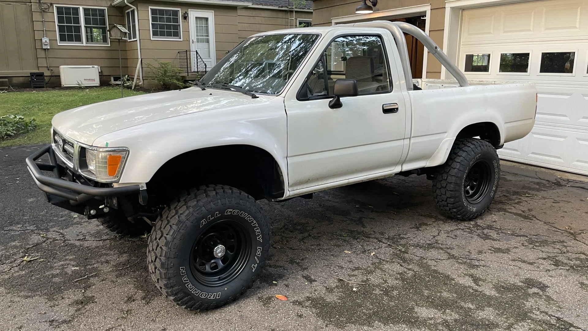

Ive started fitting my fibreglass front fenders from Toyota Fibreglass. I'm considering cutting the front triangular brace for the orig bumper and valance. Im just worried about weakening that attachment point.

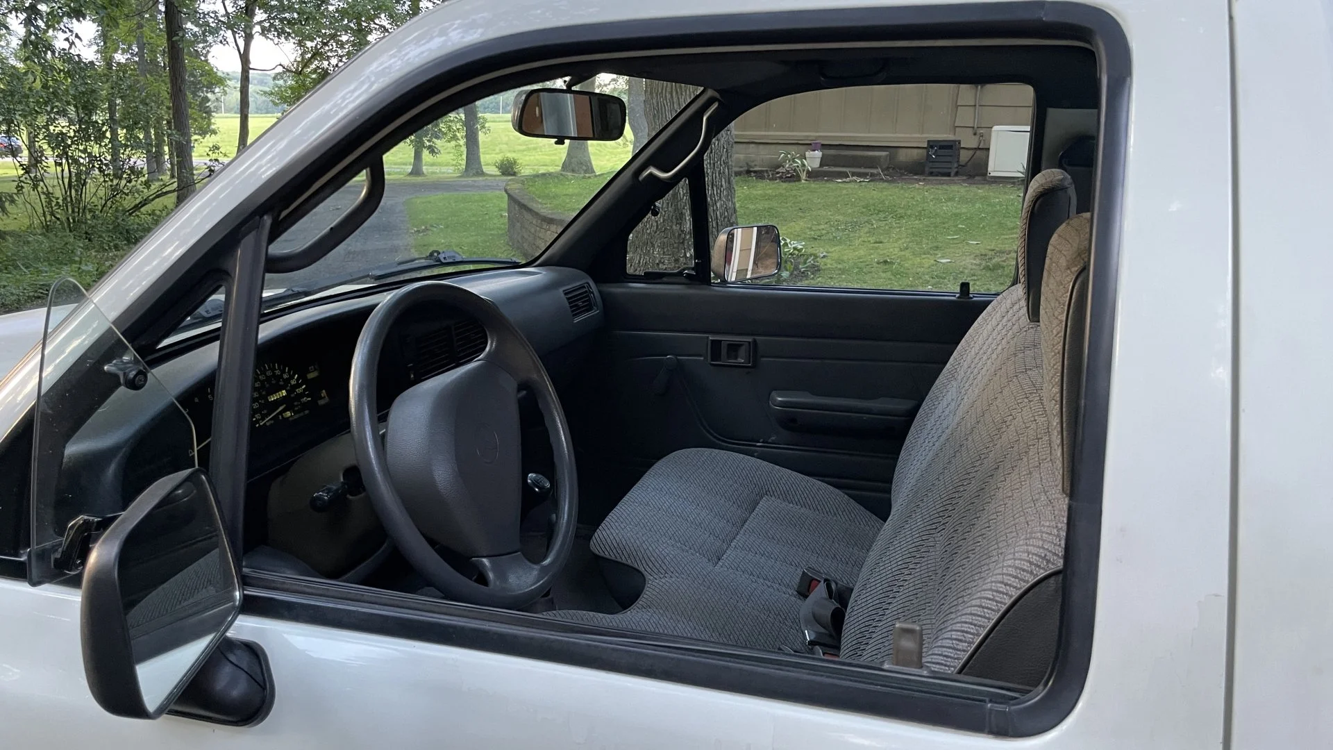

Here are some pics of my recent progress.
