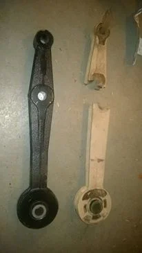

Look under your truck from the front corner. You will see a diff support on both sides of the front diff.
If it is cracked, it is obvious.
Example of mine :)
