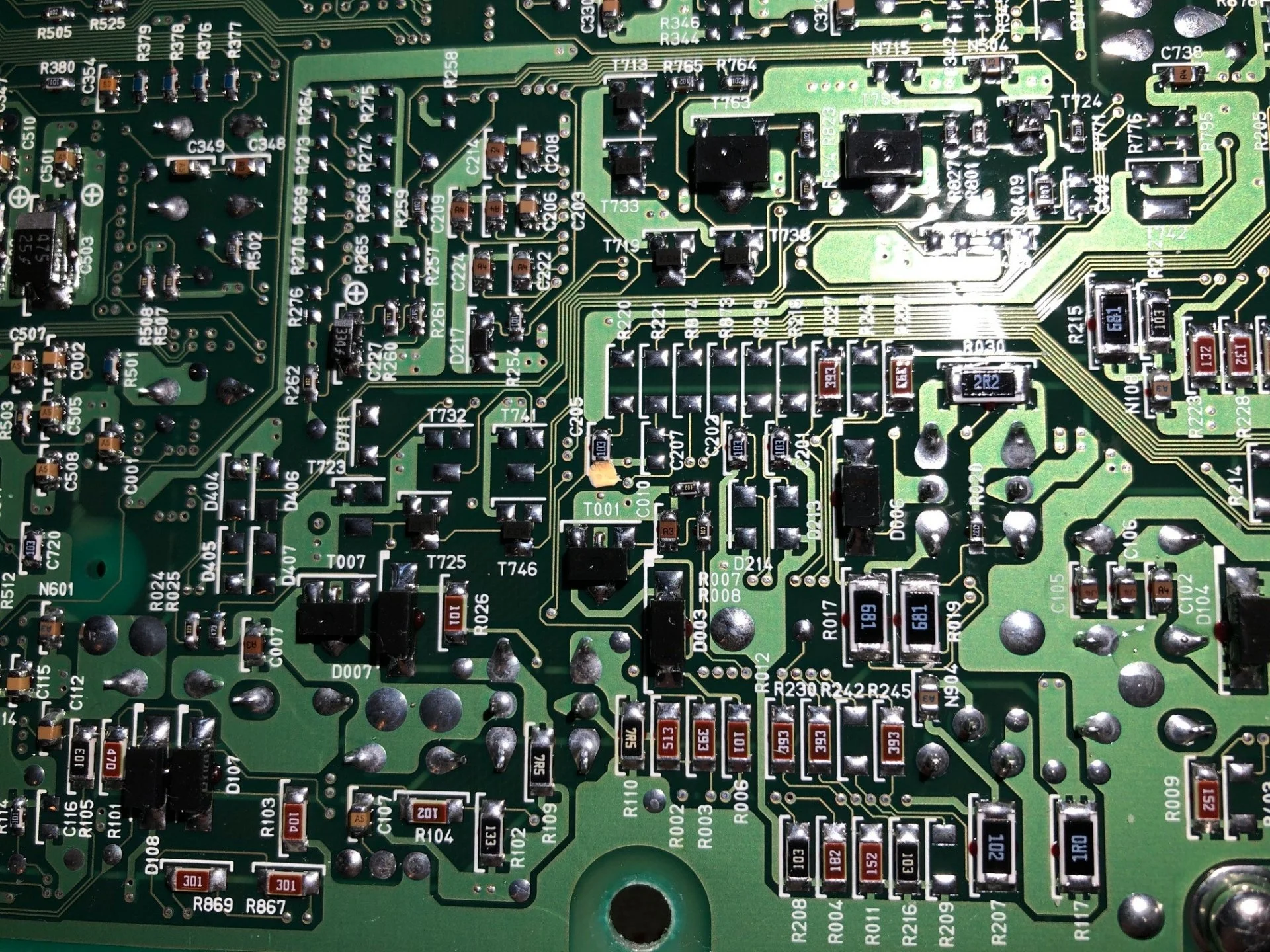

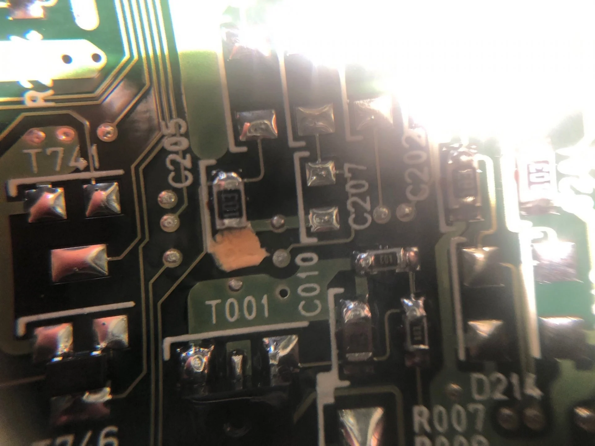

When i compared the two ECU i found a small Yellow part. i don't know what it is. is 1mm times 1mm in size. It is one the ECU that is in the car,
Any clue What it could be?
Nothing on the other ECU have with has the dam Immobilizer.
Victor

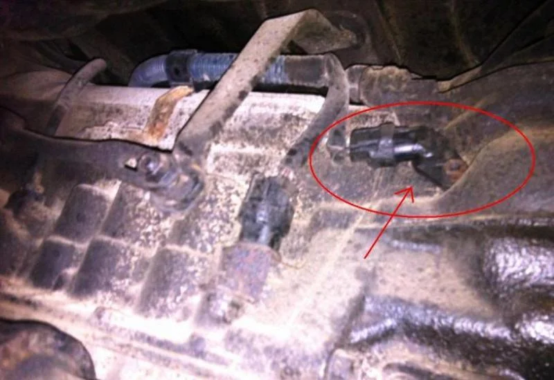

Hi Gents
Yesterday i made some progress. I hade some suspicions that the forward speed sensor was bad, I disconnected the forward sensor. The TCU will then use the rear speed sensor instead.
Now the car shift superb. Only problem is OD is flashing and i need to drive over 40Km/h once to get the TCU use the rear speed sensor.
I am going to order a new sensor ( looks like a hall sensor) and mount in the gear box
going back to previous question with the immobilizer i would expect that to be a separate ecu, its usually hidden back behind the dash in a very inaccessable location for security reasons. i dont think that the yellow mark is anything, it looks like its just a paint pen mark that may have been used when the ecu was assembled.
