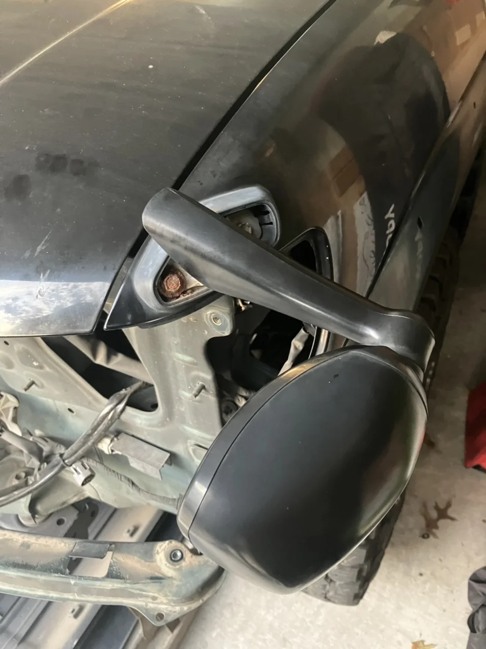

Removing the jdm fender mirror. You lift out slightly and then it rotates counter clockwise to reveal the fasteners. This one had me buggered for a few weeks until tonight :)
