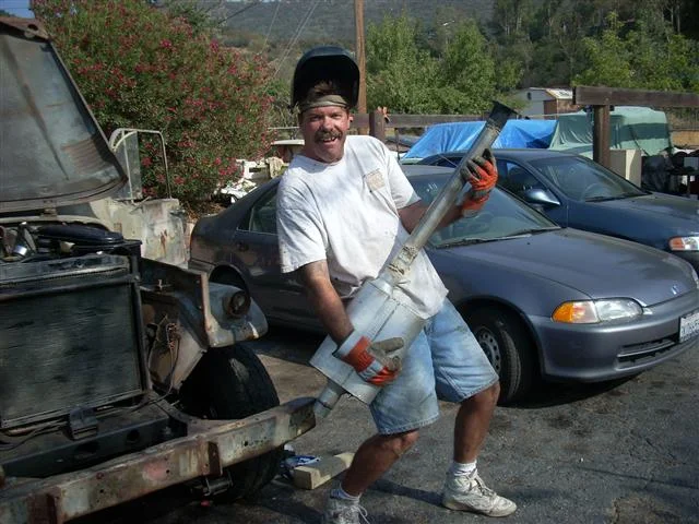

OK we had the motor runnig, working brakes, and now the wheels turned :D I nedded to get a rear driveshaft together and exaust. Again Dan was there with the old exaust off his 45 build we met in Redlands Ca for somemore mud shipping.
Exaust in hand William and I got ready for a day of cutting and welding to made the exaust I got from Dan fit the LV :wrench: We had alot of fun that day :grinpimp: I really am lucky to have a kid that doesnt mind getting dirty , Can you say ' Rock Star :cheers:
Ha ha...I was thinking more like ZZTop...
Rob, quite playing, and get back to the telling of this long and enchanted story...hope it has a good ending ;)
