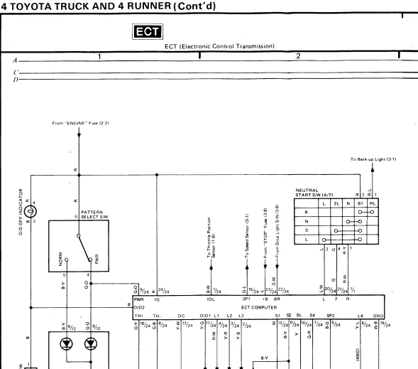

My ‘Runner has decided to suddenly not want to crank. I’m 90% sure after some time with the trusty voltage tester that it’s likely the n/p switch. Does anyone have a FSM or link to wiring diagram so I can jump those wires to test?

all I could find and I think it's for a 4cyl 88 4runner, may be the same trans though
Jump it at the transmission.
This is pretty simple.
Thanks guys, Gnob emailed me a bunch of diagrams. I’ve jumped the switch wires but still no crank. I can’t actually find the switch at the transmission. It should be right above the shift lever on the p-side, but it’s not there that I can see. I’m semi-baffled.
